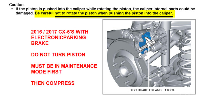

Ive added the pdfs for changing the pads. It is fairly straight forward but be careful not to turn the piston while pushing it back into the calliper.
wait, I don't understand, I thought the rear pistons have to be turned clockwise with the Lisle #28600 tool to retract it ?
and it's important for the grooves the end up lined up per Anchorman's PDF's ..... am I missing something ? why does the instructions say not to turn the rear piston if that's the only way to retract it ?

see my post #11 above of this thread, dealer is right, there is a maintenance mode for rear electronic parking brakes for 2016/2017, the pistons don't retract by spinning them like previous years they are compressed back BUT have to be in maintenance mode.
Apparently you can manually retract the gear in the back of the caliper without any computer. You need to take the motor off the back of the caliper, and turn the heat all the way clockwise with a tire bit then depress the piston as you would normally like on the front. Then you need to line up the grooves by turning the piston after you have already depressed the piston
guys, I just tried this and it does work, thanks Anchorman, this helped a lot. I know, the instructions are a bit scary to press down the accelerator pedal fully, DO NOT START YOUR ENGINE. all this is done with the engine off. do not press brake pedal and start button.
note: for ignition ON (engine off), for the CX-5, you have to press the start button TWICE, pressing once only gives you ACC power
also, I don't have the tech package so the info LCD didn't say "maintenance mode"
BUT the parking brake with exclamation point dash light did light up.
I'll post a video later to show you guys, this pertains to 2016 and 2017 CX-5's only..
it's pretty cool, once maintenance mode is activated, you can here the motor retract a very long time,
and vice versa when deactivated, you can hear the motor push out until the piston touch the brake pads.
for those with EPB,
DO NOT TURN OR TRY TO COMPRESS THE PISTONS WITHOUT GOING INTO MAINTENANCE MODE,
you will damage the EPB motor.
The purpose of the maintenance mode is to back off the EPB motor so you can compress the pistons easily (DO NOT TURN THE PISTON)
I can see how it is tempting for someone who doesn't know about these EPB to use the Lisle 28600 tool to try and turn them back in BUT IT WILL NOT WORK, the motor will not allow it, forcing it with a C-clamp will break the EPB motor. The motor must be backed off first with the procedure below.
I believe the dealer can use a scan tool computer to have the car enter EPB maintenace mode, but at least Mazda gave us an option for those who don't like going to the dealership with this procedure below. Without this procedure we would be at the mercy of the dealer to get the EPB motor to retract if we wanted to replace rear brake pads.

for those with EPB,
