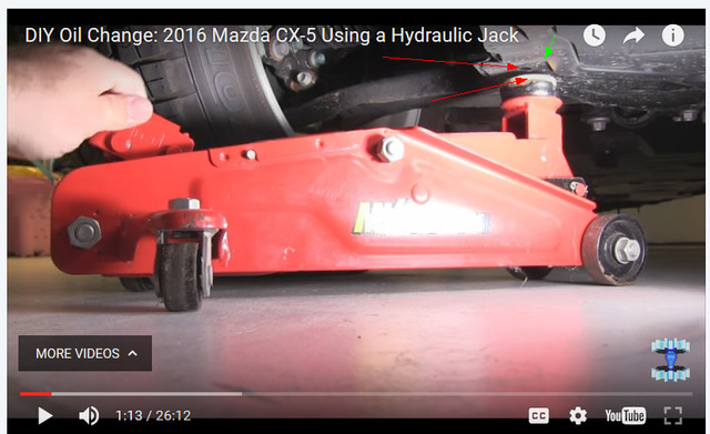

that looks a good spot for the floor jack, that's probably the same location dealers use for their lifts,
see video.....the floor jack is jack right under the same bolt that you are referring to.... around :16 to :18 seconds mark

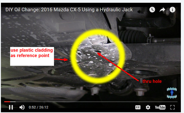

yeah, I agree, but you can still kinda see where he's putting the jack ,
just look for that thru hole in the metal , he centers the jack pad dead center of the thru hole,
use the plastic cladding odd shape cutouts as reference points to help guide you ....
there's a odd looking corner cut in the plastic cladding (green arrow) and a punch thru hole as an indicator,
almost as if Mazda is saying "put the jack pad right there" LOL

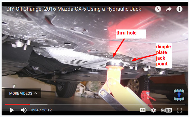

yeah, also per CX-5 service manual, there's a dimple plate in the front between the two wheels that is to be used as a jack point also,
in the video, he used it as a back-up to the jack stands just in case for safety in case jack stands fail,
you can also see a thru hole in the dimple plate,
he lines up his jack pad with the thru hole also.....
