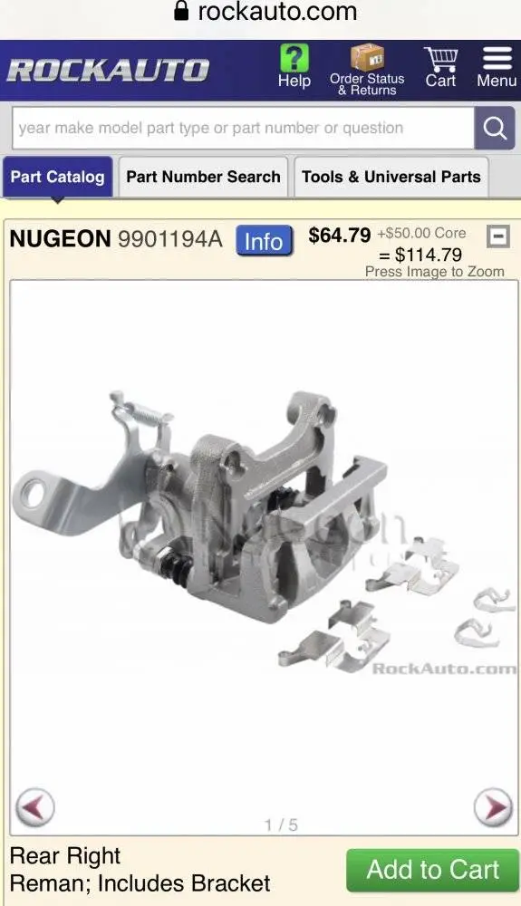

I wonder how aftermarket EPB calipers compare to OEM?
As I suspected, there’s almost nothing from aftermarket rear calipers with EPB for 2016 CX-5. The only thing I could find is from RockAuto, but it’s remanufactured caliper, and from the picture shown it doesn’t even look like the correct caliper with EPB.
I wouldn’t consider any remanufactured Mazda CX-5 rear calipers with EPB as they may just have new piston and seal put in to a failed OEM caliper, and the root problem described in the TSB is still there.
