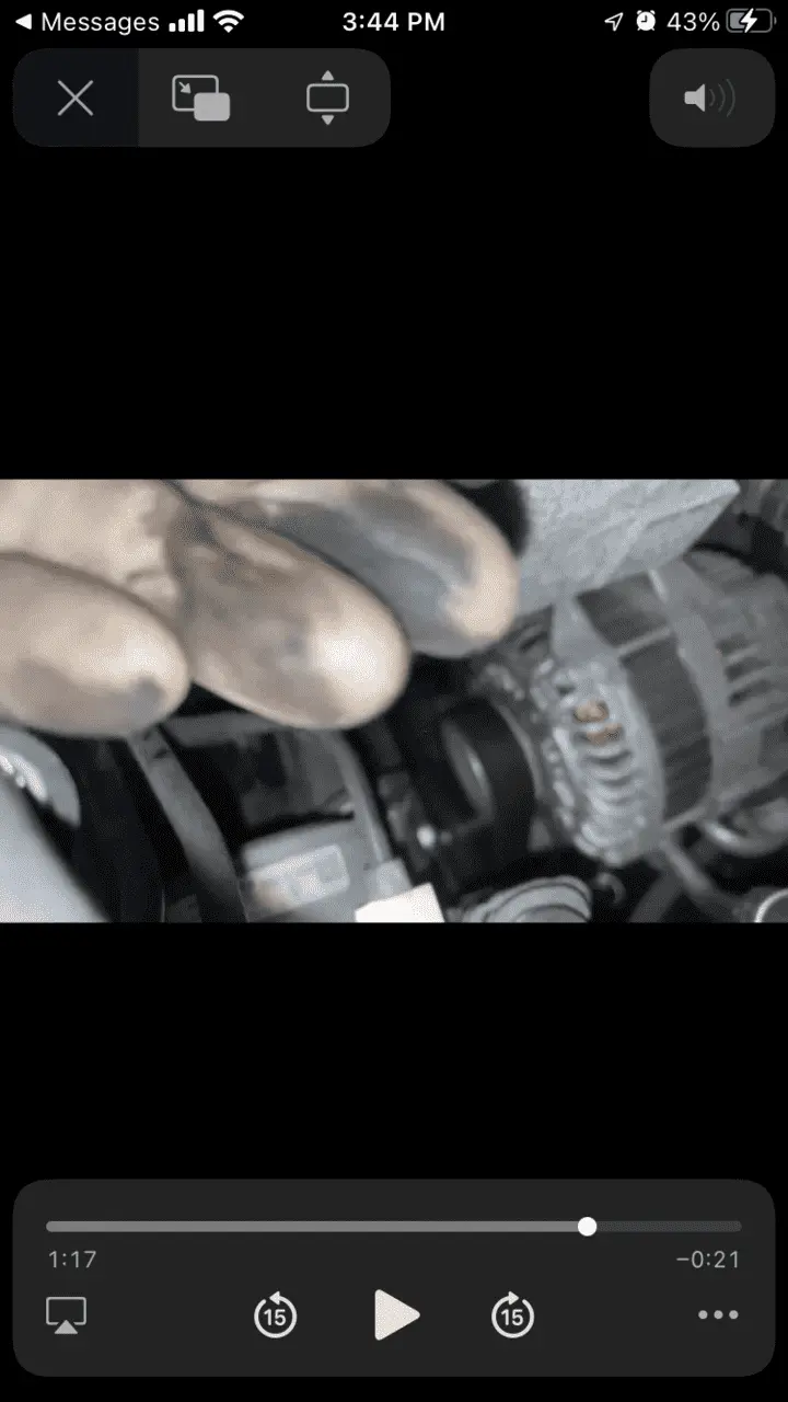

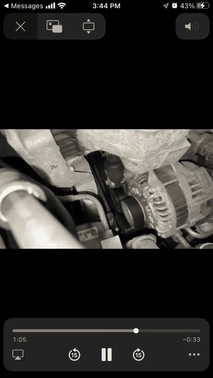

I appreciate the feedback. Haven’t noticed any unusual noises/problems. Attaching the photos from the service video.
Hard to tell from the photos ... Kind of grain-ee. Second photo seems to be the tech showing you his dirty glove fingers presumably as evidence?
I would buy a can of foamy engine cleaner at walmart, soak that tensioner down, scrub it all around with a toothbrush, rinse well and see what happens. I'd betchya it's not an issue.
I would also go so far as to say THAT ^^ is what your tech at the "dealership" should've done as well. Took his video/photo, made you aware of the oily dirt, suggested he clean it up and monitor it on the next oil change.
I guess I'm just an old fashioned kinda guy. The things you are experiencing are the tell-tale signs (to me) that shows in who's interest they are working for ... Their own pocketbook or giving the best advise for the customer's vehicle.
I look at the pictures and see, "yes, that's a belt". I guess its helpful if you weren't sure which belt he was talking about. But can't actually see the surface of the belt.
If your tensioner is bad, you may want to replace the belt also. A belt does not cost much. Now, the question really is, "Do you need to have the tensioner replaced?".
Maybe a close-up shot of the tensioner would help.
