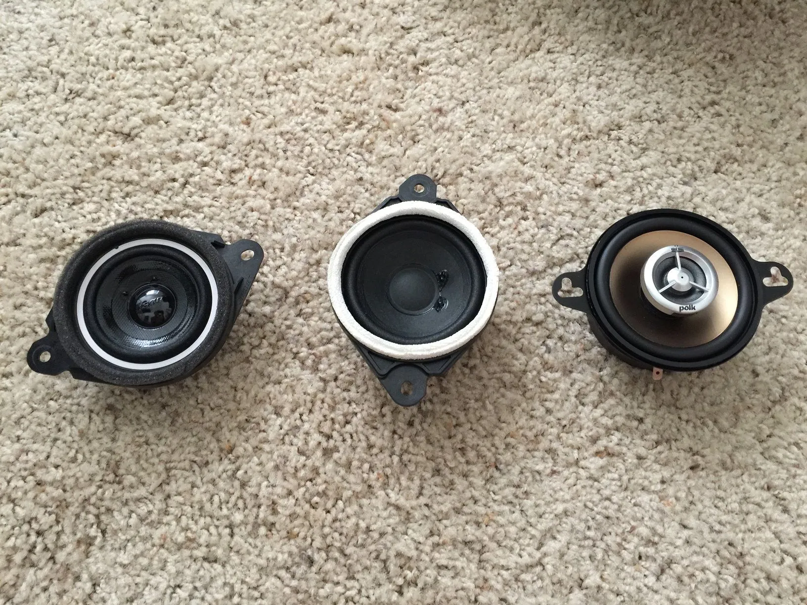

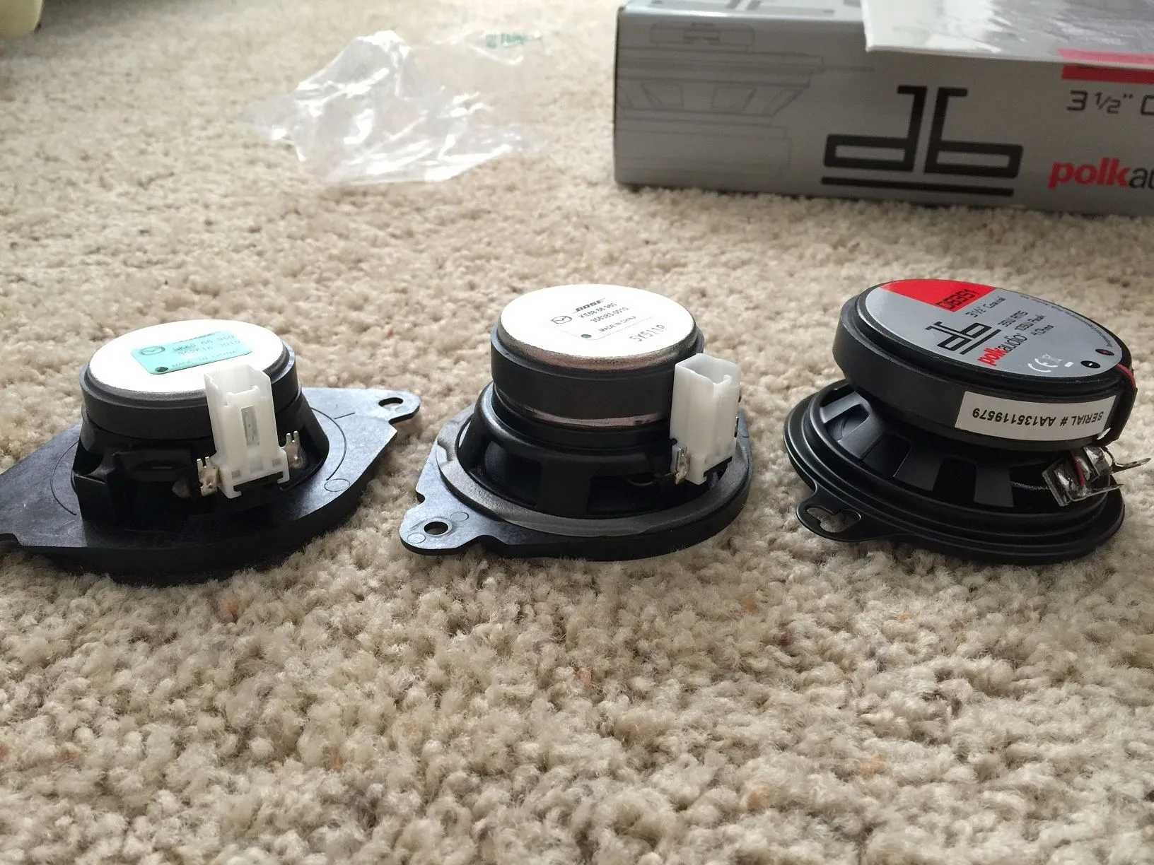

Here are some comparison pictures of the stock bose left/right dash speaker (shown left), the stock bose center dash speaker (shown middle) and the polk db351 (shown right). The polk weighs the most obviously, the center channel bose speaker weighs slightly less, and the left/right speaker weighs 1/3 of the Polk. The bose speakers have a much smaller woofer cone too, so I wouldnt say they are truly 3.5" speakers.
I know this is an old thread but a still very relevant one. I was bored and wanted to view the front corner dash speakers (BOSE). Man the plastic grill covers are easy to remove. Took me 5 seconds. So I noticed that the two screws holding the 3.5 (or whatever they are) size speakers are the only thing in the way with removing the stock ones and popping in better aftermarket ones. Wow that easy? But then there's a catch. None of my tools can access those two screws. How the heck did you guys remove them?
Oh and second question. Would you guys say its safe to assume that the width of the screw holes are in range with standard 3.5 inch speaker basket holes? The pictures ryan posted seem to say so. Would be nice if I can remove the dash speakers so I can measure the hole cutout.
