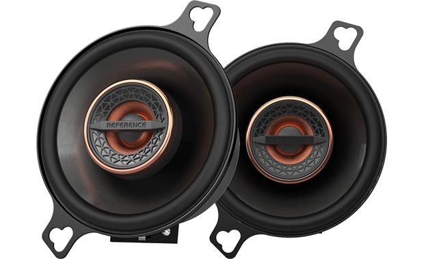

I have the same question about the Inifity 3022cfx speakers (link below). Note that they are not the older 3002cfx speakers, which have a different tweeter. The newer 3022cfx model has a textile tweeter, which has better reviews. If you click the Amazon link below, note that the image on the 3.5 in model is wrong. It shows the older 3002cfx model, which is all grey. The newer model 3022cfx is black and orange (shown below).

My vote is for the Infinity 3022cfx speakers. They sound great for how small they are, and the Polk db351 speakers discussed throughout this thread have been discontinued. Even if you can get the Polk db351 speakers, the impedance is 4 ohm so you'd get less volume out of them than the Infinity 3022cfx speakers. The Infinity also has a slightly better tweeter and a wider response range, though sound quality is likely relatively similar.
As for the center speaker, I just ordered an Infinity Kappa Perfect 300m (3.5 in) mid-range (link to Cruchfield page). I didn't get another set of the 3022cfx speakers because two tweeters in the front already provides plenty of highs (even too much with the treble up). Plus the 300m has great reviews. I'll follow up once I install and listen with one of a 300m mid-range speaker in the center dash.
Also, since I'll have an extra if I keep the 300m speakers, let me know if you want to buy it for your center. Our cars only need one. The 3.5 in speakers on the L and R dash sound great but can use a touch of mid-range, which is why I ordered these. The pair of 300m speakers was $150, so I'd sell my spare one for half to anyone who is interested. Just lemmy know, and we can work out details through PayPal or whatever is convenient. But, like I said, I'll follow up to say whether it sounds good as a center speaker replacement. :-)

Just installed. They're legit! With the Infinity 3022cfx speakers already in the left and right dash spots, the difference is subtle but good. Things became more articulated. I noticed things like the guitar pick of a bass guitar's pluck and clearer project of voices. It added just what I was looking for.
I was initially concerned about running a mid-range component without a crossover, but whatever the Bose system does seems to do nicely. I had tested the speakers on a full range signal before installing, and it was a little tinny, but they sound much better once plugged into the center dash. Whatever the Bose amp has by default does a good job.
Just to note, my fade before the installation of this Infinity Kappa Perfect 300m was a couple clicks to the rear speakers, but it now sounds better with less back fade. I'm still deciding whether just one click back or even (i.e. no fade) sounds better. Definitely worth it to me - recommended.
Pro-Tip: The grey wire is positive (+) for the center speaker.
