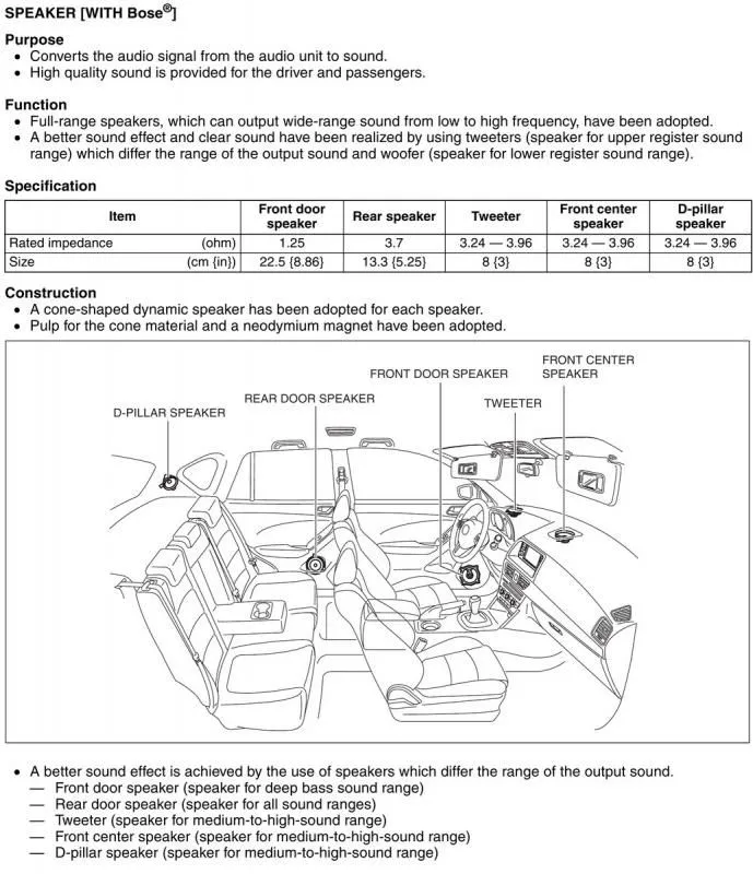

Since the Bose system is rated at around 1.25 ohms for the front door speakers, I'd be concerned that any 4 ohm speaker (which both of those options appear to be) would not have adequate volume/ooomph unless an amp designed to drive 4 ohm speakers was added. You also likely have to consider the power rating for any replacement speaker--most midbass and woofers are designed for use with an amplifier that is more powerful than what the Bose amp is probably sending to the front speakers. I've never run across the individual watts being sent to each of the Bose speakers from the amp, but I seem to recall that the total amp rating is "only" around 225 watts or something like that.
Finally, based on what others have noted, I think that one might be able to fit an 8" replacement, but I suspect 10" is too large.

FYI for ease of reference
I may be able to live with a 4 ohm (2 ohm even better yet) speakers in the front doors depending on how much volume is lost. That said I've altered (not physically) the sound of my BOSE system by first changing my settings to fade 3 clicks to the rear, disable any center point crap, set treble to + 3 clicks, and set bass to + max clicks. My audio sources are 1. via a Samsung Galaxy s2 through bluetooth with some an app EQ intended for a flat EQ with slight emphasis for bass. It made the car's sound surprisingly better to my ears. 2. CDs it sounds less muddy to my ears with better bass response.

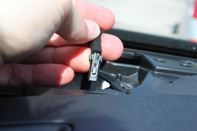

... All pre wired. The middle looked the same.
Colors appear to be a reddish-orange and green. Maybe a stripe on both???? I didn't want to get crazy with stripping anything out.

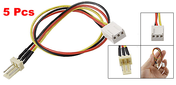

I was looking at the front 3.5" dashboard speaker connectors and brainstorming what I already had to use without building a custom cable.
Guess what, these little motherboard 3 pin fan extension connectors work perfectly!
Their about $1-$2 a piece on ebay, one seller has (5) for $3.67 shipped.
Two of the three pins fit right into the speaker connector while still attached to the white bracket, the spacing between the pins is right with the last pin sits outside the speaker connector. All together, its a snug / secure fit and you just need to crimp some blade connectors on the other side of the cable and your done.
Dash Speaker Wiring Adapter: http://www.memoryexpress.com/Products/MX5934 I only used the connector and not the wires that comes with this part as I was not keen on using 26AWG wiring inline with the dash speakers. In theory it should be fine as they are 25W at 4omh speakers but it does put you pretty close to the limit on that cable for current so I soldered leads onto the connector...
Close up of the wiring adapter that was soldered onto the other end with the 26AWG wiring removed

I guess I got confused here. hollis and Anathema used computer fan connector as the non-Bose front dash wiring adapter without any problems, but you said it doesn't fit yours. Can you look at the pictures of Mazda non-Bose dash speaker connector provided by cmceleste and see if it's the same as yours with different color? Thanks!

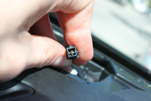

To be 100% sure I'd like to see a picture of the female connector that is on the speaker. In any case why would anyone use an adaptor when the female connector can be transferred to the new speaker. You have the Bose unit, correct?
Yes, I have Bose. I hate soldering and would like to keep stock speakers intact for later putting it back. Here are some pictures provided by Anathema from the other thread for his non-Boise dash speakers which can be fitted fan connector as dash speaker wiring adapter:
The black receptacle connector on non-Bose dash speaker showing on the pics does look different from the white receptacle connector on your Bose dash speaker, doesn't it?
I also used the startech fan power connector with no issues upgrading a 6 speaker GS 2014. Put in infinity reference 3.5 in the dash using the power cord and 6 inch infinity reference in the doors.
