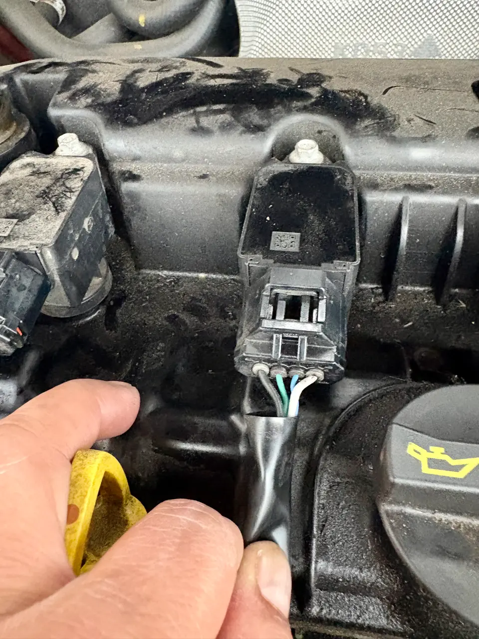

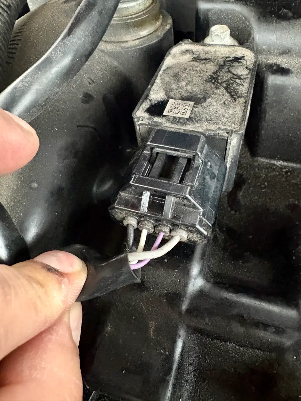

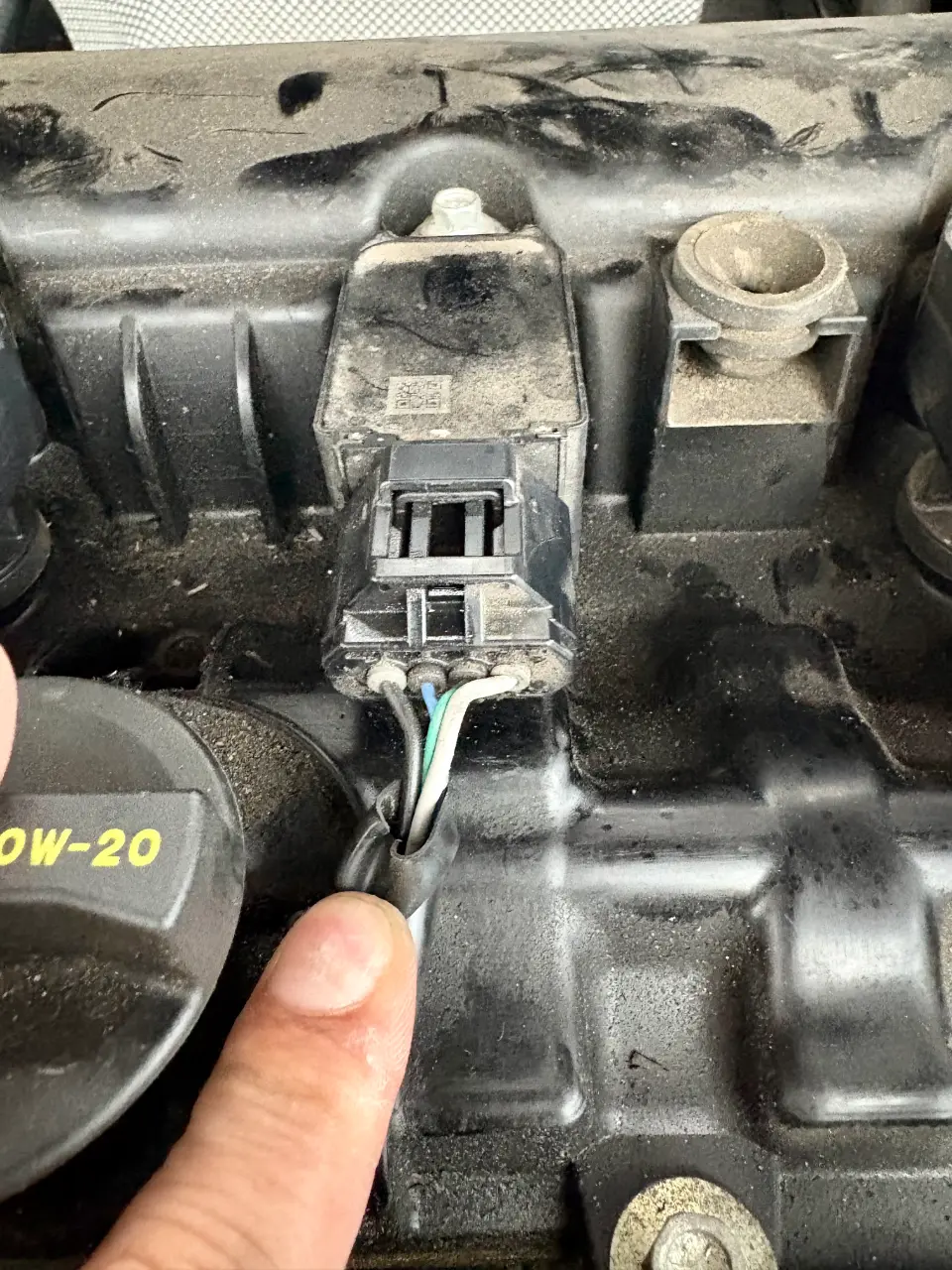

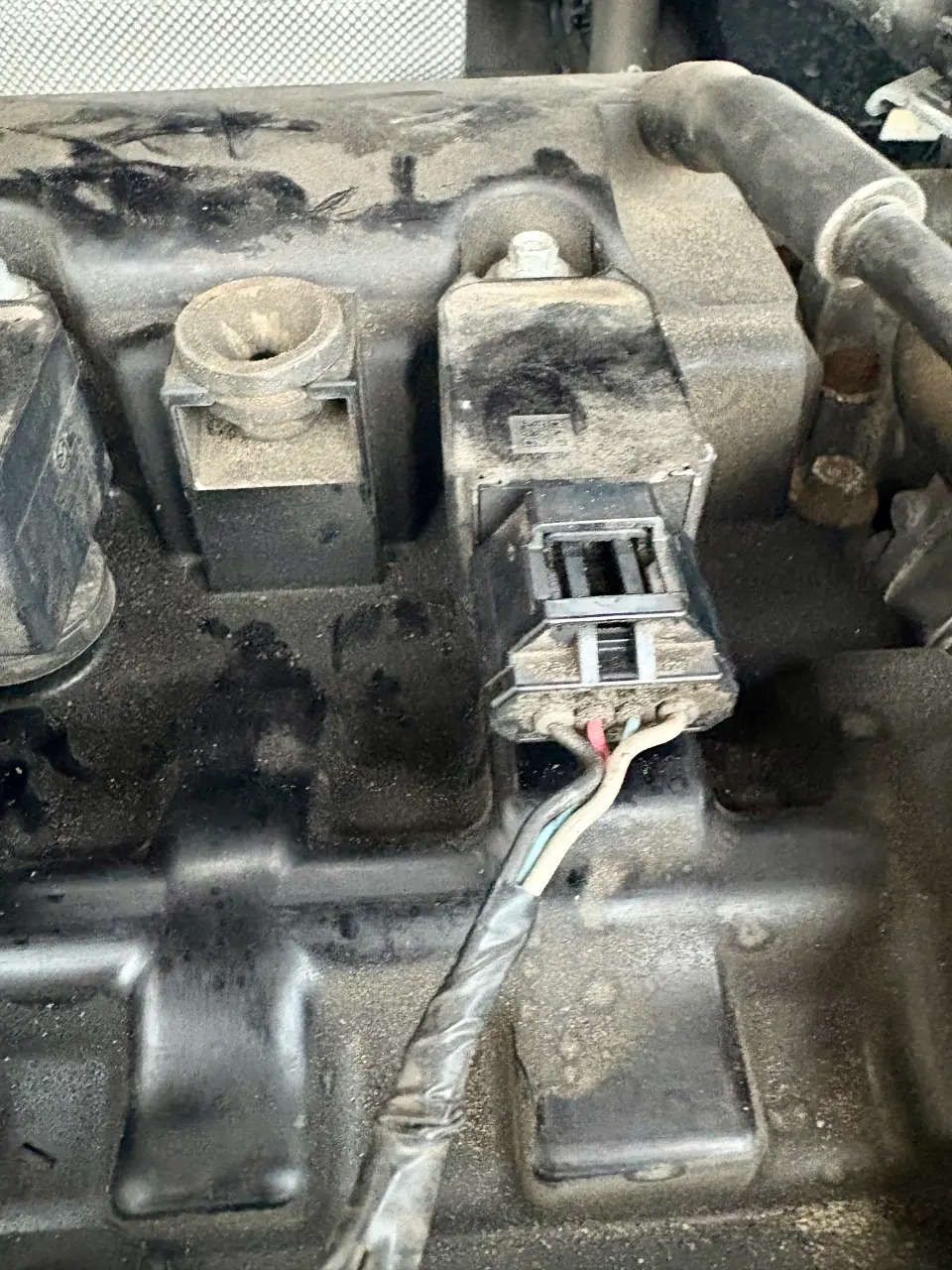

At 70,000 miles and for few weeks observed a bit of sluggishness when accelerating. Normal culprits like engine oil, air filter, MAF sensor - cleaned/change/reviewed/sprayed.
Local dealership told anyways due for S/plug replacement at 75k so I decided to do it myself. Pretty easy and changed all 4 with their premium (not value) line.

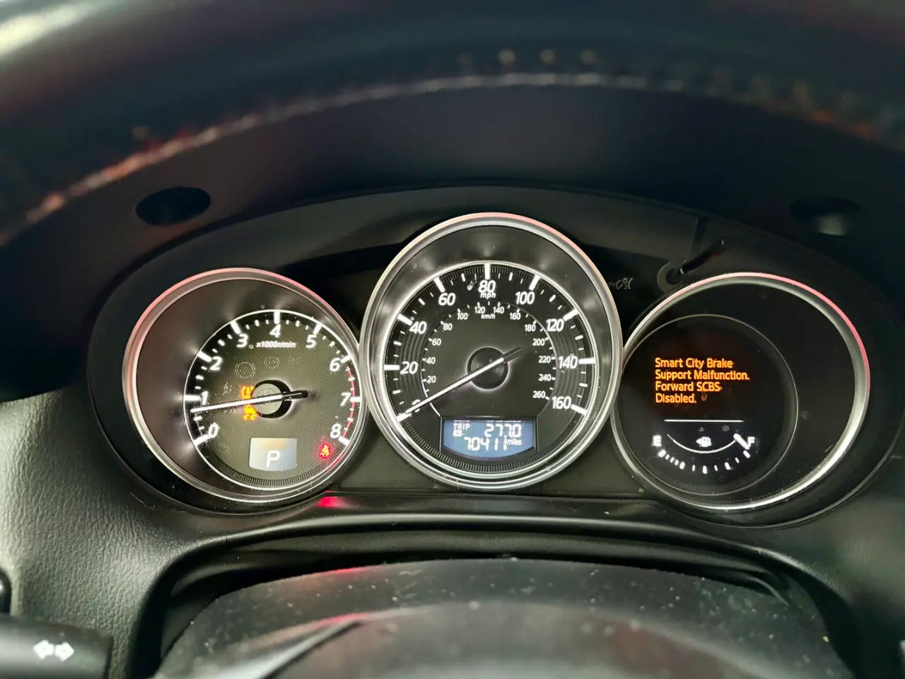

Started car. After going 500 to 800 ft suddenly car started to shudder a bit. Then when I am attempting to accelerate - jerked violently. Very soon engine light came on, the traction not working came on, tire pressure light came on and weird messages appeared like smart city/forward collision errors - disabled. Very soon car barely could be accelerated or driven. In any smallest uphill it literally started to struggle.
Fearing something worse, I stopped in a safe location. Thankfully in car had the wrenches, etc. and after it cooled down re-opened and checked. Everything looks correct. No fuel/oil in the plugs, etc.
I attempted to start - and again for first 500 - 800 ft all okay and then the same stuff as above happened. At this point in time not taking risks I had already turned and was coming back home.
I stopped, waited for 20 min, and then drove - same behavior. Initially just the engine line came on but very soon the shuddering and all the warning lights/messages came on.
I am unable to figure this out. The only discernible change is replacing the spark plugs. I took them out twice and put them back in. My local trusted mechanic I called - he said it could be ignition coil or programming got haywire for some reason. Without attaching OBD sensor he can't assist. He asked me to bring the car in. I am really worried and he suggested I tow it rather than drive it in.
Solution
[FINAL UPDATE] Got NDK ones at $21 a pop and flipped the 2 old factory ones with these. Same part # and gap 0.44. Now finally working fine. Drove +10 miles.

Traction control, TPMS, SCBS are all from the ABS system.
How's your battery status? Do you have a charger you can put a good charge on it? Did you have any battery terminals off? Tightness of the connections? What's your voltage car off and car on?
I don't think it's your new spark plugs but if you run out of things to check, could you put the old ones back in to rule that out?

Where did you buy the spark plugs and what brand?
Check the gap on the plugs.
Check the porcelain to see if it's cracked. I cracked the porcelain on a plug before I bought a spark plug socket for these tiny plugs.
I would pull the codes and put the old plugs back in it and see if works to rule out a bad set of plugs.
If it's a coil pack, it will run ruff because one cylinder will not be firing.
Look over all the wiring and see any sensors are loose. Not likely but worth a 5 minute check.

MedCenter Mazda. They are the OEM type not the Mazda value line.
I will pull the codes and then put the old one in. I suspect its not the coil since second time when I pulled the plugs and put them back in, each had the distinct coloring of the electrode indicating it did fire.

What is special about those plugs that the gap doesn’t need to be checked??
Anyway for what its worth I think there’s a bad connection or corrosion in the wiring somewhere. Eg an electrical issue.
