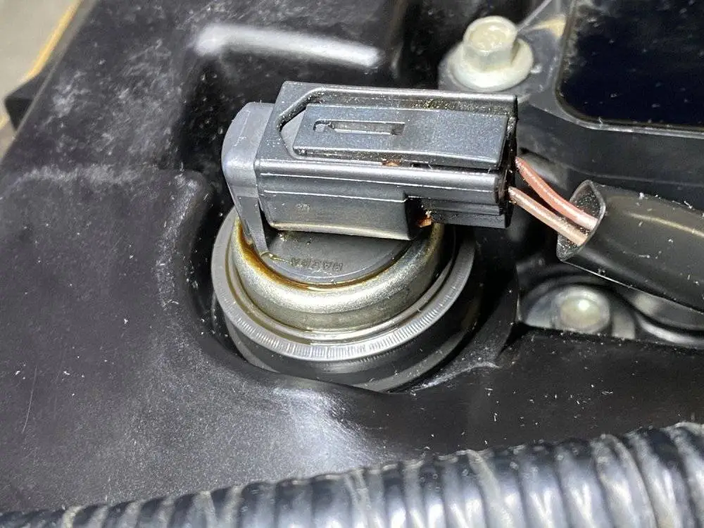

There’s a common problem related to variable valve timing (VVT) on high mileage CX-5’s which may affects camshaft position sensor error. The VVT solenoid, or oil control valve (OCV) on top of the engine tends to be leaking and it may worth to check the condition of the OCV. Here’s the part number:
Control Valve Solenoid - Mazda (PE01-14-420A) $188.72.
A leaky OCV:

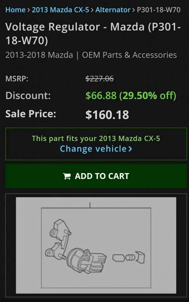

the oem seems cheaper with the discount.
see if you can get it at that price.
verify the part no by vin.
I used 2013 cx5 without vin in the search.
2013 GrT CX-5
In this case I'll just replace the entire alternator, rather than swap the voltage regulator. It looks like there would be a marginal savings, but I'm going to skip it. Thank you for the idea, though!
