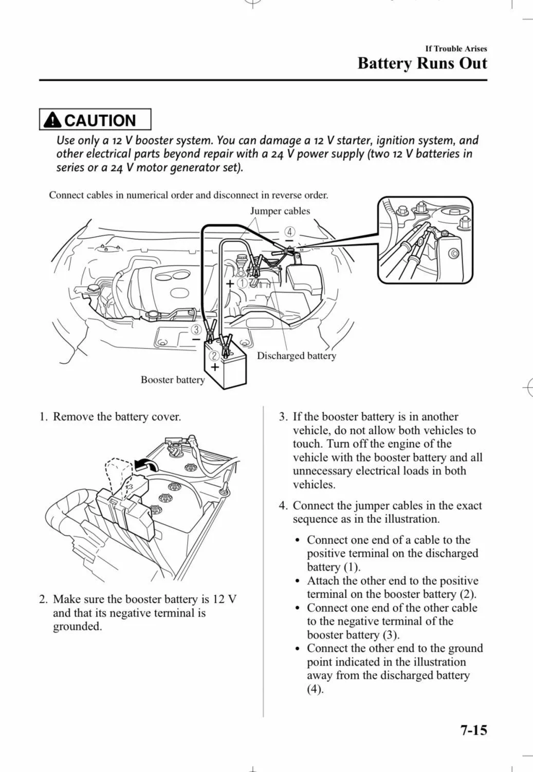

Did you connect your jumper cable in proper sequence? Did you connect the jumper cable to the ground point away from the dead battery for sequence #4 in step #4? And did you check the jumper cable which is in good condition and rated 8 gauge or thicker for higher current? Can you tell how old the battery is?
You can take the battery to AutoZone or other auto parts store to test the condition of the battery mentioned above. If everything tested fine then you can start to suspect the starter problem which would look like the symptom when you did the jump-start but this should be rare.
Most likely you need a new battery. Go get a Group 35 Interstate battery for $79 at Costco.
I actually placed # stickers in the engine bay because I can never remember the correct order. Step #4 is the most important. You have to connect to a ground with no painted surfaces otherwise the battery WILL not jump start.
I’d say you’ll have more chances of not be able to jump start due to bad connection somewhere on negative battery cable. Safety is the main reason by doing that way avoiding any possible explosion. This is applicable to all jump start with any type of the batteries, although most jump cables come with those small lithium jump start batteries are too short to make connection to the bare metal.
