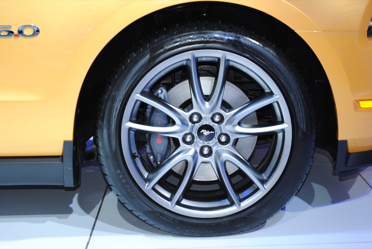

New 19" wheel with Brembos:
The first thing I'll be doing to mine is getting rid of the rear bumper and replacing it with a GT500 or Steeda version (with the diffusers). I don't care for the wheels, I like the 2010 GT with Track Pack wheels better.
