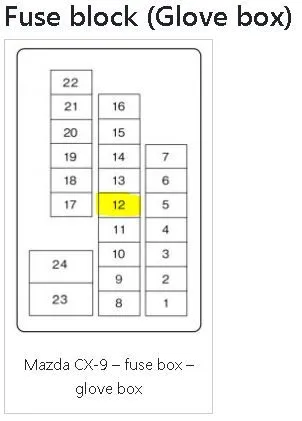

The Power Liftgate fuse for your 2010 should be in the glove box fuse panel. It is the 20A fuse located here:
