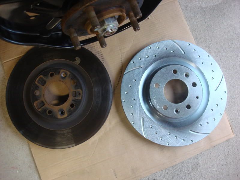

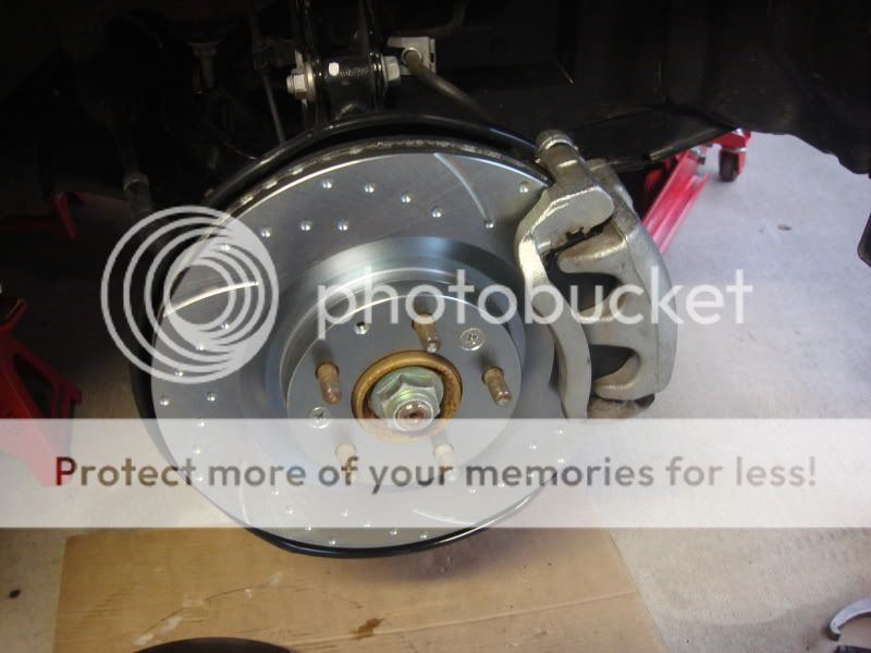

I did a How-to with pictures on replacing the front rotors of an '08 CX-9 GT. It's saved as a word document. I can e-mail if someone is interested (RTM).
The OEM rotors were shuddering bad (warped) so I replaced it instead of having it turned. :D. I'll give an update periodically on how these perform, after break-in of rotors and pads.
Update- The rotors and brake pads feel like they have been broken-in. I would estimate a 15% of increase in "bite" compared to the OEM set-up. A couple of intense braking from 75mph down to 15mph and there is no hint of "heat shudder" as I call it, from the OEM.
Installed rotors and pads at 18231mi and currently, mileage on vehicle is 18900. 669mi on the rotors and pads, and with regards to brake dust, no worse than OEM.
Reason for rotor replacement:
The OEM's were decent, however, the rotor warpage (confirmed by local mazda dealer, hence the reason for replacing rotors) were exacerbated when a couple of back to back brake applications from a higher speed increases the tendency of the rotors to shudder really bad. The shudder increased in a linear manner as the rotors built-up more heat as it was used.
I will update periodically of any other findings I might be able to share to members who have warped rotors, and were thinking of replacing it with aftermarket parts.

The aftermarket rotors/pads have been working really well. No pulsation even after repeated deceleration from highway speeds and some "panic stops" thrown in. However, there is faint brake squeal when slowly decelerating from around 20mph to full stop. Braking confidence has increased. Vehicle mileage is just shy of 22000mi..
I am satisfied and would recommend these rotors and pads if the need arises for any one of you to replace the rotors in your car. I'll post pics of the rotors and pad wear (if perceptible) after I remove the wheels whilst cleaning the vehicle.

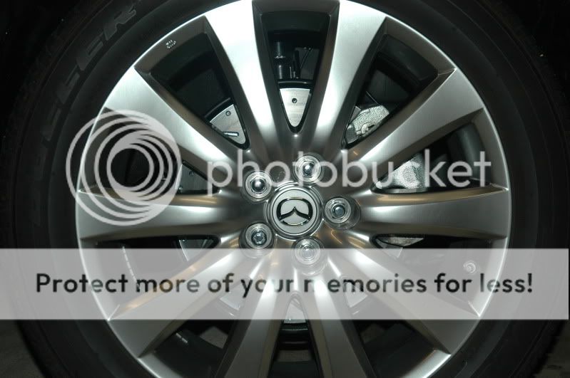

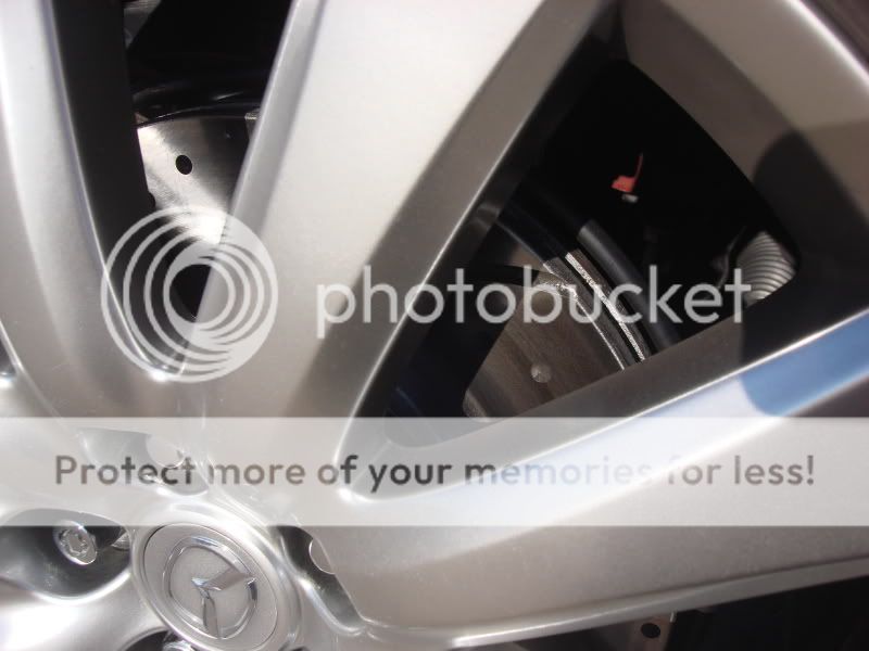

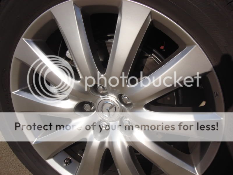

Wheel Removal for Detail
3xv, your backing plates, struts etc. look amazingly well kept. Do you remove your wheels for every wash?
And if so, do you properly re-torque the wheels when re-installed.
I used to be real detail oriented when it came to detailing my cars, but you are super dedicated!

Mojoman-I do remove the wheels when I wash the vehicle. I put the jackstands underneath the car for support then wash away at the undercarriage. :D
After cleaning the undercarriage of the vehicle, I torque all the lugs to 90ft.lbs. then I start working on the body of the CX-9.
Wash and wax is all I do, and put some tire gel periodically. Not too much involved with my regimen, average of 2.5hrs. work time from start to finish. (thumb)
