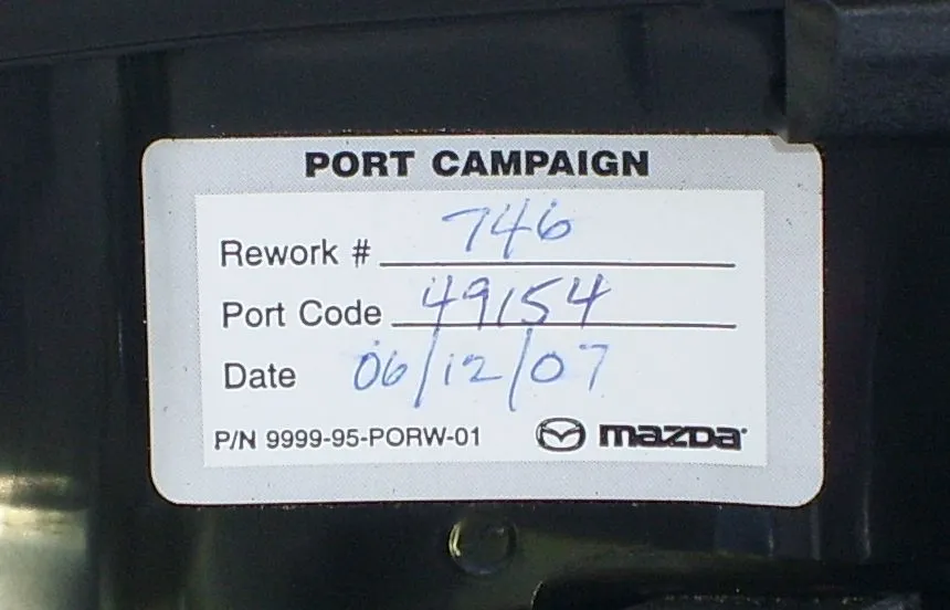

Could you get a better shot of that! I'd Like to have that in my pocket when I fianlly go get mine.
Ask and ye shall receive.
Took the previous picture last night and my camera didn't know what the hell to make of all the dark with a white thing in the center.

I'm not sure that is the mount recall. It should have campaign number 4607 in it. Not clear what rework #746 is - maybe one of the Mazda guys can find out. It looks like the right sticker, but the info doesn't match.
#746 is probably the work number for my particular car. From what I see in the dealer letter, there is an indication about a sticker saying Authorized Campaign Label RECALL 4607F or something similar, however it ultimately says, check everything in the computer.
