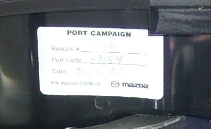

You should have a sticker somewhere under your hood stating there was a campaign on your car. This will verify that the recall work was done.
If they did the work before it got to your dealer, there should be a sticker on the rear passenger side of the engine compartment. It will look like this:
Could you get a better shot of that! I'd Like to have that in my pocket when I fianlly go get mine.
