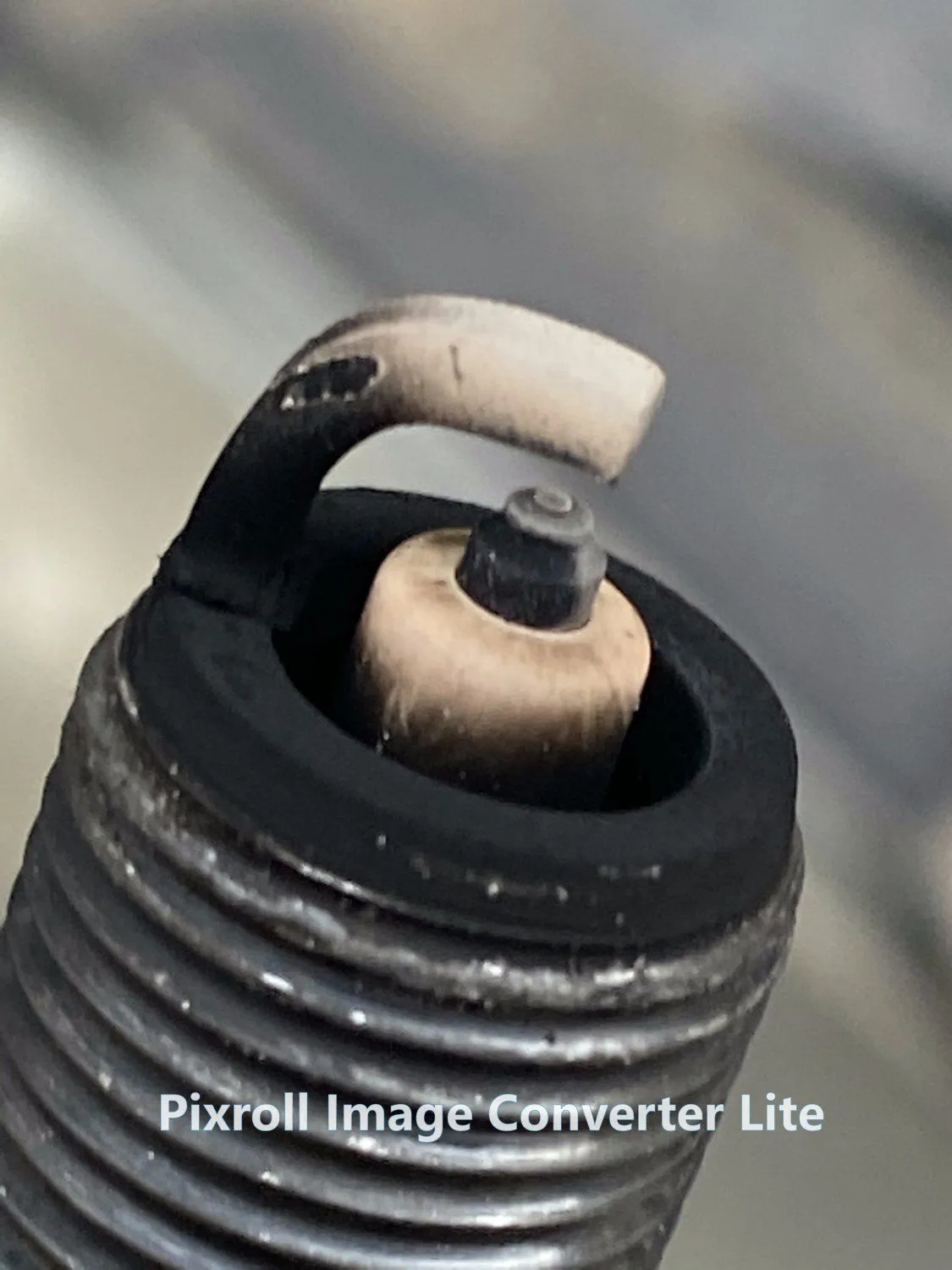

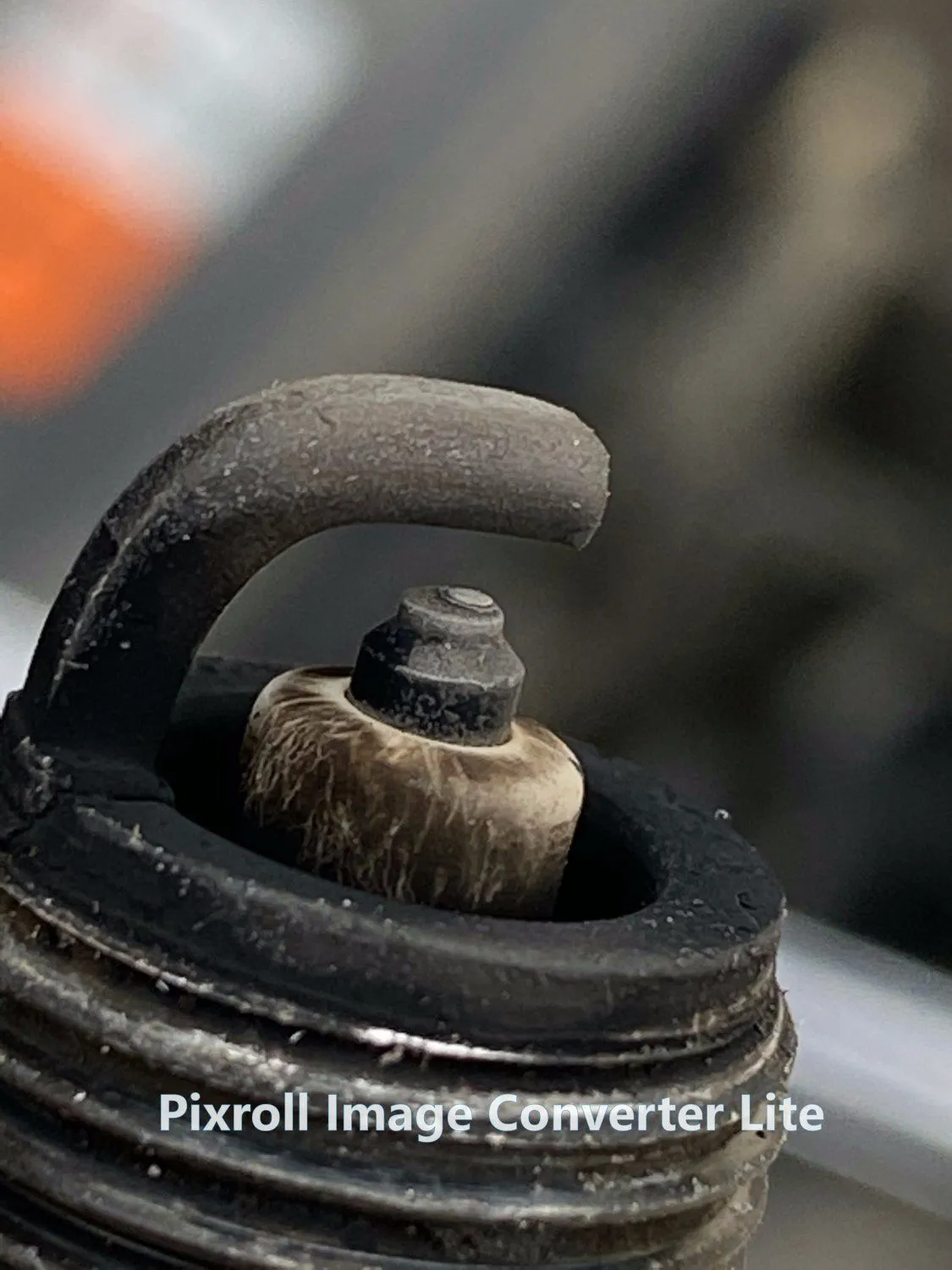

Hey Man, been sick as a dog. Finally the rain has stopped and I was able to get out there. I had to charge the battery been cold here and it cranked up. ran for about 10 minutes idling and I would move it up to 3000 rpms and let it come down. then all the sudden it just stopped. I pulled the plugs as you suggested. They are not wet but look like crap.
Upvote 0
The carbon on the plug indicates incomplete combustion, but it's not clear if the stalling is a result of a performance issue, or a mechanical transmission failure. The fact that it revs high and strong in idle makes me think the vehicle should be able to move down the road - lousy maybe, but a least something.
So I suggest putting the front end safely up on jack stands (or a shop lift), start it up, and put it in gear. With no load the wheels should spin freely, and should not be sluggish when doing stop and go with the brake. But if they're not spinning easily, that would almost certainly indicate an internal transmission problem.
