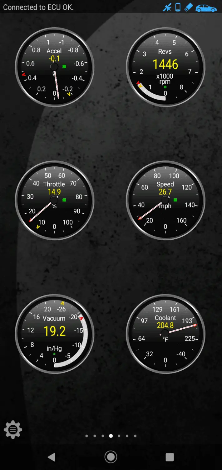

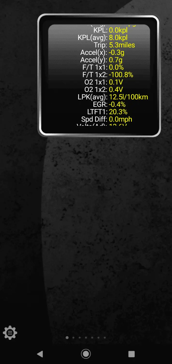

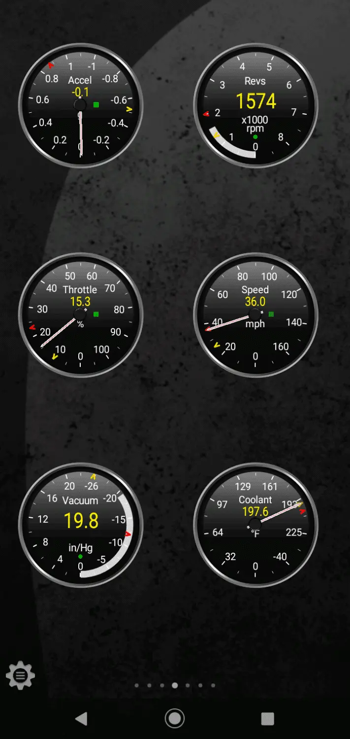

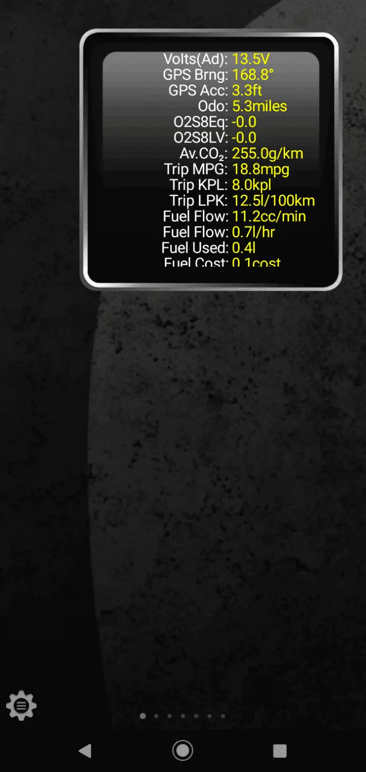

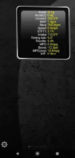

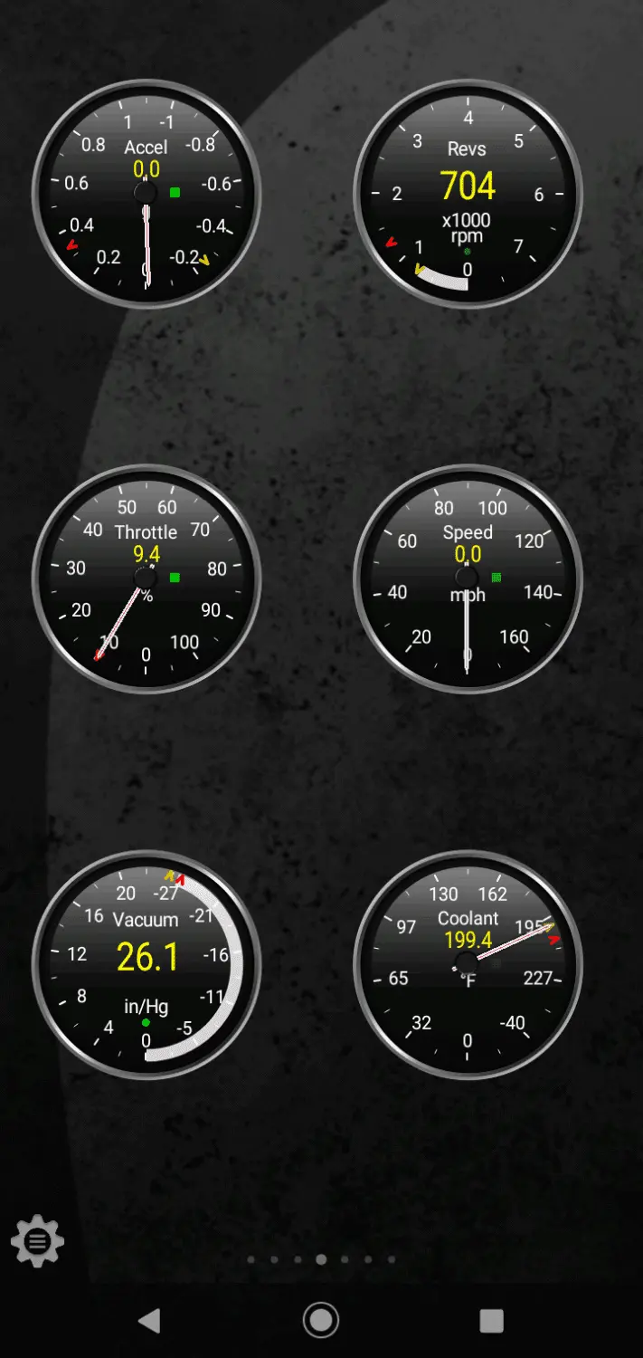

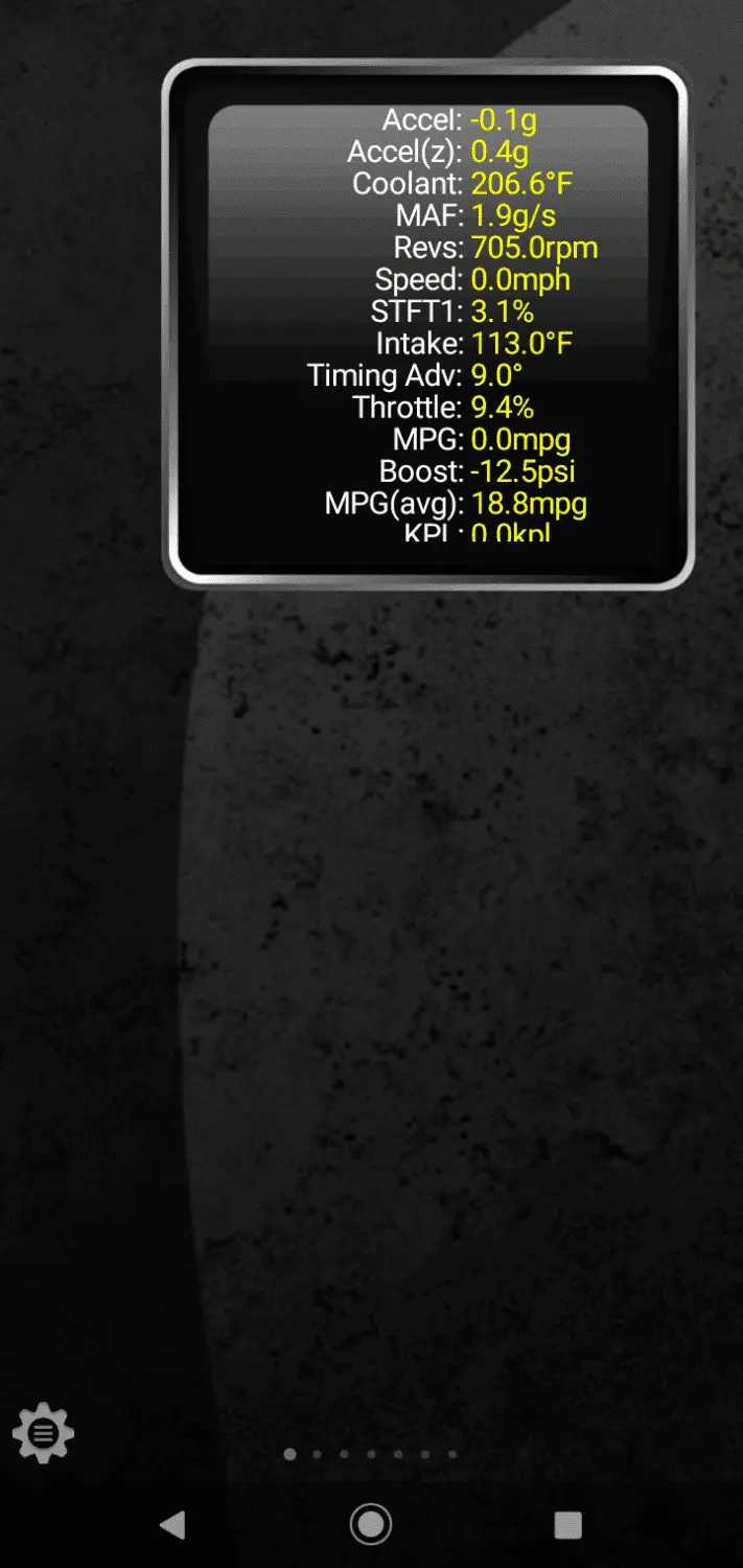

I took some screenshots while driving a few minutes ago
Screenshot_20201014-130303.png Screenshot_20201014-131611.png Screenshot_20201014-131709.png

I completely forgot to share this info, but omw home from work yesterday it drove fine to the nearest gas station at 7/8ths of a tank but I still stopped to fill er up... Within 2 miles down the interstate from the station it started doing it again with a completely full tank and continued doing it for the remaining 12 mile drive home. Once I got off the highway it did it again on the takeoff from the exit ramp for roughly 3 seconds and once it cleared the cel started flashing. When I started it this morning it wasn't flashing, does it throw a different code than what's pictured to make it flash?
Today I cleared the codes and have driven it roughly 25 miles. It only bogged down twice and both times were only during takeoffs and only lasted roughly 7 seconds the first time and 3 seconds the second time

I'm not sure, but if this means short and long term fuel trim, it doesn't look right.
It may be proof that it's in limp mode?
0.0% and -100.8%.
0.0% and -100.8%.

Great news so far!!!! My coils arrived today so I slapped em on and logged 128 miles with no issues whatsoever, as of now at least. And yes my fingers are crossed 🤞💀🤞 The rest of my parts I mentioned above will be here tomorrow and I'll be installing them on Saturday. By then I will prolly log another 100 miles or so on these coils, if no issues by then I'd say it was just the coils that went bad.
My Short Term F/T is .03% and the Long Term is 3.3%... She's runnin like a champ now, especially since it doesn't have one mod done to it. I appreciate y'all's help and I'll keep posting updates as I unleash her inner beast 👀🤞
