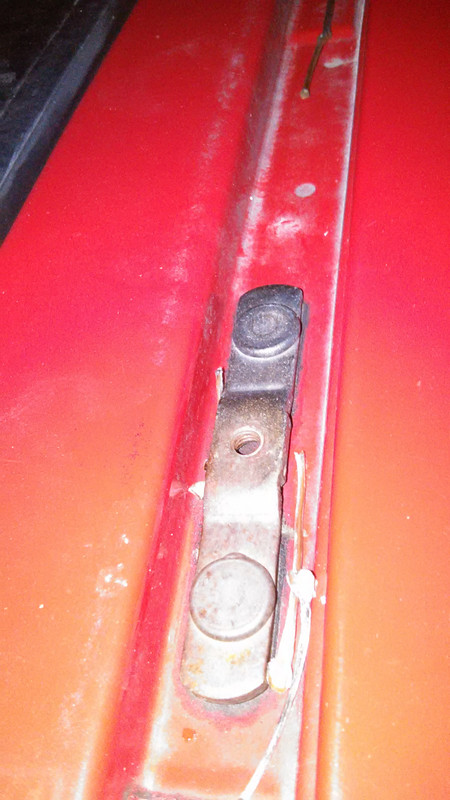

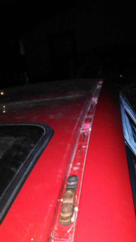

On a related note, does anyone know what the threaded brackets are for on my car?
I thought it was to bolt on the factory racks but I guess there's separate holes for that ?
Well either way, there are going to be holes if there's a roof rack. Whether it came from the factory or DIY. Anyway, I did have some luck drilling holes and installing the rack. And I read something about those other brackets possibly being used to mount aftermarket roof racks.
I did a bit of Googling and found out that Canada offered a Thule roof rack for the Canadian market provided by the dealer.
It just bolts on to the brackets... No need to drill holes in the roof or remove the headliner... Just bolt it to the factory installed brackets.
