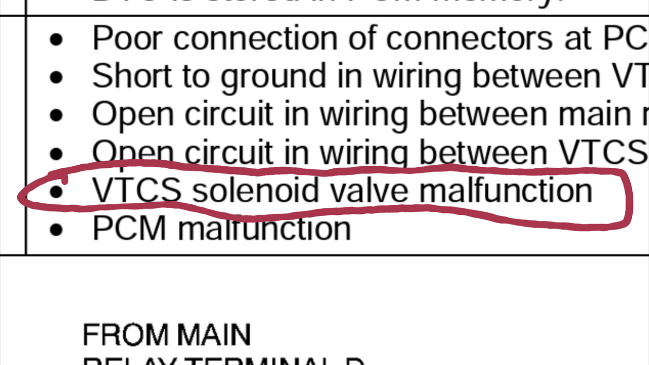

So I've had my Pr5 for a few years now and it hasn't given me too much trouble at all, especially for it's mileage. I got these codes today. 0171 is the MAF sensor that I replaced, from autozone, which I feel may have been a mistake. I don't have the tools to turn off the engine light, to see if it gets thrown again. Has anyone dealt with this similar situation? Especially with the vtcs circuit low input?

It's either the valve or a bad connection, broken wire, or shorted wire.
(or a bad ECU but that's not likely.)
