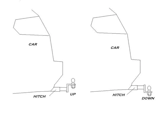

I'm going to be setting my trailer up ( it weighs around 1500 lbs. loaded) with the hitch no later than Saturday. I'll post some pix of the two together in the driveway. I do have a factory installed type though, maybe not what you're looking for. I'm planning on reversing the insert to the up position...I'm planning on around 250-350 lbs. tongue weight,so I'm guessing I'll get some sag.
Put your trailer in a level position and measure the difference with the car's trailer hitch. etrailer sells different height configurations. You can reverse the tongue depending on the height ( the drawbars have a rise or drop measurement).
