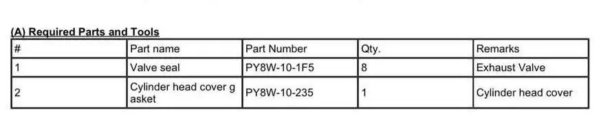

Read the TSB. Mazda came up with a special service tool (SST) specifically for this exhaust valve stem seal replacement without removing the head to save the cost of the TSB fix.

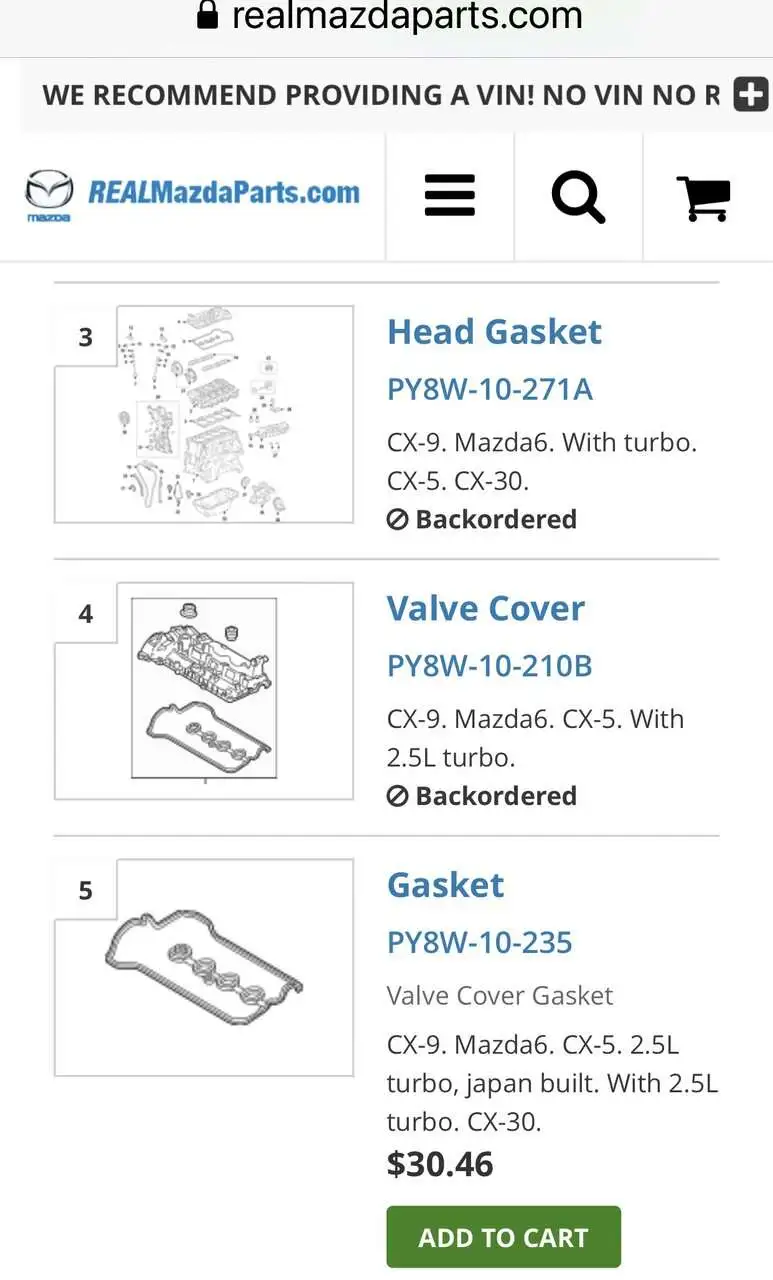

Read again! The invoice has never listed “cylinder head gasket” p/n PY8W-10-271A (#3 in parts schematic), but listed p/n PY8W-10-235 (#5 in parts schematic) which is the “cylinder head cover gasket”! The head gasket has never got replaced, and the head has never been removed for that oil consumption TSB repair!
Here’s the parts list on the oil consumption TSB:

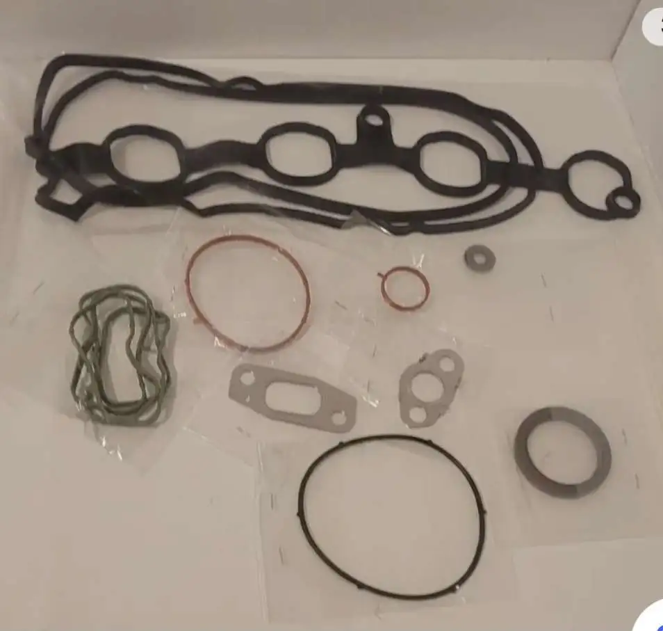

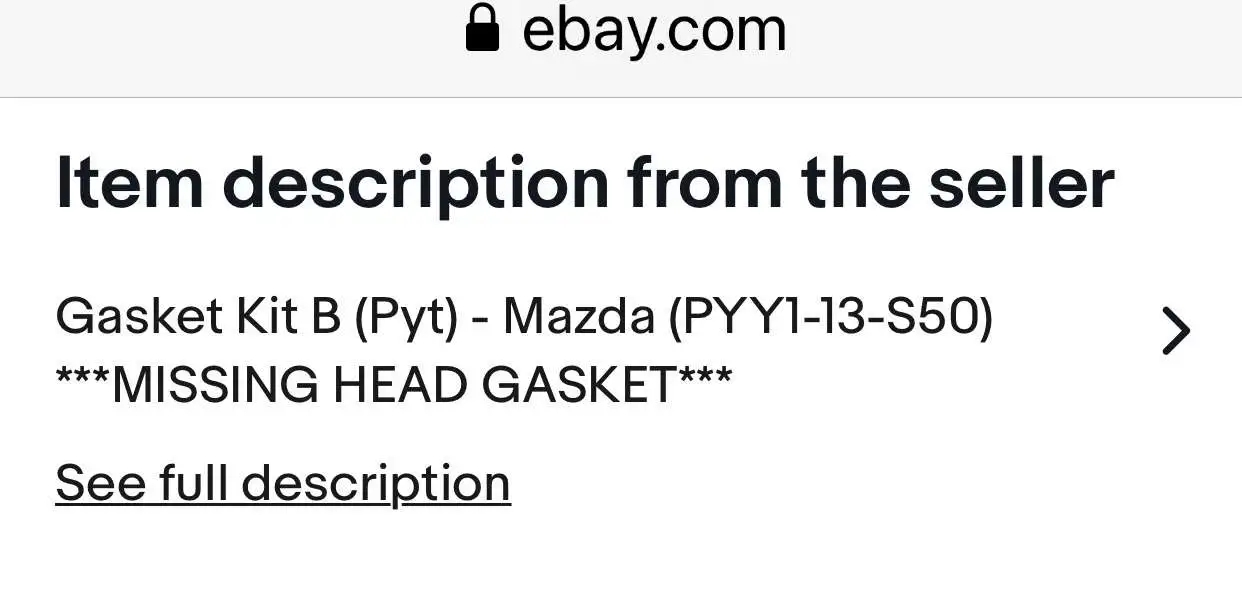

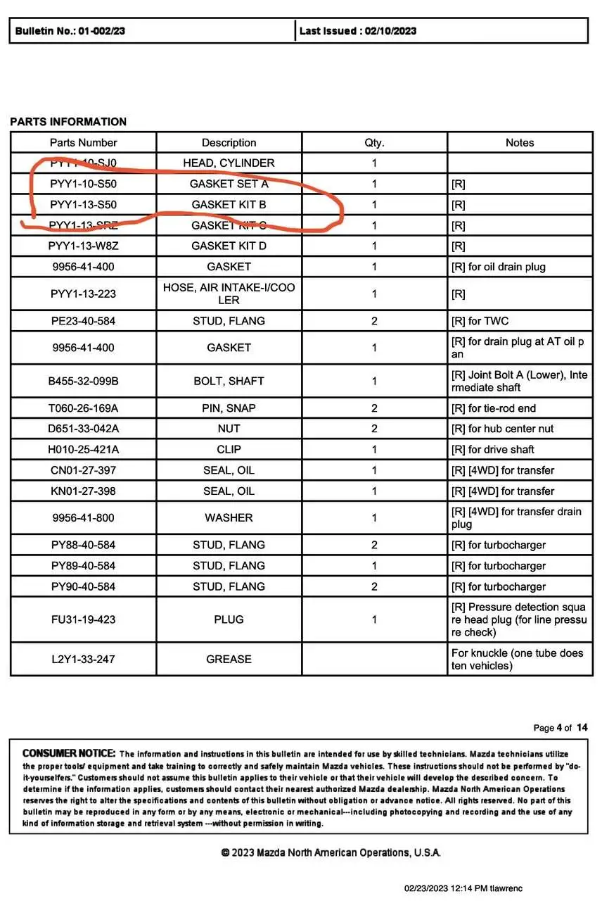

So the p/n “PYY1-13-S50 GASKET KIT” on the invoice confused me as I don’t see p/n PY8W-10-271A cylinder head gasket your dealer replaced. After some research, found “PYY1-13-S50 GASKET KIT B” in the parts info from cracked head TSB. Further research I found a picture on eBay for “PYY1-13-S50 GASKET KIT B” with missing head gasket.
In conclusion, your dealer didn’t replace the head gasket as they claimed when they performed the oil consumption TSB repair and found coolant in oil.
This time they did replace the head gasket、valve cover gasket and several other seals packaged in a new part number PYY1-13-S50 created in the cracked head TSB.
Still we don’t know what is the p/n “5555-CL-001R” coolant your dealer has used twice. I’d call the dealer to find out. Based on the price it doesn’t looks like Mazda specified FL22 coolant.
The assembly date of your 2021 CX-9 is October 2020. And your updated cylinder head seemed to be fine so far. Keep an eye on your coolant level and check if any coolant in oil from time to time.
I would guess that 5555-CL-001R is the bulk coolant that the dealer gets from Mazda. The FL-22 is nothing special. It is a hybrid organic acid (HOAT) coolant that uses phosphate as the "inorganic" component. It is borate and silicate free. You can use Zerex Asian coolant and others instead, but you can get into "cosmetic" issues if topping off with a different dye color. For topping off, I have used Ravenol FL-22 that is sold in a convenient 1.5 liter concentrate bottle and has the matching green dye. Interestingly, my 5 year old Ravenol coolant is now more yellow in appearance.
Your car built on 10/20 came from Japan with the updated head AND exhaust gasket Mazda listed in the coolant leak TSB, not oil consumption TSB. (I think there has actually been 3 head revisions). I will re read the thread but if they replaced the head gasket, why didn't they replace the non reusable exhaust gasket? You definitely do not reuse exhaust gaskets.
1. Why is there a head gasket listed on the Sept 30 invoice addressing a oil consumption complaint where the fix doesn't included head removal. 4.4hrs is the allowed time for exhaust valve seals replacement. Not even super mechanic can replace a head gasket in 4.4 hrs on a Mazda 2.5t
2. Where is the CRITICAL exhaust gasket on the 2nd invoice??? Is it in the PYY1-13-S50 kit?
I am sorry but your dealer is a ****** idiot.
I would press them hard on that exhaust gasket. If it's not in the kit, it did not get replaced, I don't care what the **** comes out of their lying mouths. That re-used gasket could cause the head to crack when the car is way out of warranty and your looking at $7000 repair bill. If that gasket is not in the kit I am on the phone to both mazdausa and the stealership.
Something is very very wrong. Your car goes in for a valve seal replacement for oil consumption, then they mistakenly list an unnecessary head gasket, then you immediately have a blown head gasket which never never happens on this engine. Then they fix your bulls*** blown head gasket with no exhaust gasket? Did I say your dealer ship is messed up yet? Wow

5555-CL-001R “Anti-freeze” has been mentioned on a Mazda dealer engine replacement work order in a Mazda3Club.com thread as early as 2004! At that time Mazda didn’t have FL22 coolant. Is it possible Mazda dealers still use the same 5555-CL-001R “Anti-freeze” part number for a different bulk FL22 coolant after almost 20 years? Highly unlikely. This’s something I’d want to find out. Mixing different types of coolant is always NOT a good idea!
You really raised a very legit point I was overlooked!
Like I concluded in post #929 above, @wineng’s 9/29 invoice didn’t list any head gasket. It’s the PY8W-10-235 “cylinder head cover gasket” (valve cover cover gasket) listed which is needed for exhausted valve stem seal replacement.
Yes, I totally agree! In fact, I’d think all gasket set / kit A、B、C、D and many other gaskets and seals listed on the part list in the head replacement TSB (post #929 above) should be needed for a cylinder head gasket replacement! Same procedure, only the head is reused.

So, I called Mazda Canada and I sent them the invoice. They called the dealership and then spoke to the technicians at Mazda Canada. He assured me that the proper kit was used (other kits were not needed for this repair) and all gaskets that were supposed to have been replaced, were replaced. This includes the exhaust gasket.
He will email me the list of gaskets included in this kit in a few days.
So is the Mazda Canada saying that Mazda dealer gave you an incorrect invoice for the cylinder head gasket replacement? If the part or exhaust manifold gasket isn’t listed on the invoice for the work order, they didn’t use it, period!
After following along with this thread for a while, it definitely sounds like they're just trying to cover their butts now. If they insist that the part was used, bring up the bolded point, citing that there is no evidence to prove whether the part was used or not because it isn't listed on the invoice. And if they push back further, request a written statement from Mazda Canada confirming that the part was indeed used despite not appearing on the invoice. If you do experience problems related to this missing part in the future, that written statement would go a long way.
