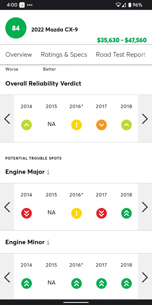

Can you post the CR reliability chart for all models years for cx-5 and cx-9 so owners can see the issues? Its been awhile since I am a subscriber. Thanks.
There's no easy way to grab this... Here's the info for overall reliability and engine problems. 2019 and up is still rated highly.
Other trouble spots were sporadic, but paint, body integrity, and the electronics got dinged here and there. Nothing surprising, and kind of consistent with some of the complaints that have popped up here.
