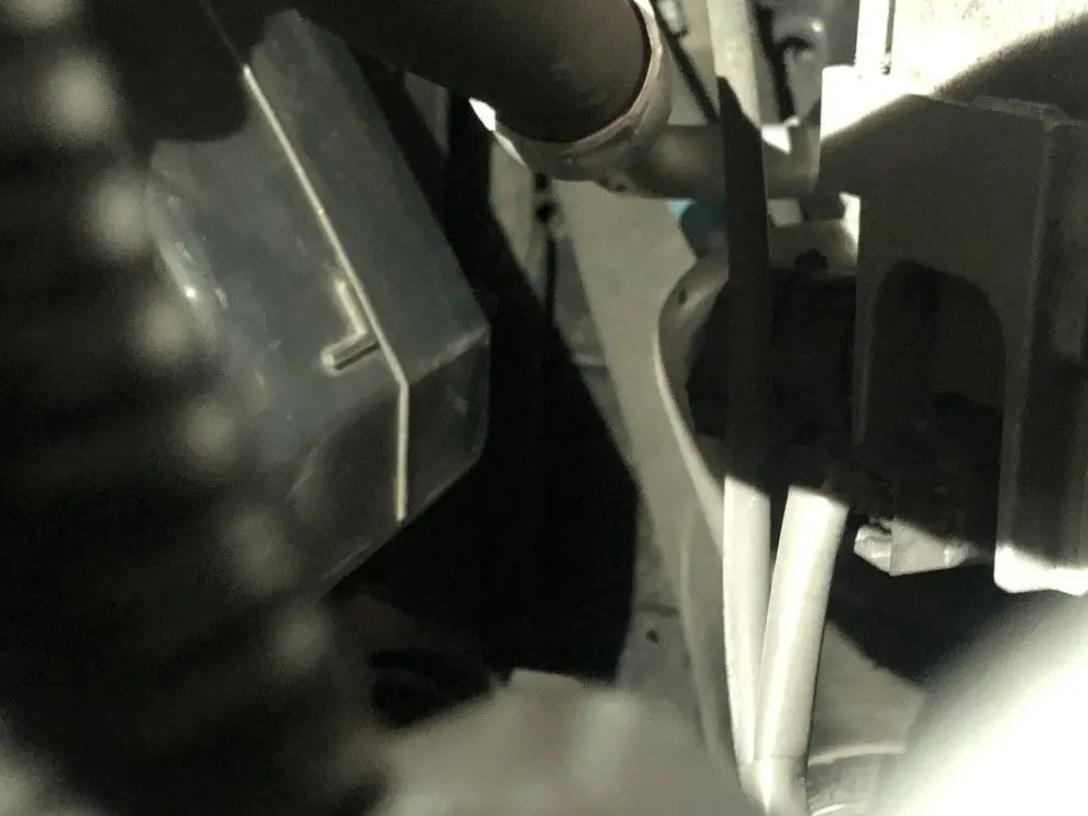

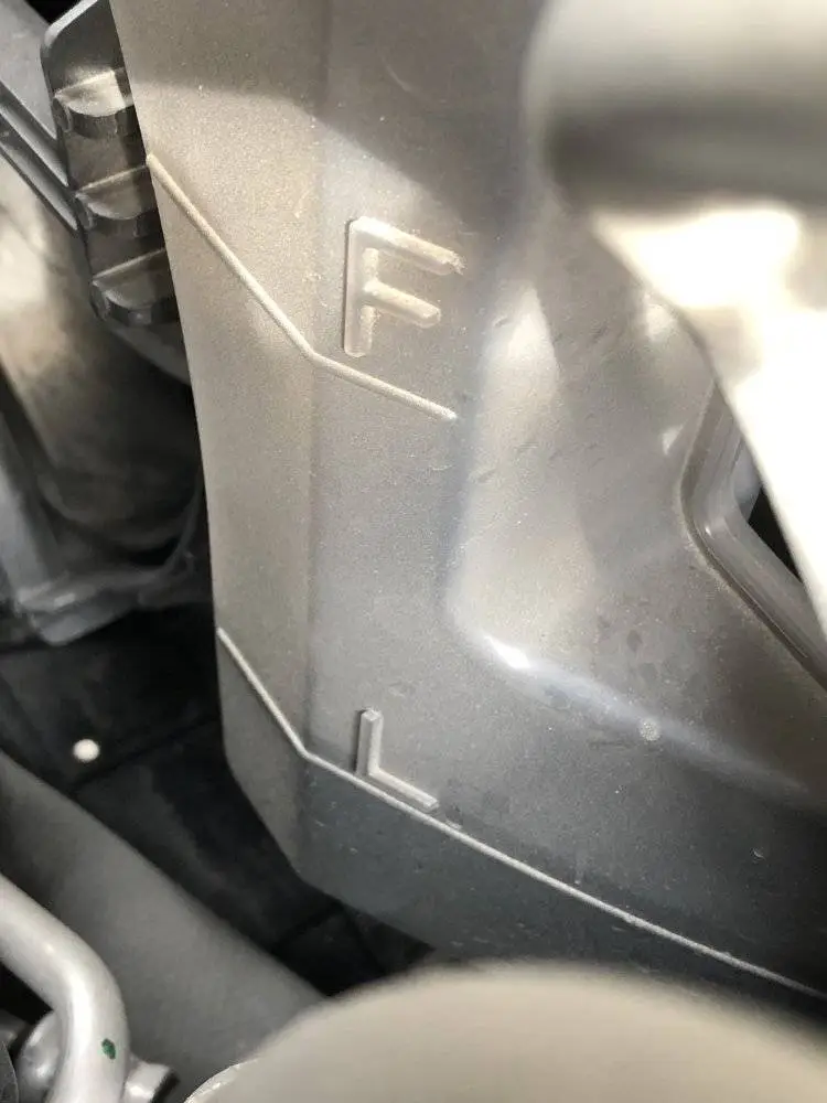

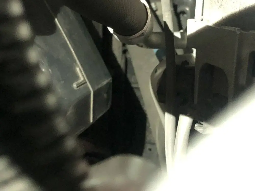

Hi guys, i 2019 cx-9 with 82,000 kms.
Just checked coolant and its indeed dropping over time. Is this normal?
There is about 1cm of coolant left in the tank. Cold engine. Heated garage.
Thanks!

It's hard to say. Do you get your vehicle serviced at dealership? If so, did they notice low coolant level and did they top off during last service? How's your oil looking? If you can, remove the bottom cover and look for dried coolant streaks.
But definitely fill it back up ASAP.
I dont get the vehicle serviced at the dealer. I do my own oil changes and maintenance. What do i look for in the oil? I’ll open the bottom cover in couple of days to have a look. I dont want to fill it up quite yet so i can take it to Mazda and they could see it first hand if i have to bring it in.
Thanks!

The coolant of your CX-9 has dropped way below the “L” mark (1 cm of coolant left means the coolant overflow reservoir is almost empty). While some coolant consumption can be ”normal”, but your situation doesn’t seem to be normal IMO.
A couple of things you can do. Take the CX-5 to your Mazda dealer as is, show them the TSB, and ask for possible coolant leak check. Or you can go underneath the engine bay, remove the plastic cover, and check any sign of coolant leak on the back side of the engine around exhaust manifold.
