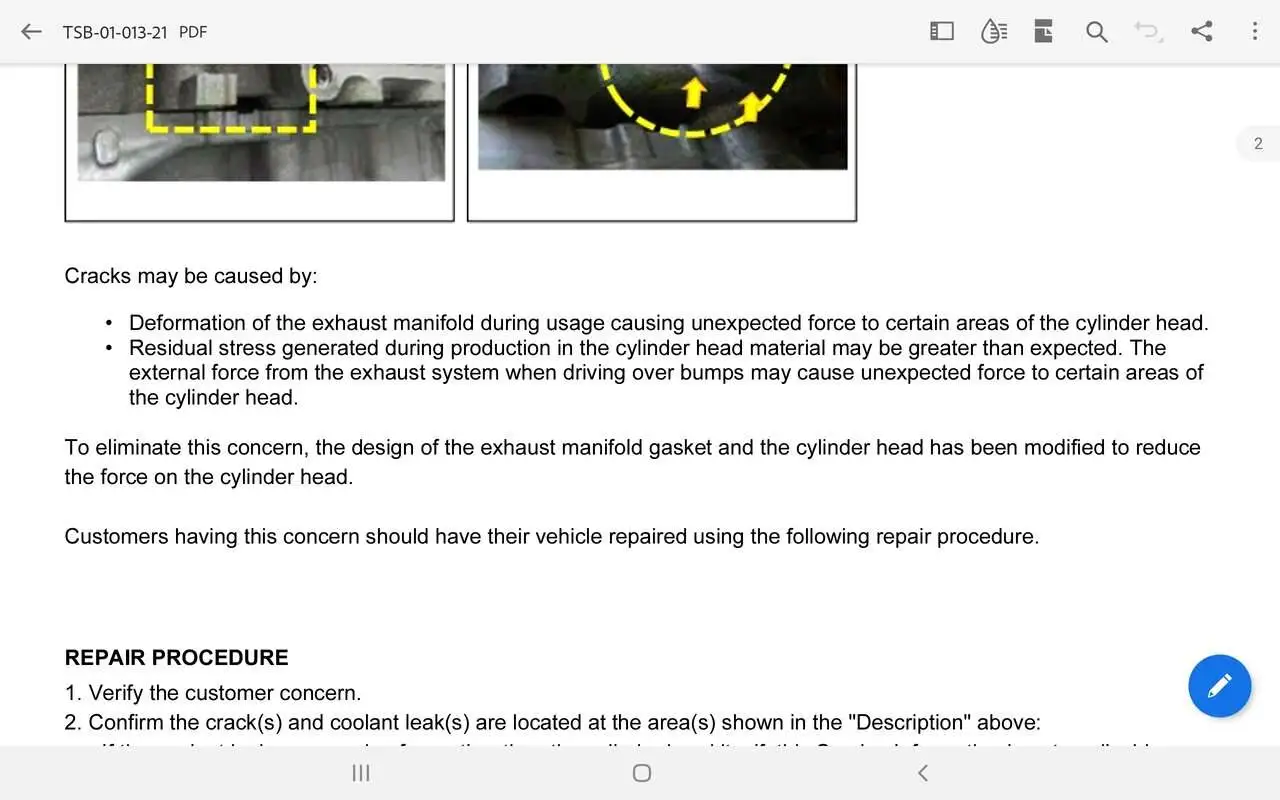

TSB 01-013/21. 2.5T

TSB 01-013/21. 2.5T

Yes, your situation seems to be different.
In the TSB deformation of the manifold is mentioned as a source of the cracked head so for some reason they get hot. Like a design mistake for the manifold.
I’ve always felt the problem is due to the redesign of the head from the original 2.5L NA which has weakling certain area of the head. But as you said, the redesigned exhaust manifold could be the culprit of the whole issue.
This really seems like this issue should be a recall for all 2019-20 2.5 Turbos built before June 9th 2020. Anyone looking at a used vehicle with this engine within the Vin range should be extremely cautious. Same holds true for the standard NA 2.5.
I agree that a recall should be issued for the 2.5T assembled before June 9th 2020. But you got to remember the same 2.5T is also used on the CX-9 since 2016 MY which also suffered the same issue. That would be a huge expense for the Mazda and Mazda won’t initiate such recall except they’re forced to do so by the NHTSA. That’s why those 2.5T owners who have suffered the cylinder head crack issue should file a complaint at the NHTSA website. The more the complaint filed, the better chance the NHTSA will initiate a recall like the recall on the falling rocker arms on the 2.5L NA with cylinder deactivation used on the 2018 CX-5.

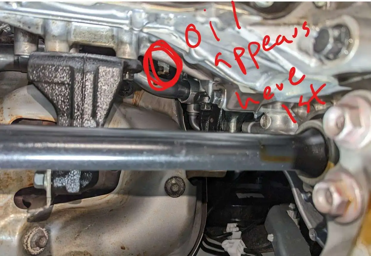

So our na 2018 started smoking. Made a huge mess of entire rear of car. Added a quart over about 500 miles of driving. After I cleaned up oil, I ran engine a few seconds again and seems oil starts in the area I circled. Is there anything else that might leak oil in this area? I had to top off coolant recently too, but not much. Couldn't more than the head get damaged from this problem?
Thanks
Thanks
Hope you still have 5-year / 60,000-mile powertrain warranty to get the cracked cylinder head replaced.
I do have warranty. Waiting to talk to Mazda and praying they have the head and loaner. Can they try to say it is just the gasket.
