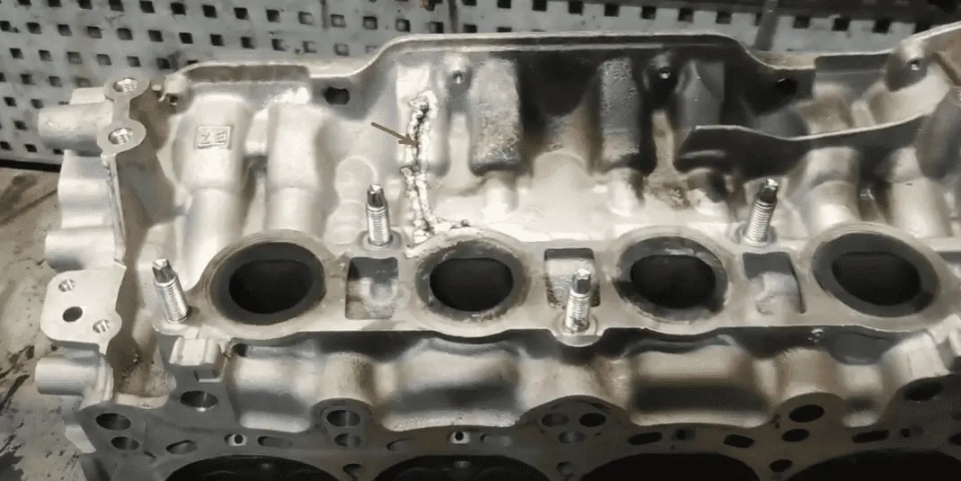

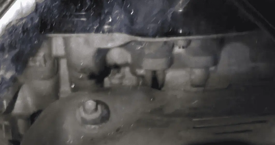

What to make of there being only 2mm of material at the location of the crack? I have a couple ideas—barely more than guesses, but informed by a dusting of logic, experience, and common sense, I hope.
Guess 1: Mazda used the occasion of revising the cylinder head for CD as an opportunity to implement a bit of ill-advised "value engineering" whereby they made other changes to the head--unrelated directly to CD technology--to shave off a gram or two of aluminum. This leads me to blame the bean counters who leaned on the engineers, not cylinder deactivation technology per se, for the cylinder head crack problem.
Guess 2: Given that the crack is at the cylinder 3 side of the boundary between a deactivating cylinder (4) and a non-deactivating cylinder (3), it’s not so much the extra bits and bobs supporting cylinder deactivation that caused the crack as a discontinuity between a CD and a non-CD cylinder. The discontinuity that comes to mind isn’t the change in the shape or thickness of the head, but rather the temperature difference between cylinders 3 and 4 that occurs when cylinder 4 is deactivated. Temperature differences cause different amounts of expansion, which causes stress, which causes a crack.
It would be interesting to find out if the aluminum at the HSA cavities in the pre-CD heads is 2 mm thick. If it’s thicker, that would support my first guess. If it is the same thickness as the corresponding part of the CD heads, that would support my second guess.
I doubt we'll ever know. I looked for photos of a pre-CD head showing the area and came up empty, but unless there's something drastically different about the casting of the heads, even a good picture probably wouldn't tell us much.
Note: Since the YouTube video from which the second picture below is taken was filmed in a mirror, I've flipped the image to make the head appear as it would if you were looking directly at it.
Note: Since the YouTube video from which the second picture below was taken was filmed in a mirror, I've flipped the image to make the head appear as it would if you were looking directly at it.
I personally would believe what happened is your second guess. Mazda has already made the head as light as possible from its original design, the manager in charge should be smart enough denying any ideas from his/her engineers of shaving even more aluminum weight.
Yes temperature differences between activated and deactivated cylinders has always been the big problems for cylinder deactivation system. Some company’s such as Chrysler chose to alternating cylinders for deactivation to even out the temperature differences which cause different amounts of expansion and stress to each cylinder.
And I always suspect the bigger switchable HLA (hydraulic lift adjuster) cavities for cylinder #1 and #4 in the CD head are bigger than original head, hence it may contribute thinner walls around the area.
