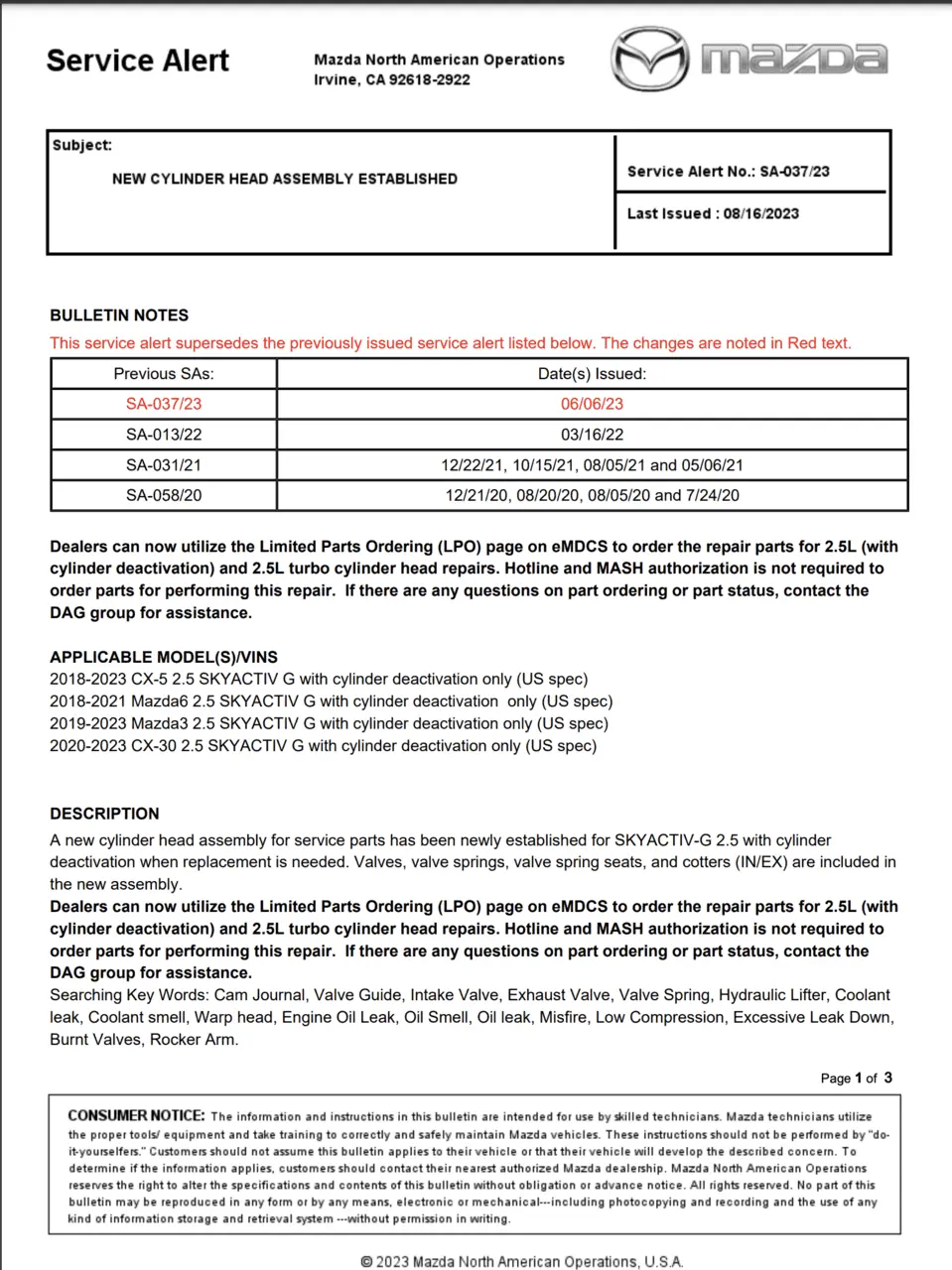

I made an account just to reply to this thread. I've been a tech for Mazda for over 15 years now, doing my second bad head related replacement today actually. The first time I found one was on a CX9. No complaints, was just a simple 16k service and I noticed that the oil and coolant had mixed together, opened a ticket to Mazda Canada and they sent an engine replacement. Now the problem is so common that we just replace the head and gasket. The problem seems to be from a small crack in the head near the exhaust manifold bolts. The engine will either leak coolant or oil depending on where it's located, but the leak gets worse the hotter the engine gets. Thanks to supply problems, took well over 2 months to get the parts needed to repair this CX5 I'm working on today. As far as how common this is, my dealership has done maybe 9 or 10 heads in the last year.

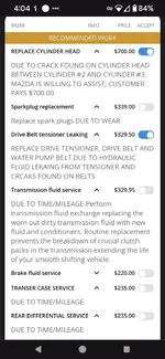

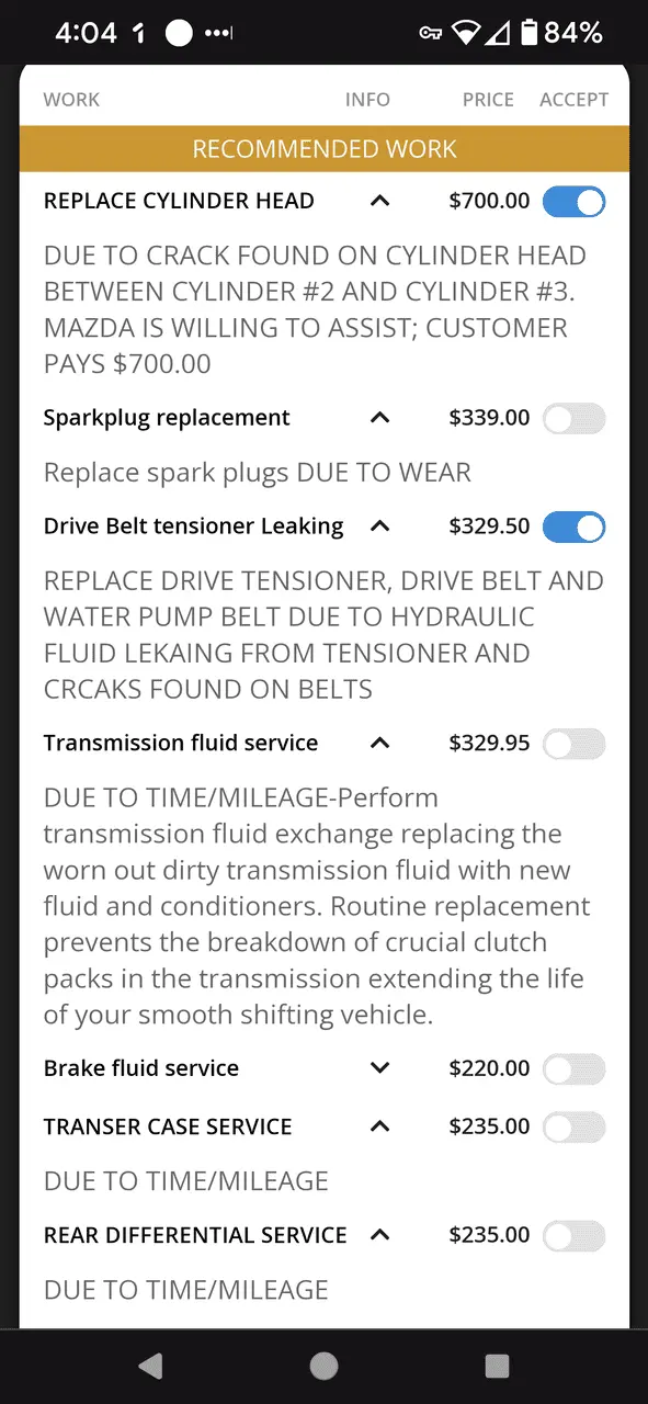

My Car (2018 CX-5, 70,000 miles)was diagnosed today with this issue. Had a smell when driving vehicle, smoke could be seen through the light of the headlights, didn't see any real oil, and checked oil regularly to see if I lost any, but nothing really visible. Took it to a trusted mechanic, they pulled the covers off the bottom of the car, and they say the engine was coated with oil, they said to take it to mazda as it may be a recall issue, either way they could not get the parts. They suspected a Blown Head Gasket. Just got off the phone with Mazda Dealership. Looks like Mazda is assisting with the cost even though i am out of warranty. Still gonna cost me some cash to get fixed.
Although I feel that Mazda should be picking up the full tab for these cracked heads, that net $700 is certainly a very good amount of assistance, when compared to most other out-of-warranty vehicles. Did you have all, or almost all maintenance done at a dealership? And it looks like you declined everything except the tensioner replacement - is that correct?
