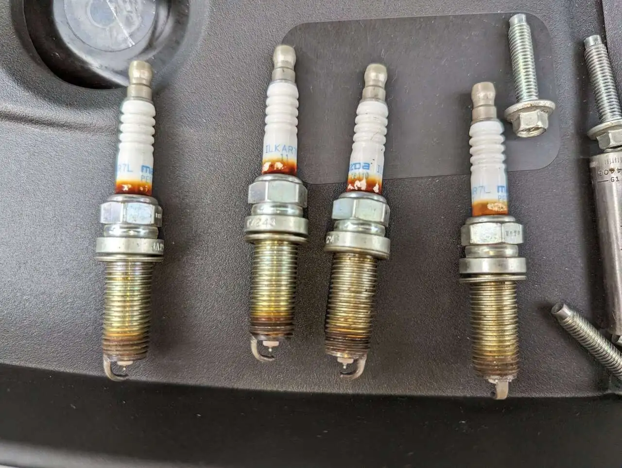

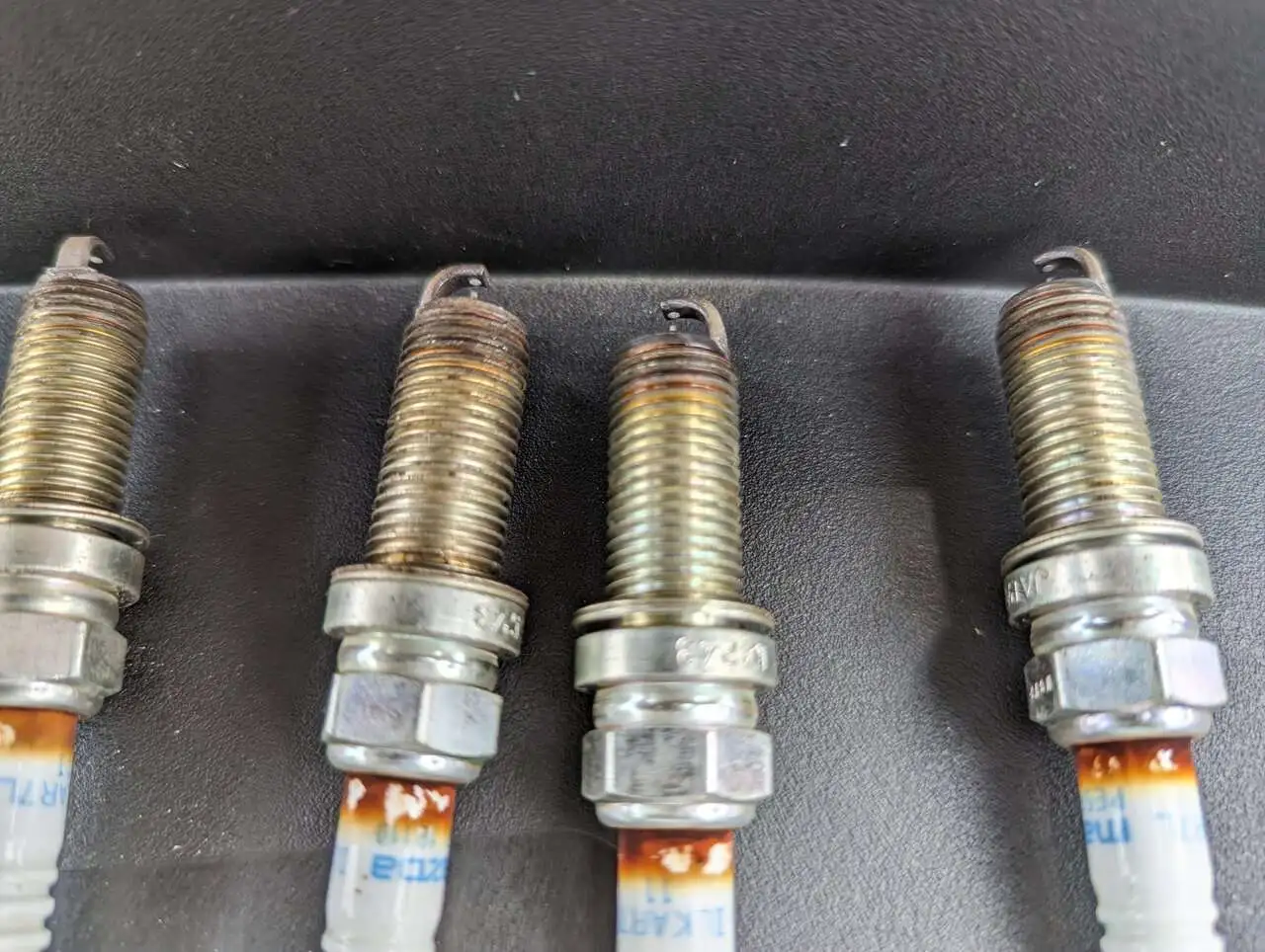

.... I inspected my 4 plugs today to make sure there was not further damage from the cracked head. Any thoughts on these plugs:
You didn't provide the number of miles on the plugs, but in any case, they look perfectly ok to me.
32,000 miles. Has any else noticed an almost imperceptible shake now and then at idle. i could just be insanely perceptive. I know my wife and daughter do not feel it. I just worry that something else could be damaged buy the head crack.
