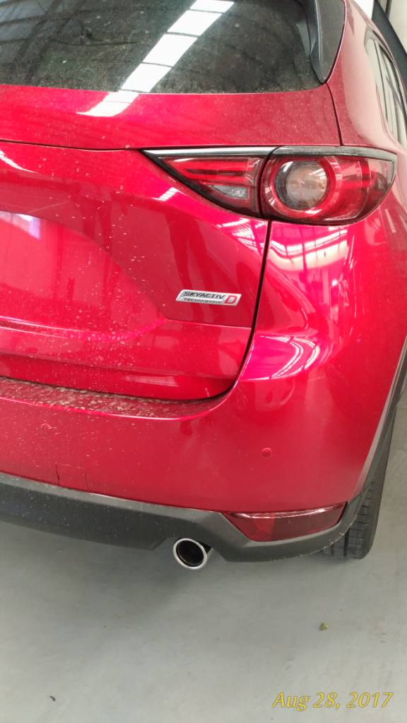

As more and more questions start to pop up about the forthcoming diesel engined KF (2017 on) model, I thought you might like a look under the hood. With the cover on it looks very much like the 2.5G.
