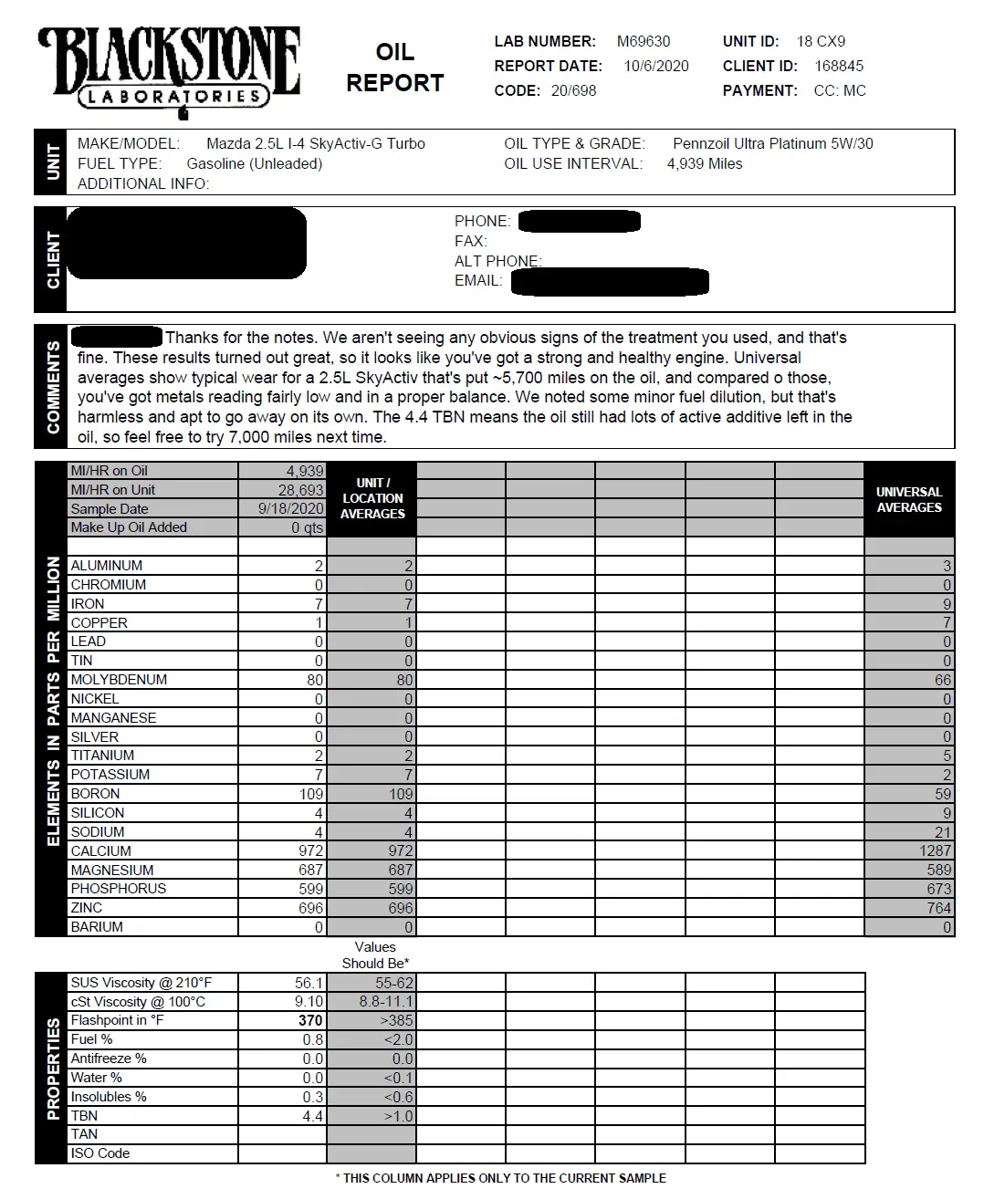

And to give you yet more legitimacy against the common meme of "anything added to your motor or transmission oil is automatically snake oil", I once again challenge the nay-sayers to discredit the following attachments.
I do NOT get paid by TriboTEX in any way, shape or form. I am merely passionately curious about how things work (hence my degree in Electrical Engineering), cars are both a necessary evil of the modern era and in some instances, fun.
