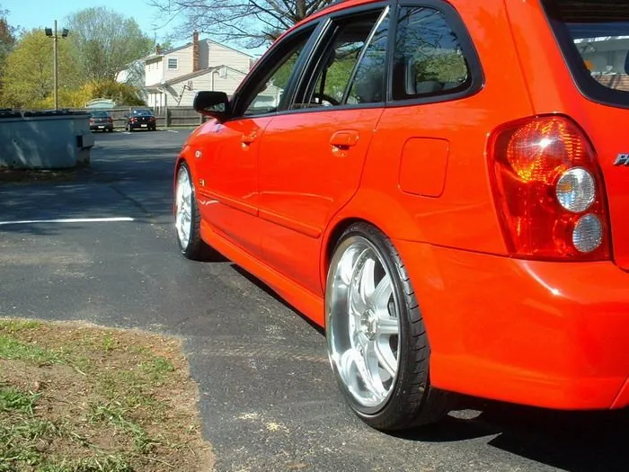

Hey mate, I have 18's on my P5, they are +45 offset and 7.5" wide, with 215-35-18's on them, and they have heaps of clearance in the guards. As far as I could see, if you had 19x7.5" rims with 215-35's or 215-30's and an offset of +45, you shouldn't have too much of an issue. My car is lowered, but not excessively. Click on my Rippers ride in my sig, and that may give you an idea of clearances

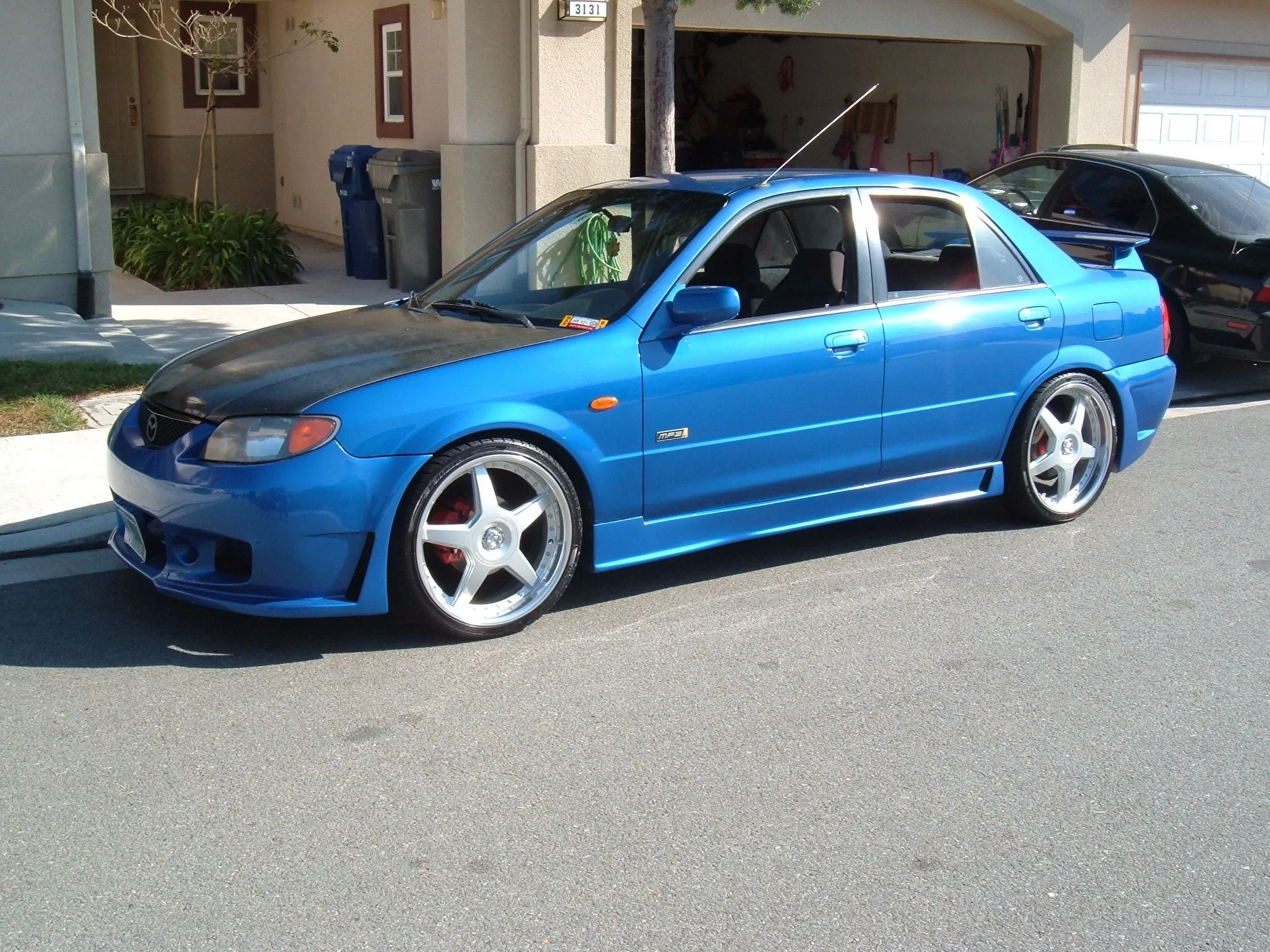

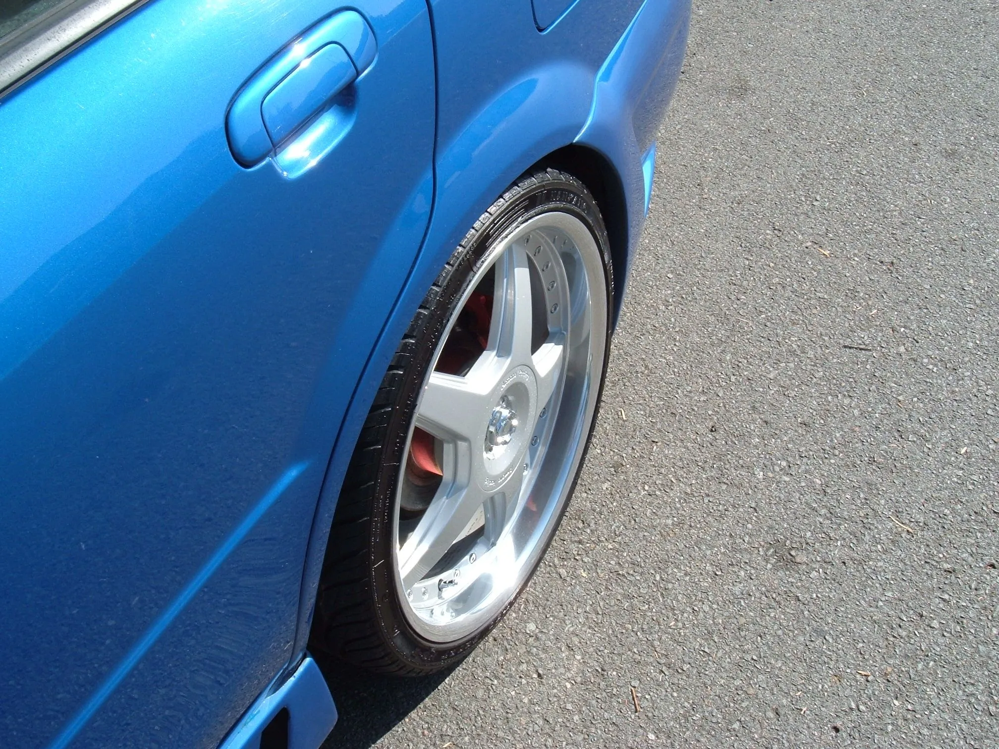

Here are some Pros with 19s.
