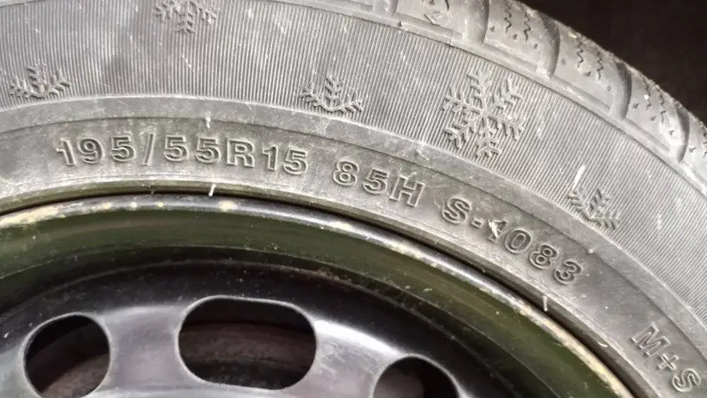

These are my winter wheels...

Thanks both pcb and Natey! I’m stoked that I don’t have to go hunting for brand new tires in that case. I’ll keep those specs in mind that’s great.
