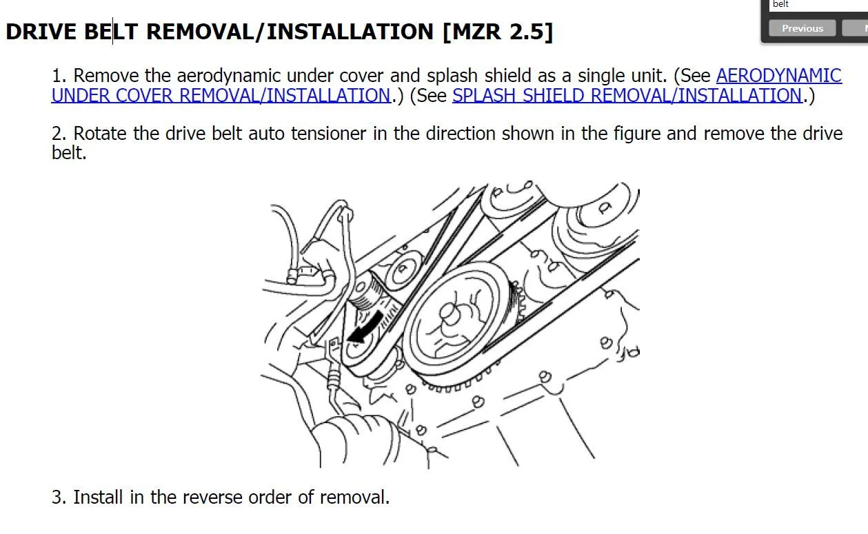

I've been searching for information whether videos, instructions, etc. on the removal and installation of the serpentine drive belt belt on 12'+ Mazda5s with the 2.5L engine and I can t seem to find any. Does anyone here have a link, online shop manual or any info on this? Is it the same as the old 2.3L engine? I wouldn't think so, since the old 2.3L used two separate belts as opposed to the 2.5L only using one belt. Any help would be appreciate it.

Here is the instruction from the official Mazda repair manual.
If you need instruction how to remove the two other plastic parts mentioned there, let me know. They basically just unscrew and unclip.
Thank you Vasy as always! Looks like a pretty easy swap being that he new 2.5L only uses one belt instead of the old 2.3L using two, the A/C belt being a PITA to change. I'm sure glad I don't have to deal with that.
