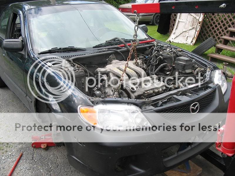

DOMSPUN said:
Hi everybody.
I'm the owner of the "soon-to-be-V6" Protege. The swap is not finished yet, maybe by the end of the month it will be running. There is some things I have to make clear before I go into details. This car will be a race car only(noticed the roll cage in the photo?), so a lot of "streetability details" have been left out. There is no A/C, power steering, heater, ventilation, radio, etc. I just need working lights, brakes and ignition.I brought a WHOLE 1993 Probe GT with a KL-ZE in it for the swap, I plan to put my 165K kms FS engine in it(winter beater)!
Mechanical/physical issues: not much! Everything fits like it was meant to be there, just take the motor mounts off the FS and put them on the KL! Also, the Long Neck intake manifold of the KL31 version of the KL-ZE doesn't fit if you keep the stock master cylinder. I was planning to put remote master cylinder, but I'm too poor! So a curved neck ZE manifold(best) or KL-03 manifold is mandatory. The transmission I used was internally broken so I don't know if they have the same spline counts, in the worst case I just swap the driveshaft ends, the transmission is almost identical externally. You need to use the radiator from the V6, so new brackets must be made.
Electrical/Electronics issues: well, I can not say that it will be easy, but it will be a lot of work. From our initial observation, Mazda didn't seem to have change a lot of things(connector-wise) over the years so it will be simpler. It will be an adventure to see what fit and what not! I have two whle cars, so I'm sure I'll find a way.
I'm sure that my experience with this swap will help somebody to someday make a streetable V6 Protege, till then I'll race it! (cheers2)
P.S.: Did you notice the nice Mazda 6 brakes on the car? (wow)
Good news, the stock Protege driveshafts fit! One thing less to worry!
For the one who's gonna try to make a street car with everything functionnal with this drivetrain, he better be a wiring genius!
