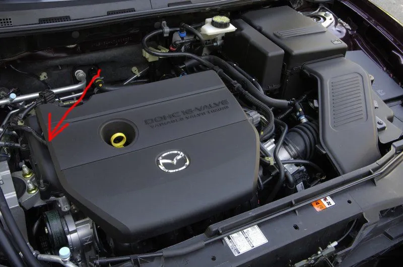

hay there,
can you please help me identify the problem causing the engine to make this rattle noise. THis video is not mine but my car is making the same damn sound. Please help
thanks
-m
http://www.youtube.com/watch?v=i8a9UhCggj8
also please see attached pic. Noise seems to be coming from just below the red arrow.
Hopefully this will help but Retighten the bolts under the front windshield in the cowl area. They are know to get loose. You have to pull of the wipers and wiper cowls but you will find about 7 or 8 10mm bolts. I work for Mazda and have seen them loose all the time. LEt me know if its fixed it. Hit me up on my site
