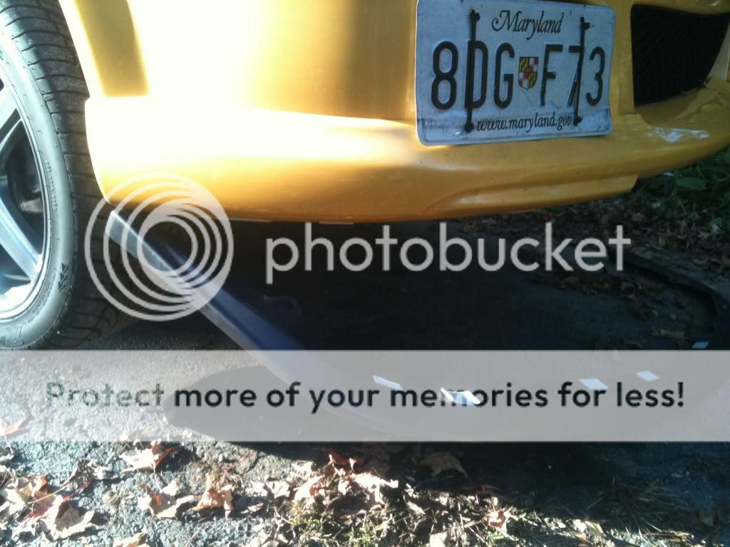

Well the day I planned on doing this ended up not being a good day.. But it's on now, I'll post up a few pics, I was told to use double sided 3M; don't do it! The tape sticks out pretty much wherever you put it on the lip, if anything you will need a few more self tapping screws, and some washers are a good idea too, the screws that came with my lip had heads that barely secure on the other side of the hole for it.

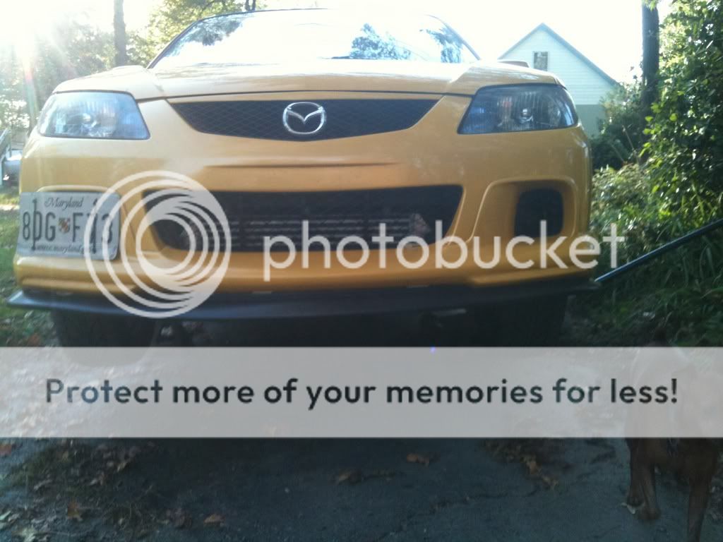

Here are some pics
First jack the car up

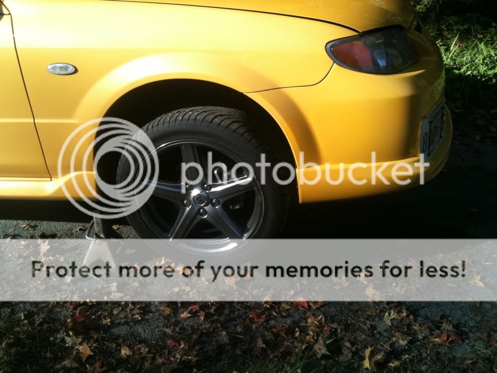

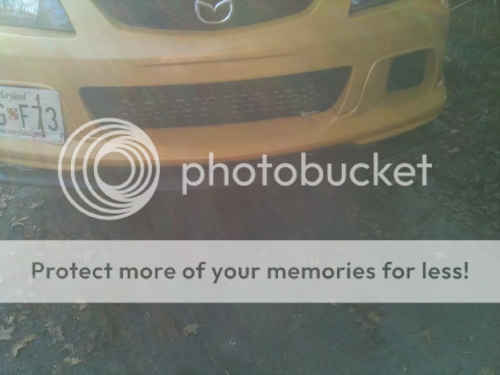

Line up the first end to the edge of the end of the fender well (picture the 3M not being there!) then screw it in

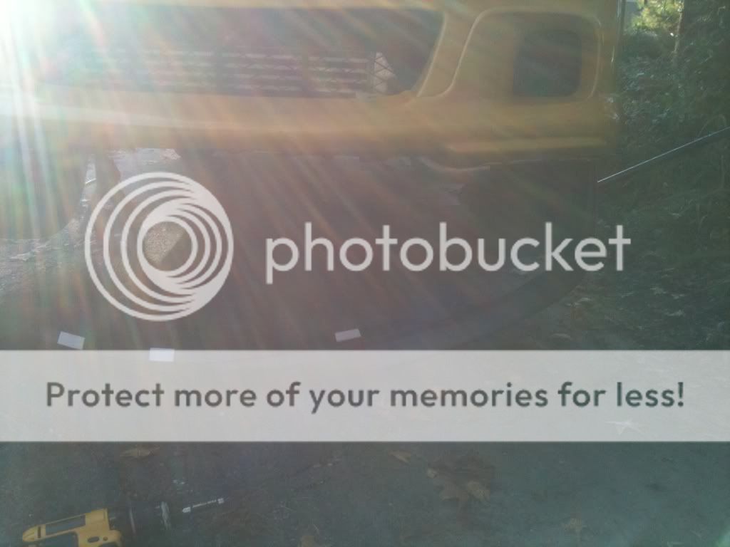

Line up the second side the same way (damn sun glare)

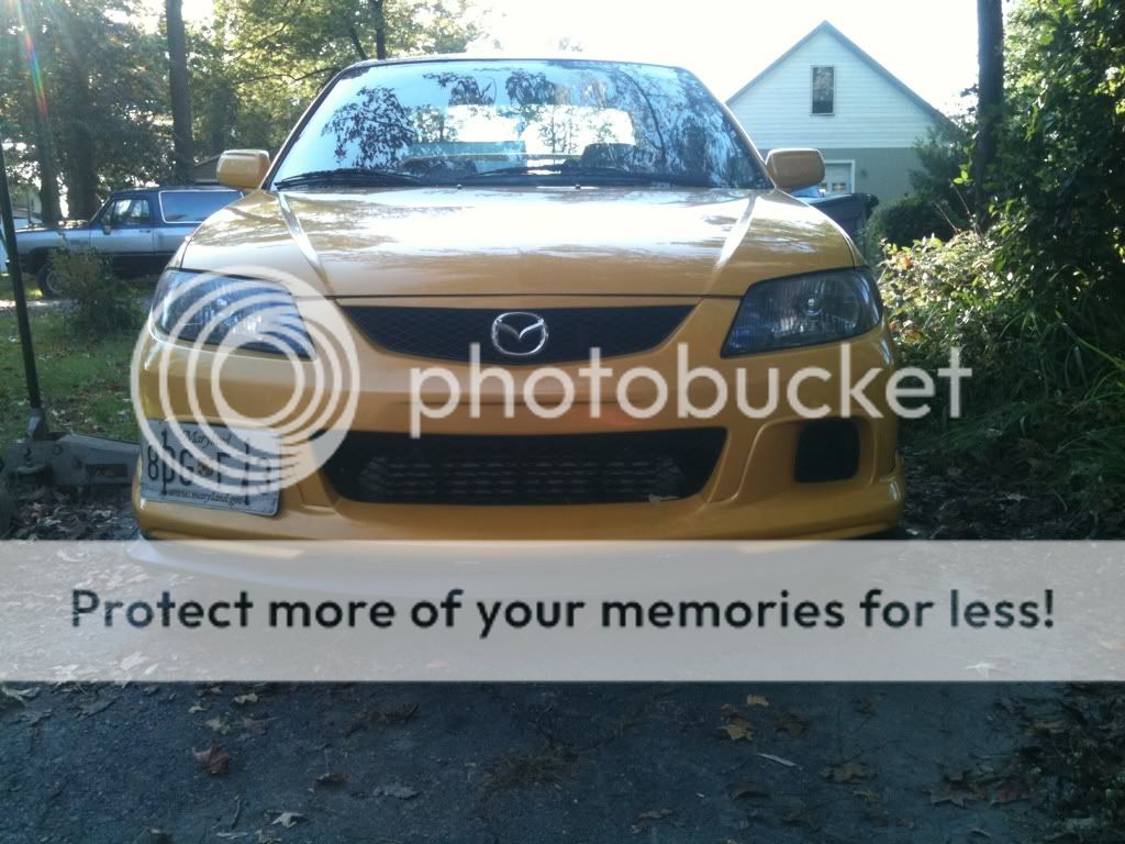

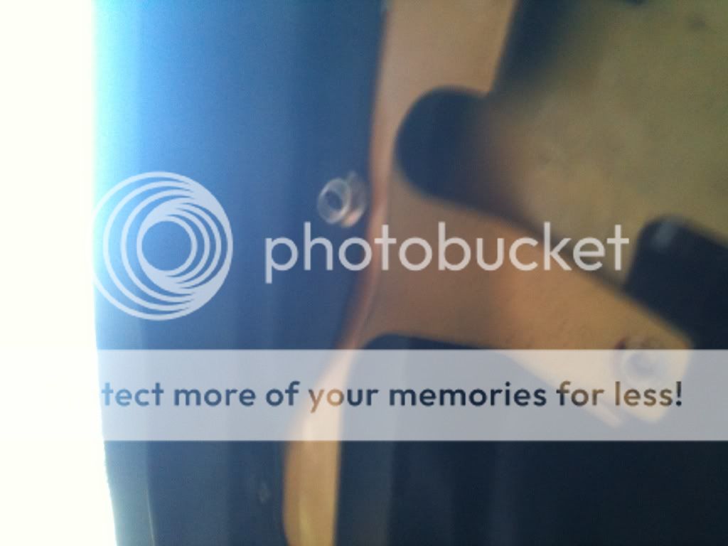

Set a screw in the middle of the lip

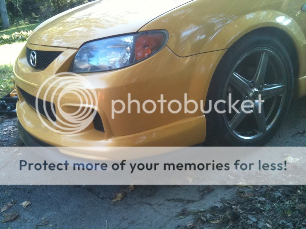

Some of the screws needed washers, but I didn't have any so I used the nuts that came with some bolts in my kit.
Then just screw the rest of the screws into the bumper, IMO I probably could have used a few more screws but that's all I had, probably add more when I get the chance (don't mind Kane:))

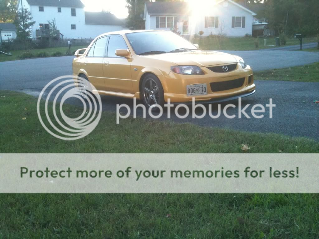

Final product:)
Opinions?:)
lol yea do not use double sided tape. not gonna happen. my lip had only 6 factory drilled holes. that not going to be enough imo. I wanted to make sure mine was on there good. So I used about 15 or so in total. lol now the lip does not move at all and closes up those little gaps giving a cleaner look.

I used screws like every inch lol, I was so unhappy with the gaps that I went nuts the next day lol. But yeah I had to almost remove the lip just to take off the 3M.. And the bumper will fall off before this damn lip does lol. But thanks man! I'm pretty stoked about how it looks now:)
