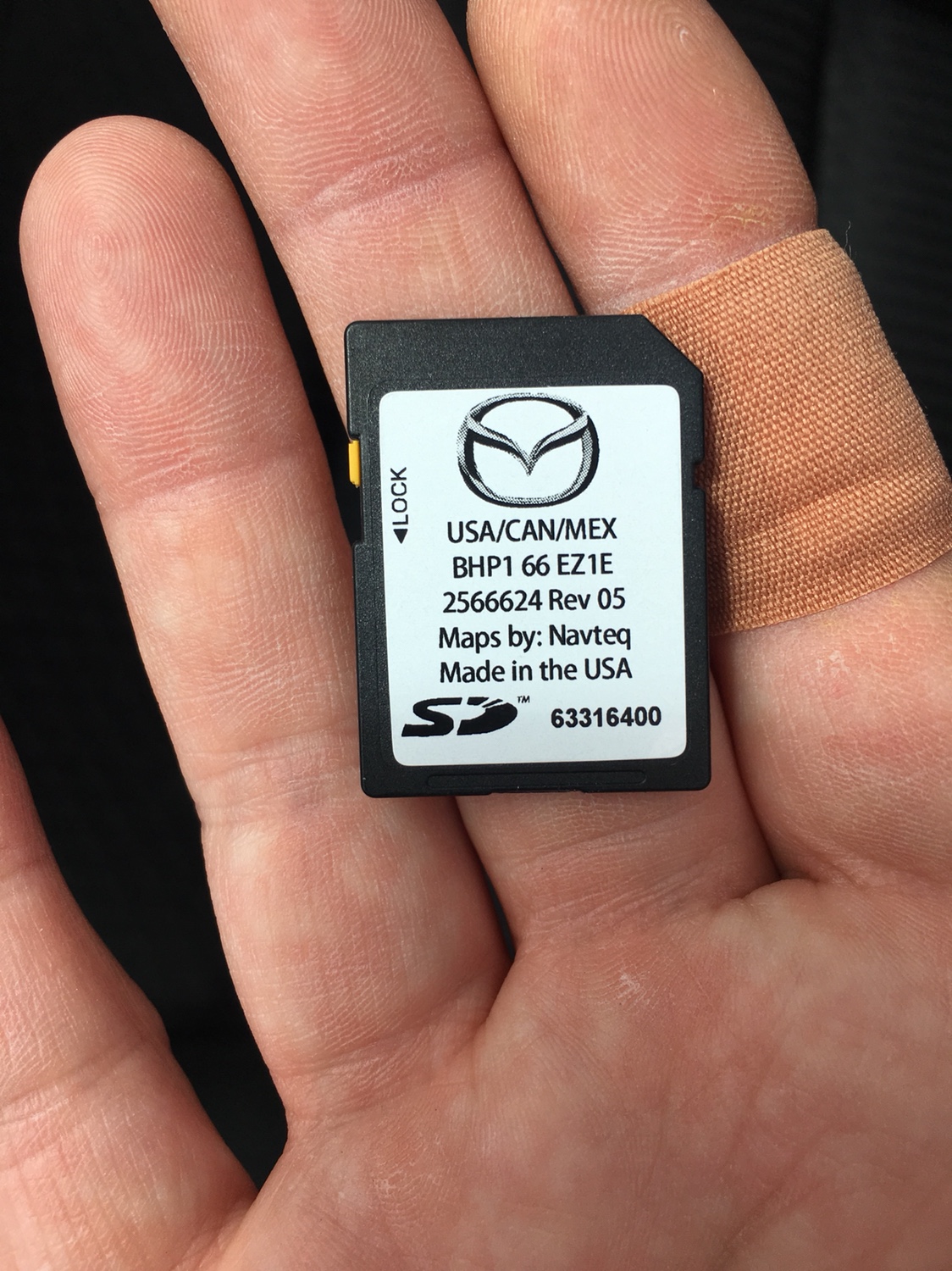

Hello all,

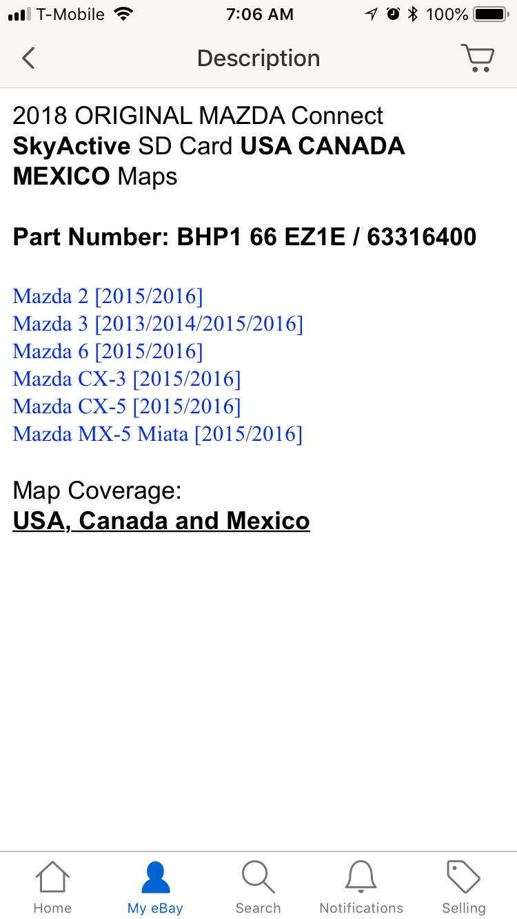

I’m new to Mazda, as this is my first. I tried googling about the NAV cards and went with USA BHP166EZ1E / 63316400. All I could find is the last letter is old to new version. A oldest and think H is newest 2018.

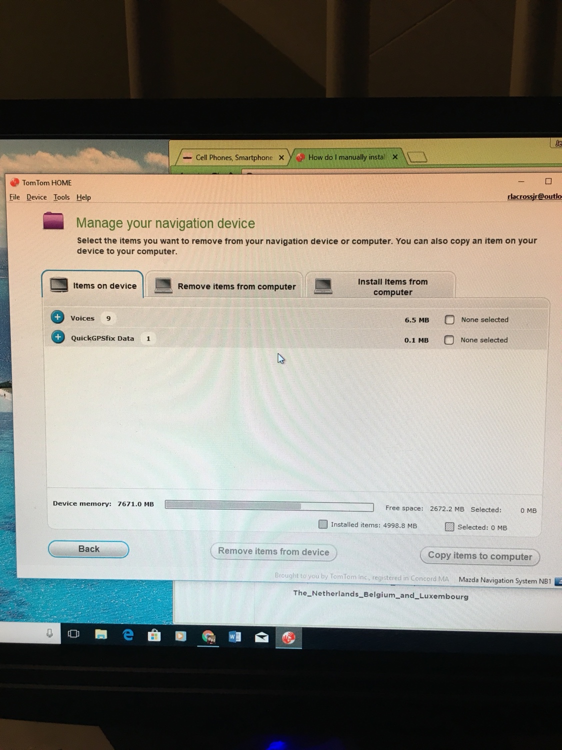

Because my vehicle is 3 years old does this make these cards expired? This card I bought I did the install steps and used TomTom Home to update, but was saying NO MAPs. Under items on device was not showing maps. Does any card work or did I get the wrong one? After trying this one I see they have BHP166EZ1E/ 63578300, what’s the difference?
The card I bought was from the UK so returning cost probably not worth it. So I tried to buy a new map. Paid the $65 for US/Canada. It downloaded and installed on the card and now it works. Does this sound wright for a 3+ old NAV or did I get the wrong card?
Other thing I noticed, not sure if normal. The computer voice option(voice command )I only have UK English not a US English.
This is before I bought the map.
It sounds like you did get the wrong card for the 2016+. Then when you bought the updates proper it just formatted the card and did a enw install so any card could have probably been used for that.

The 2015 and 2016 use totally different infotainment and nav systems. 2013-2015 was TomTom, 2016 - 18 are NavTeq.
So there are 3 cards with maps by NavTeq, TomTom , and Here.
So I should have gotten the version that says maps by TomTom. And me buying the map on TomTom home over wrote the NavTeq version. If I had bought the map TomTom labeled one it would have been put in and work.

Thanks all for the input. I did find that I should be using one of these cards. KD37-66-EZ1, KD37-66-EZ1A, KD37-66-EZ1B, KD37-66-EZ1C, KD37-66-EZ1D.
I email support on TomTom and they did say I have the wrong card and they will refund the map pack I just bought. So I have a case on eBay for returning the card, as they listed it to work on 2015/16 CX5. TomTom has refund pending.
