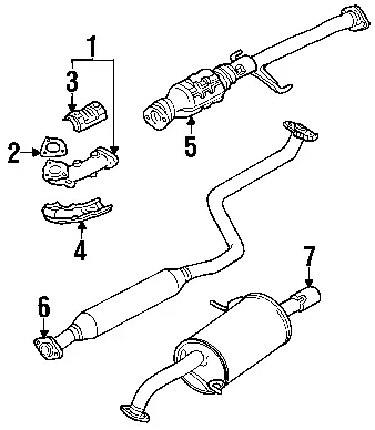

see attachment, it is the part labeled #4 that i removed. hope it helps

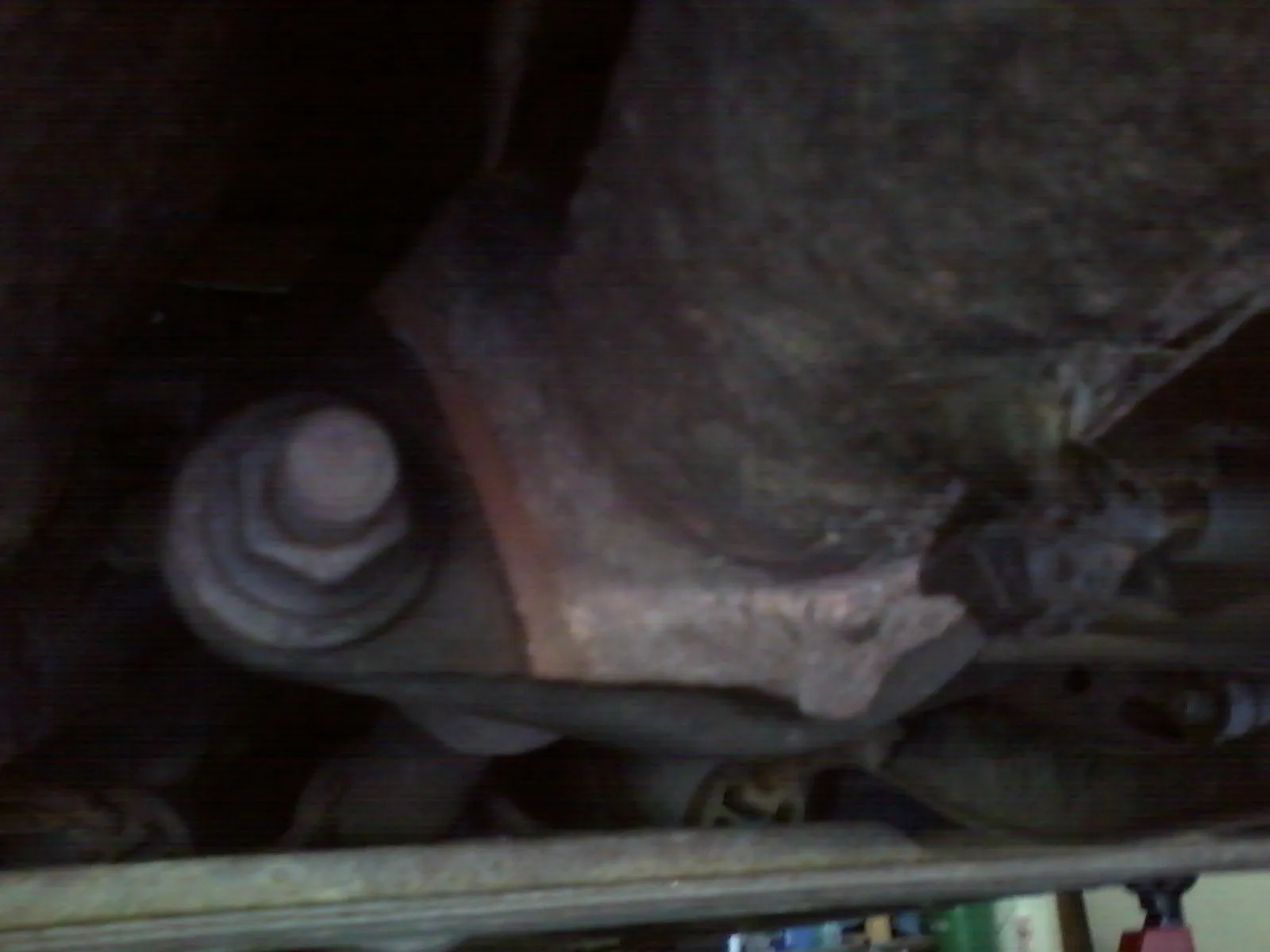

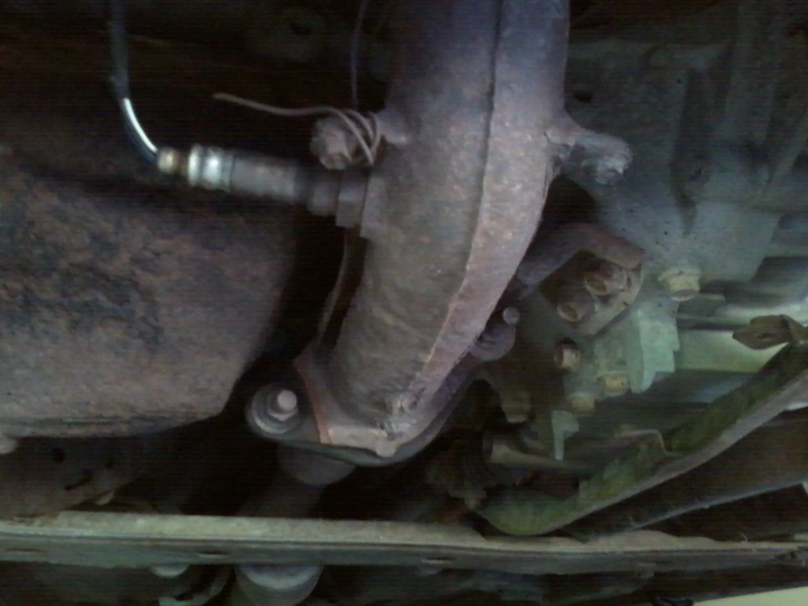

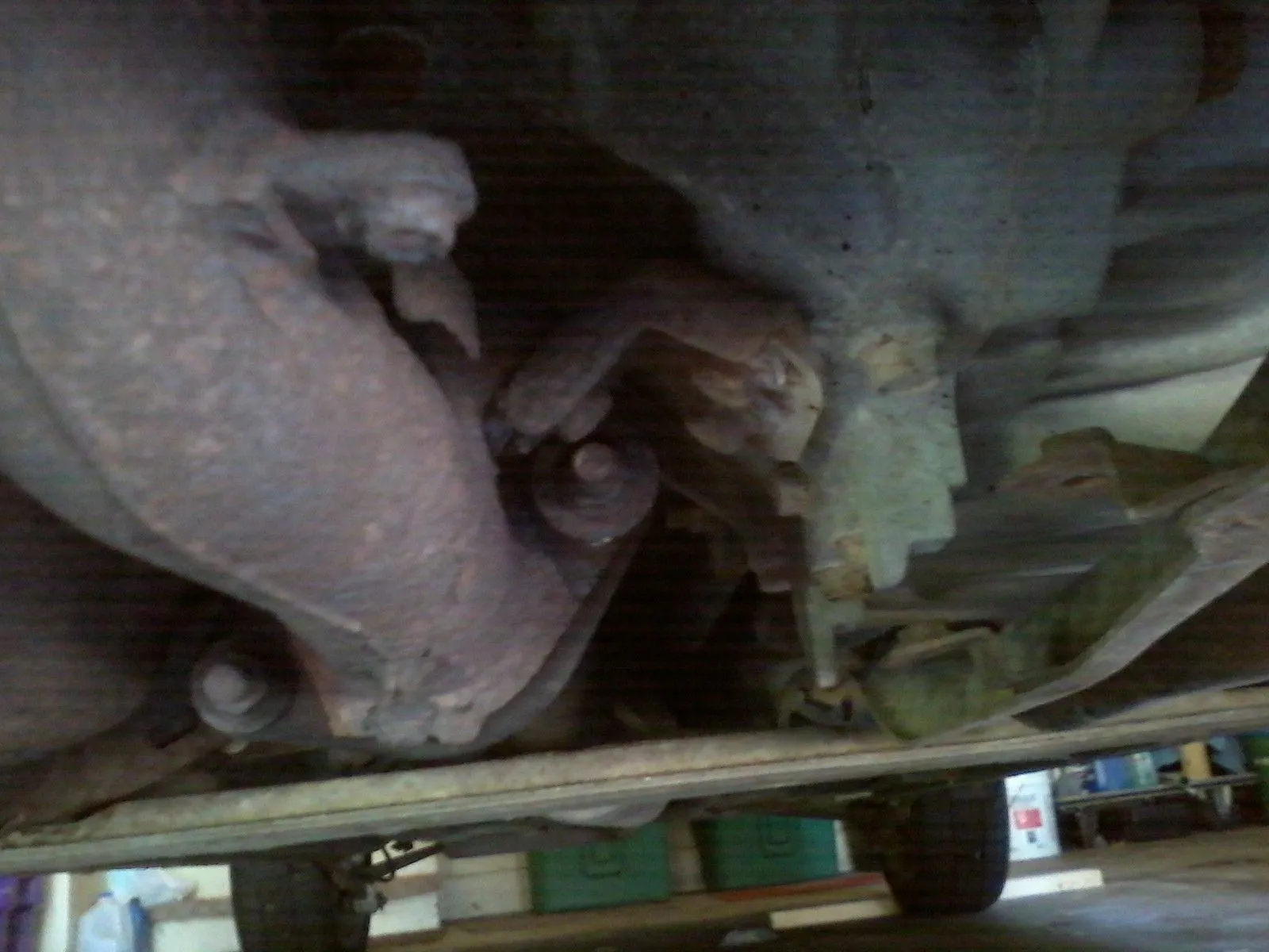

Well, I finally found the (or one of the many?!?) source(s) of my rattling after about 2 months of being driven crazy at stoplights holding the gas so it would be quiet! I'm having the same problem as iainmcphersn tho, where it rattles when I hit somewhere between 2500 or 2800 RPM. Mine turned out to be a j-pipe that rusted so bad it actually severed itself from the rest of the exhaust around one bolt and was loose! How it happens on one side but not the other is beyond me, but it makes the same sort of rattling when I hit it with the rubber handle of a hammer. Anyone know of anywhere besides the overpriced dealer where I could get one to replace it myself? And is it really called the j-pipe, or is it something else? Not to be nit-picky, but when I looked at it and searched Advance Auto Parts, their j-pipes were literally shaped like J's and mine's more like a funky L.
Here are some pics of what mine looks like (sorry, they're not the greatest quality - My phone camera sucks). You can clearly see where the part is severed near the one bolt on the left and suprisingly not rusted almost at all. Does this mean the previous owner tried to replace it (I just got the car 4 months ago) or just that something broke off:
This is where it was severed/broken/whatever the heck happened there:
This is the whole part (notice the ridiculous amount of rust for spending the first half of it's life in Florida before moving to Minnesota):
And the other side specifically:

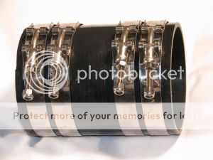

If it were me and you don't mind doing a "Jerry Rig",.. I would cut both of those flanges off and install on of these:
Chances are really good you'll end up having to replace a lot more than you realize if you do it the "proper" way just getting the broken piece out. You may end up replacing the entire exhaust system.

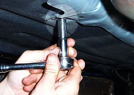

I had that exact thing happen to me. The bolt goes into a weld-nut on the other side of the body and it gets so rusty the weld breaks instead of unthreading.
I was trying to get underneath it to acces my P-Brake cable and shifter for service and wanted to keep the shield in place to help keep dirt and water and even heat off those parts.
I ended up cutting slots in the heat shield from the bolt hole to the outer edge with a rotary tool and the bolts were loose enough to slide the shield out from under the bolt heads. The shield has enough give to do this to each corner then I could move it out of the way to access the shifter and cable.
When I went to reinstall it I slide each corner back under the bolt heads then used some mechanics wire to wrap between the bolt head and shield to stop any rattling.
I've had the shield on and off a few times already since and reinstalled it with new wire easily.

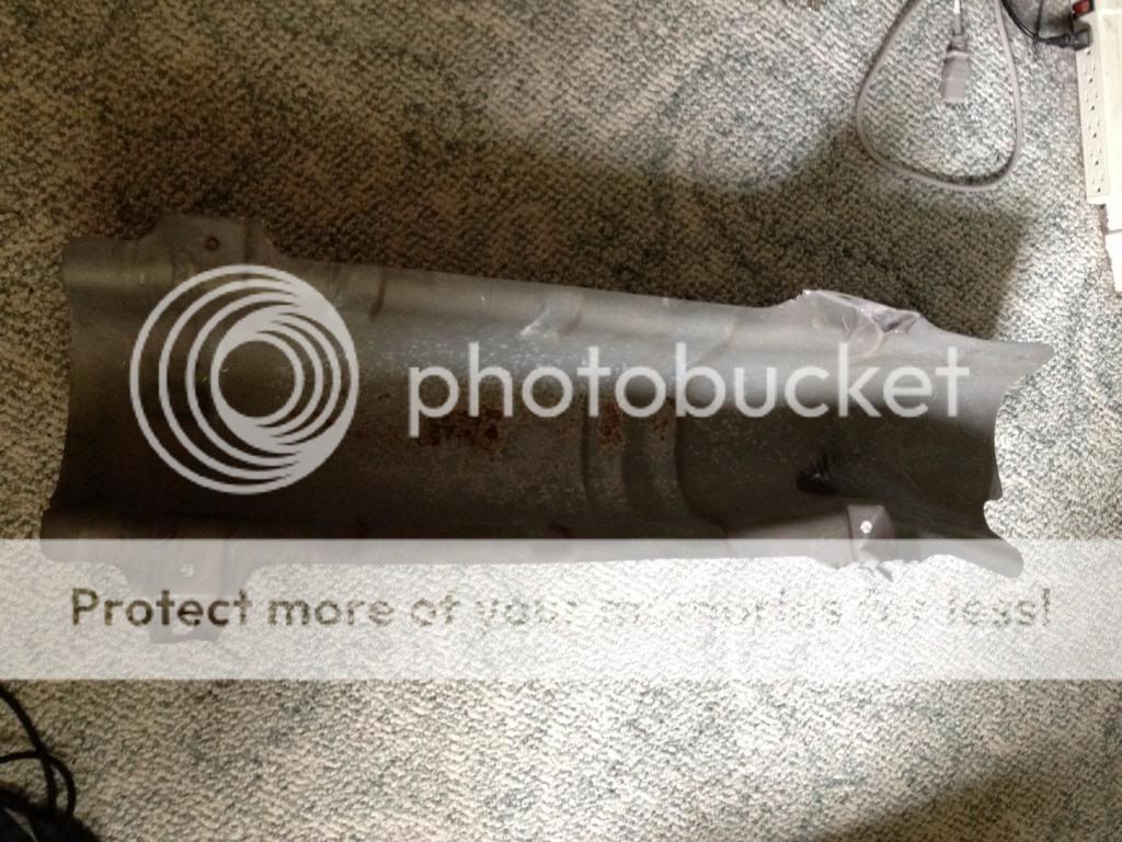

when installing my TWM short shifter I had to remove the same nuts to put spacers on the heat shield... broke off the same as previously mentioned in the thread (now i know this... thought it was just me haha)
so instead of trying to fix it just for a damned heat shield and 1 inch spacers, i took a sawzall and cut it off... and didn't spill my beer in the process
here it sits in my room, 3 out of 4 sides were cut with a sawzall, the other one was forced out by some serious prying.
It's been a month and no problems, although people have said they have been running it for 3 years + without a heat shield and no problems
I would, except I have to drive my car delivering pizzas, and my manager wasn't happy when he heard the noise my car was making. And I don't own something to cut those flanges off. But hopefully I don't damage anything else. I actually got sick last night after driving for some 6 hours. On the slightly bright side, though, the other flange on the front pipe snapped as well, so that should make it a little easier to take off. Let's hope I can finish this in an afternoon without too much trouble.....
