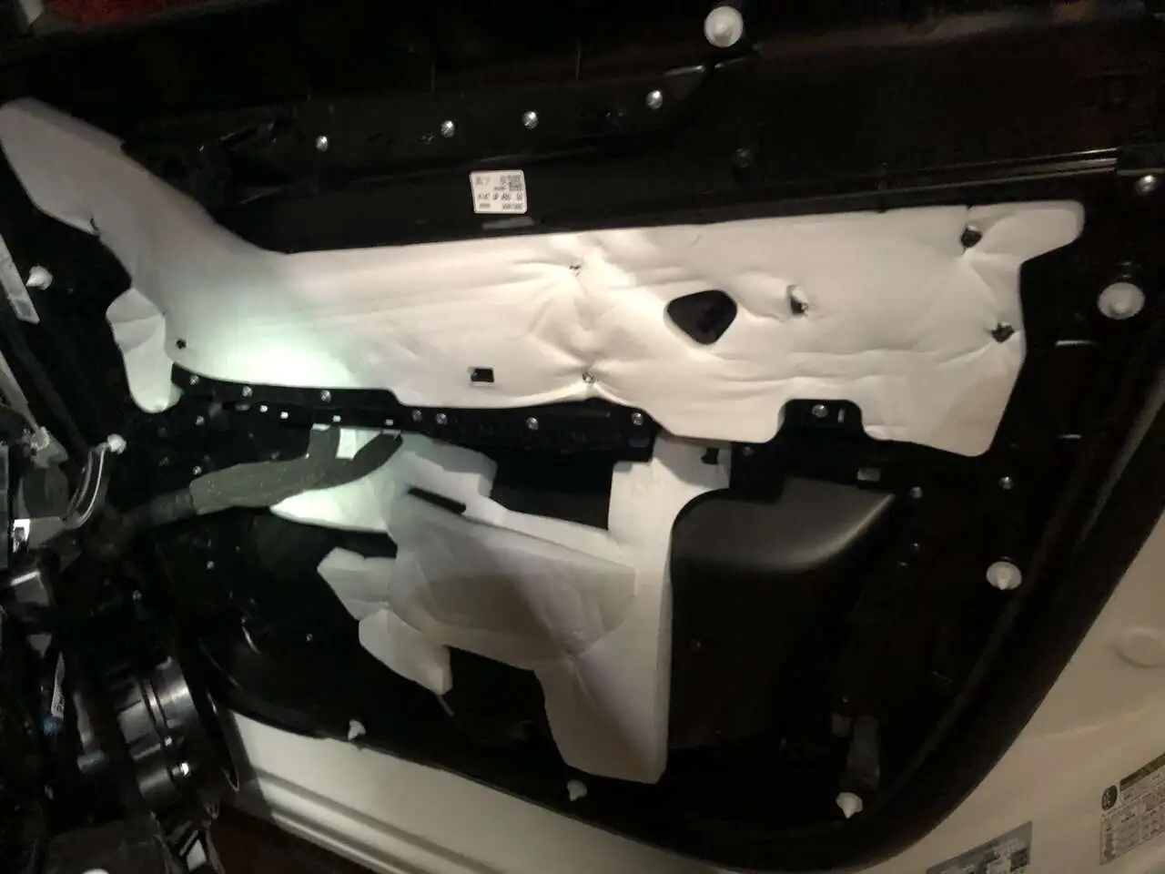

I , couldn't take wondering if it pooled inside the door-card - so , I pulled the door-card off, and checked the area - and it didnt pool anywhere or get the speaker wet etc .
Then - I took photos of the inside of the doorcard , and door :
Left photo is door-card-(door panel) ----Right photo is the door itself
- There is no yellow glue substance or other that would melt etc - my friend , Im going to say again, something ( yellow ? ) must have spilled into that cupholder and did exactly what happened to me - You can pull the door-card yourself and check - You need a few basic things -
