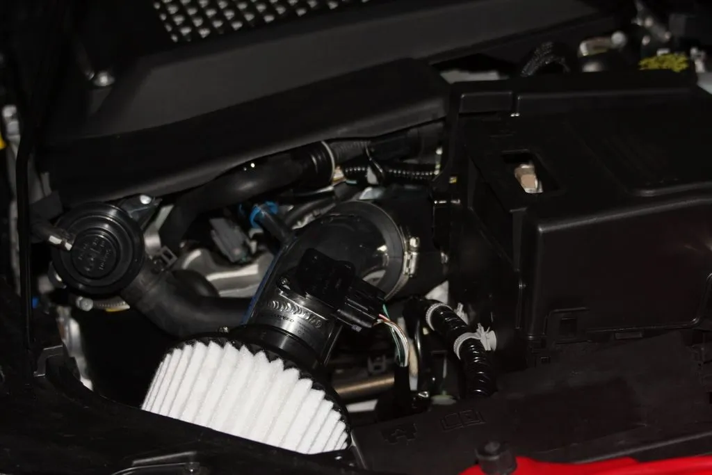

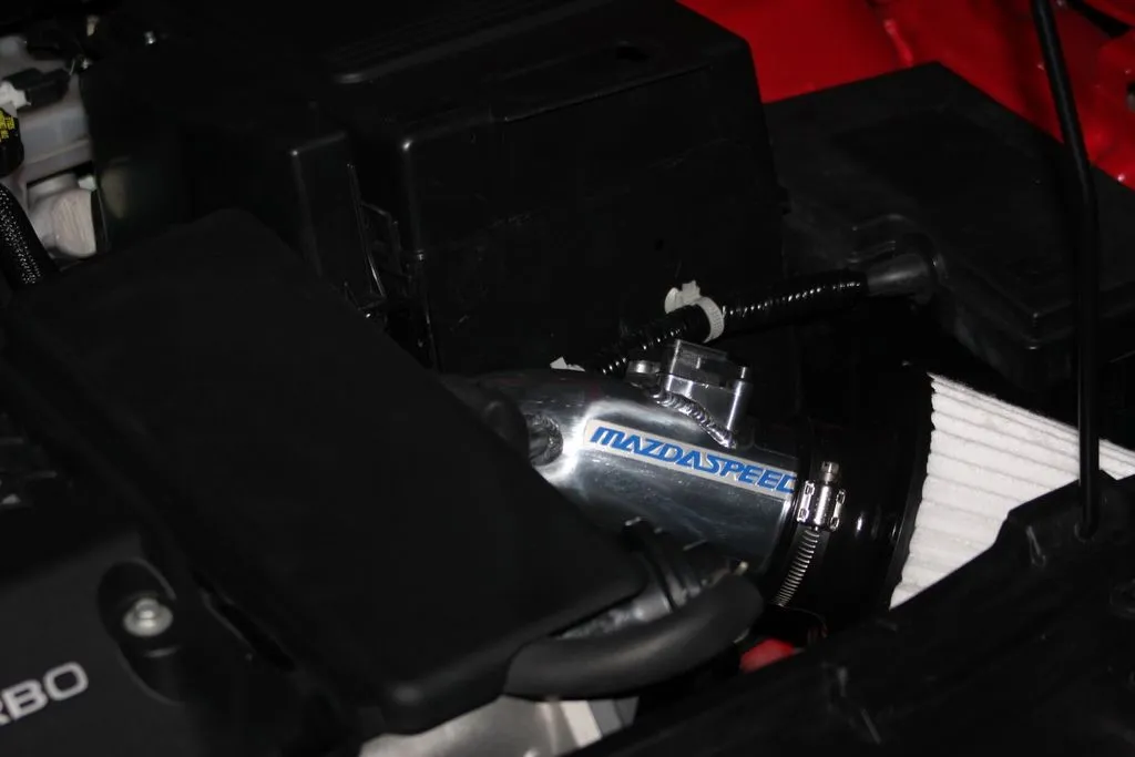

After getting tons of help from this site, I figured it was about time to give some back. I did two things to my car that perhaps aren't really that common, so I took a few photos to help everyone out.
First of all (more common), I installed the mazdaspeed CAI as a short ram instead of the CAI. This is ridiculously simple. Sorry for the dark photos (it was night), but really, it couldn't be easier. You get the nice intake sound, supposedly almost the same hp gains, but a much simpler install, no worry of hydrolock and a more accessible filter.

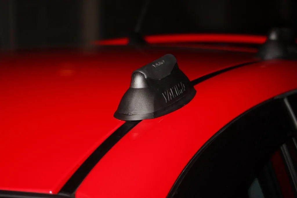

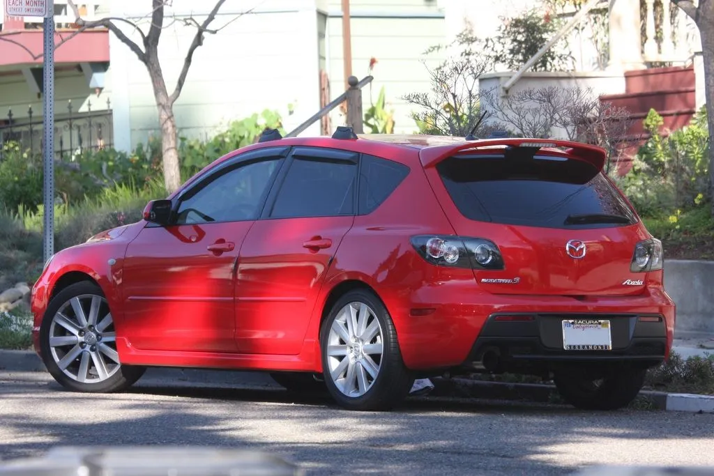

Secondly, I put yakima landing pads on my car. These mountings screw directly into the threads hidden under the roof rails. This lets you attach a yakima roof rack without having to use hooks under the doors. It is pretty easy, but you do need to remove the roof rails and drill a hole in them to access the mounting points. Once you do this though, you just screw the pads in and you're good to go. Now that I have the pads installed, attaching my rack takes literally 15 seconds (I timed it). No tools just snap them in and go. I would highly recommend this route if you're putting a rack on your car. it's a much more solid attachment point.

yeah, this is the exact reason I put those pictures up there....it's not really obvious what you have to do.
so, you have to remove the roof rails. It's really easy, just take a flat head screwdriver and pry it up starting from the rear of the car. they just pop off.
once you pop off the roof rails, you'll see the attachment points that you need to screw into.
now, just mark on the roof rails where the holes need to be and drill out the rails. this isn't super easy as you want to make sure you get the hole location right.
then, just pop the rails back on and screw in your control towers. makes for a much simpler, stronger, cleaner installation. if you're freaked out about the fact that you have to drill holes in the roof rails...don't be. they're only like $150 for a set, so if you want to replace them with virgin ones it's not the end of the world.

OK, so I decided to go with a roof rack. Actual MSRP of the rack with one bike tray and air deflector is around $550. I got all the parts except for the landing pads off CL for $180 and bought the landing pads (2 pair) for about $50 from REI (sale plus dividend).
Installation is pretty easy. The trickiest thing is getting the holes lined up correctly for the bolts. I also used the short M6 bolts although the instructions say to use the long ones.
If anyone is looking to get the same rig from ebay or CL, you need to look for the control towers, not the Q towers (those are used for clips), 48" load bars and LP11 landing pads.
