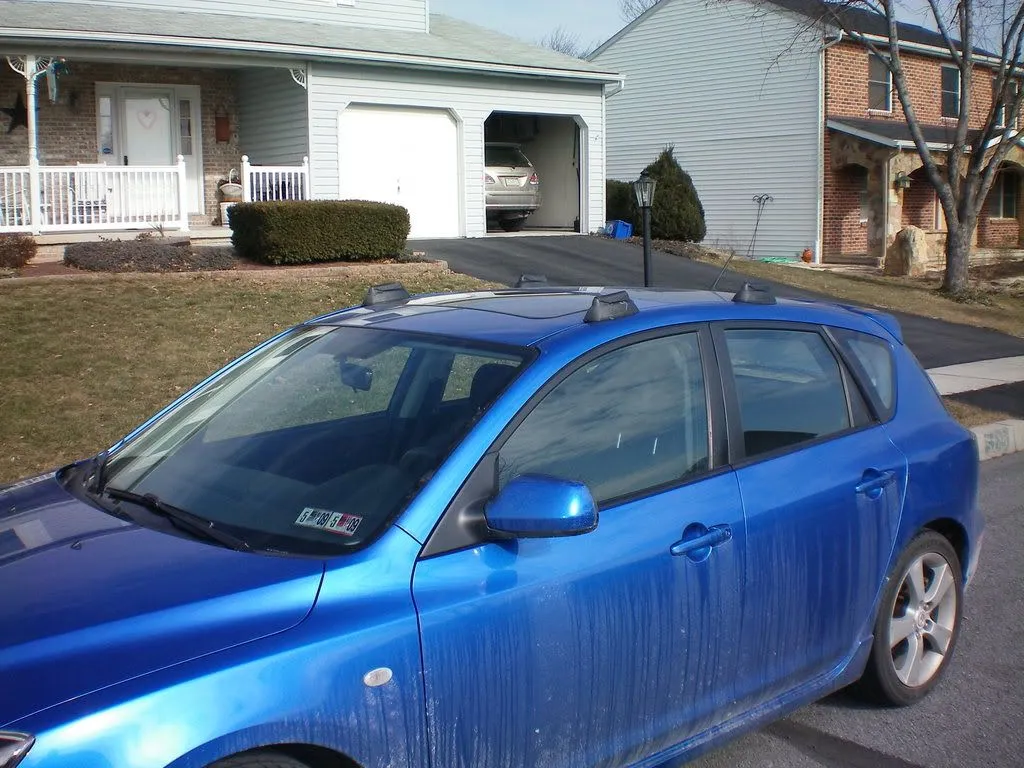

Yakima finally worked out the roof rack
wondering why rear towers had to be above door
I'd feel better about buying this setup (i too have some bits i could reuse), if they'd've been able to put the rear towers/clips hooked in the gap at the top of the rear(fixed) window. I'm considering how to carry canoes and the farther apart the crossbars can get,I think, the better. I believe on yakima's site they list only 32"; which is about the same as the measurement between the factory rack mounting points.
I had a 'lightbulb moment' and scurried down expecting to find that the sliding door would hit the tower/clip if it was attached above the fixed window, but it sure looks like there's plenty of room to clear.
I guess going with the q-towers would make install/removal more convenient, as I prefer not to run around with the rack on if I'm not hauling anything.

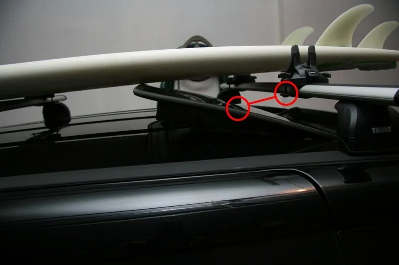

Thanks but on 8-12-08, the user Distinct from an msprotege forum (not sure if they're the same forum now) posted this pic showing a Thule 460 Aero and how the sunroof hits the bottom of his attachment screws and his surfboard. I wrote above that I need full sunroof operation (what did I buy it for?). That's why I'm thinking about moving the rack towers as far back as possible to prevent any sunroof contact. In addition, I have leftover Yakima attachments that I wanna use.

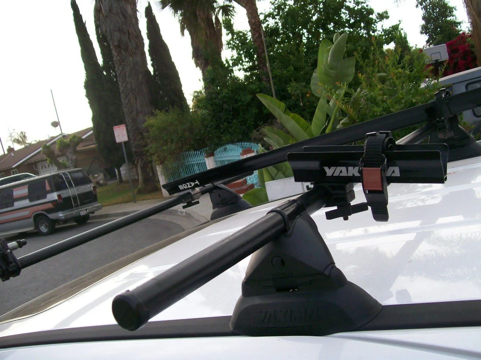

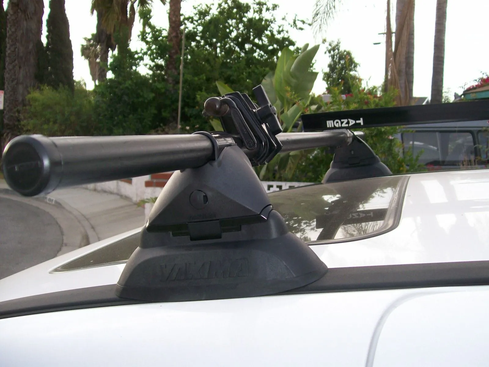

Alternately, has anyone looked at using Yakima Control Towers and Landing Pads on the Mazda5? This setup would utilize the fixed roof attach points just like the Thule 460/460R. According to Yakima, the 5 doesn't have compatible Control Towers/Pads but the Mazda3, CX-7 and CX-9 all use Landing Pad #11 and it's a single bolt per pad just like the 5. Has anyone attempted this? Maybe the rubber pads aren't shaped properly for the 5's roof but IMO that's a relatively minor alteration as long as the rack mount points are strong and secure. See below URL for install of pad #11.
http://lib.store.yahoo.net/lib/orsr...pad-11-lp11-installation-instructions-pdf.pdf
After checking the Thule fit guide, the 460/460R towers and 3069 fit kit fit the Mazda5, CX7, and CX9. They recommend the clip style for Mazda3. After checking the Yakima fit guide, the Control Towers and Landing Pad 11 fit the Mazda3, CX7, and CX9. They recommend the clip style for Mazda5. Wait a second, why would Thule approve a system for fixpoint roof mounting for the 5 but Yakima wouldnt? After careful research, I was convinced the Control Towers and Landing Pad 11 will fit the Mazda5. The only thing I was concerned with was sunroof clearance but that doesnt seem to be a problem either. I get to reuse my old attachments so out-of-pocket was less than $200. Unfortunately the fairing rests directly on the sunroof so Ill go without it as Ive done in the past.
Honestly, after seeing how solidly this system mounts and holds my bikes (already went on the freeway at 75mph) and the fact that I can fully open my sunroof, I have absolutely no idea why Yakima didnt approve this system for the 5.

I wouldn't call this a complete success but it suits my rack needs perfectly. I've never really used fairings before so I'll just continue to endure the windnoise. And the sunroof is slightly "domed" and higher in the center so surfboards and boxes still might hit. From pics I've seen of the Thule and OEM, this Control Tower setup is slightly taller than the Thule 460 and slightly shorter than OEM. Once again, I wonder why Yakima didn't research this solution. Door clips suck and the 5 has been out for almost 4 years...
Yes, Control Tower fixpoint mounts are a better option than Q clips. But I also don't wanna assume that I figured something out that the Yakima research team didn't. Maybe this setup will damage my roof in the long run or void the warranty or whatever. All I know is that I needed a bike transport solution, I don't like door clips, I like opening the sunroof, and I have old Yakima stuff. In addition, it just seems logical that if the exact same Thule system fits the 5 and CX7/CX9 that Yakima's CX7/CX9 system should also fit the 5.

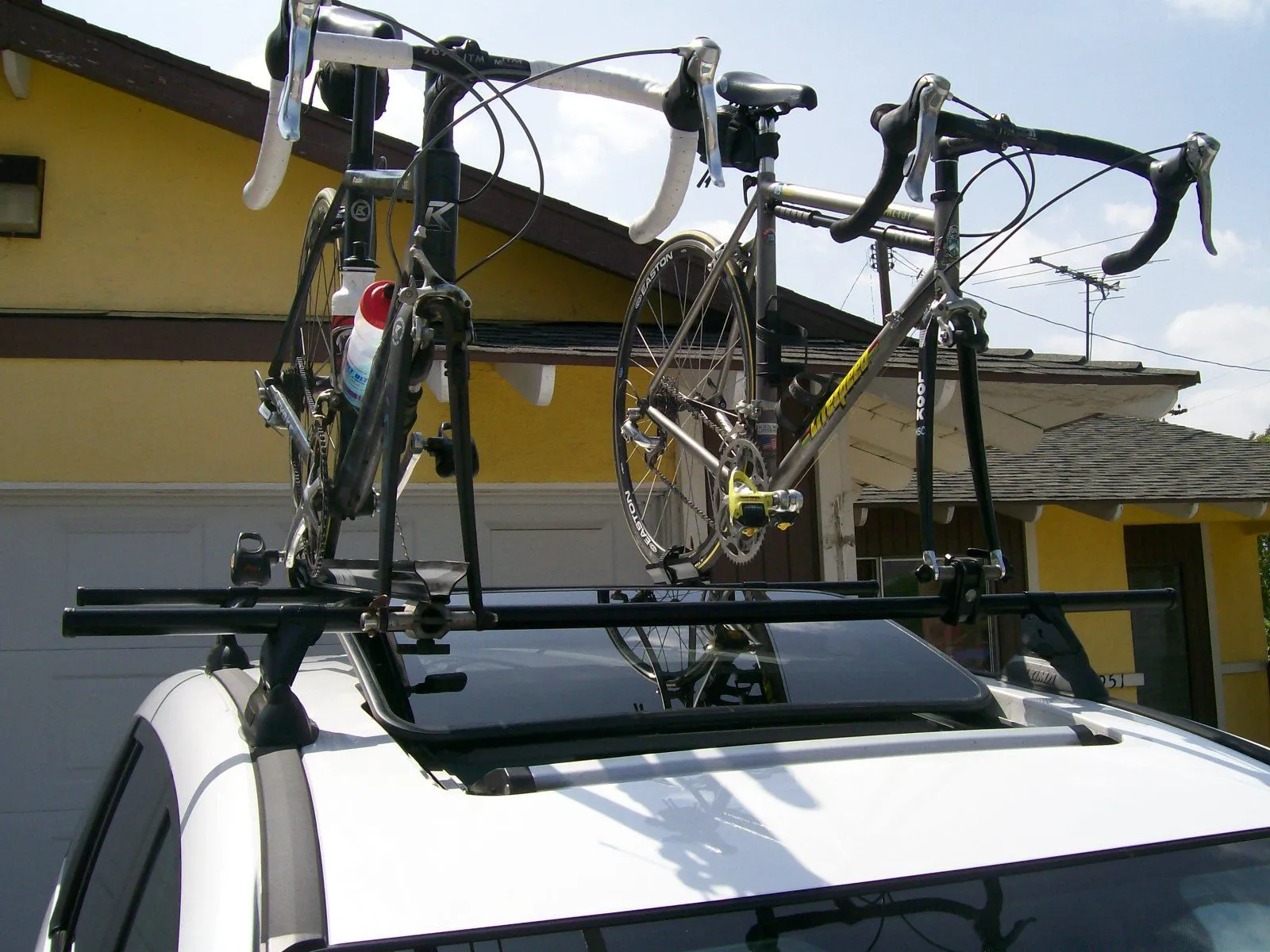

I included a pic of 2 road machines up top. There's enough room for 1 in the center and possibly 2 more on the ends. Let me know if you want any measurements of my setup, in particular sunroof clearance as you had asked about in your previous posts.

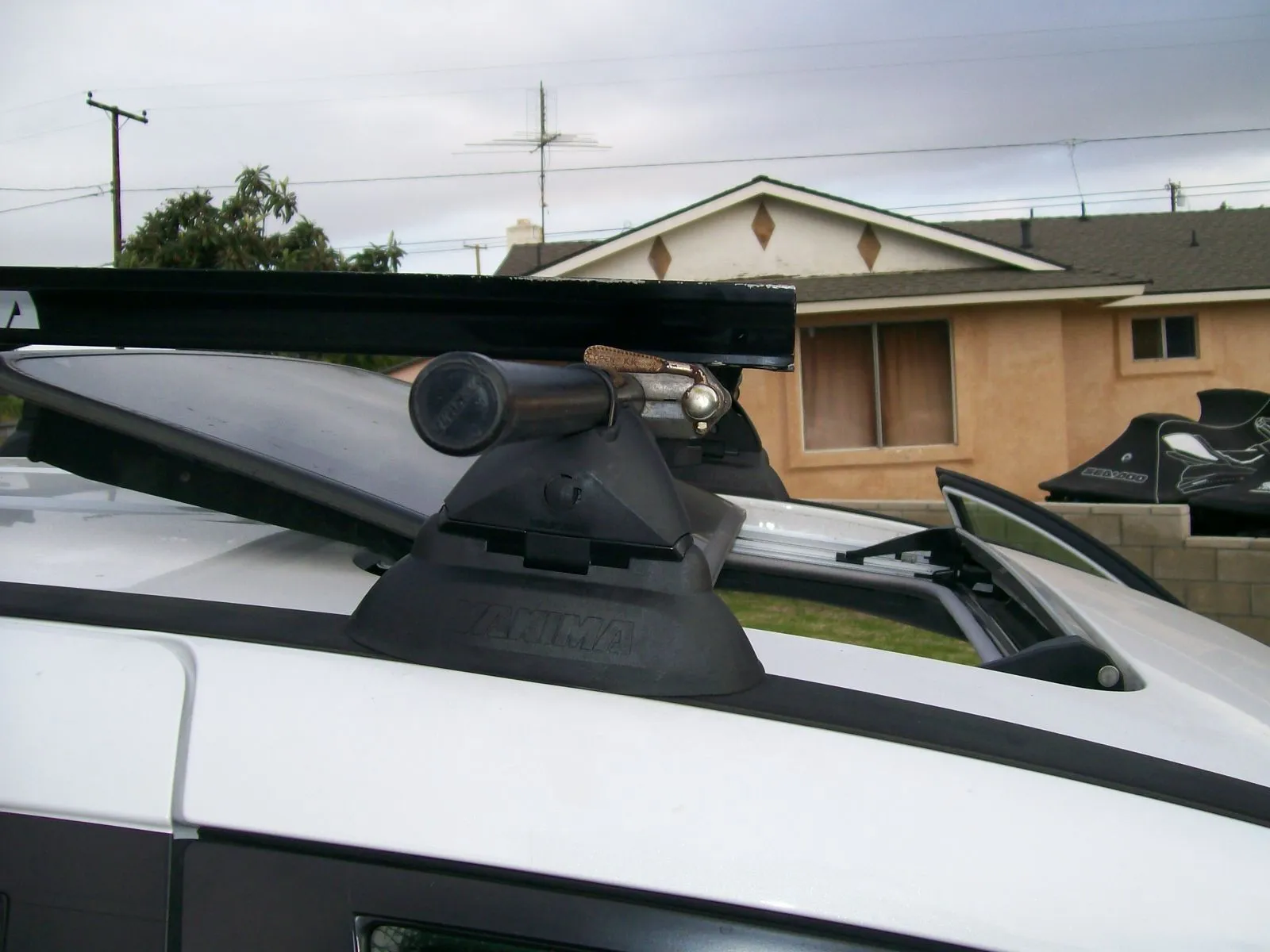

2nd question first, see below URL, about 2/3 of the way down the page, user SaDrago has a writeup on the exact same Yakima setup on a Mazda3. He has great pics on what the Landing Pads looks like with the Control Towers removed.
http://**********************/index.php?topic=7432.msg2891177#msg2891177
Landing Pads are screwed into the fixpoints with a single 6mm bolt each. The 4 Control Towers (along with the bars and any attachments) can be detached from the Landing Pads in literally 2 minutes and the Landing Pads have plastic snap-on covers. You don't necessarily have to unscrew/remove the Landing Pads but your car will look funny if you leave it on without the rest of the rack on.

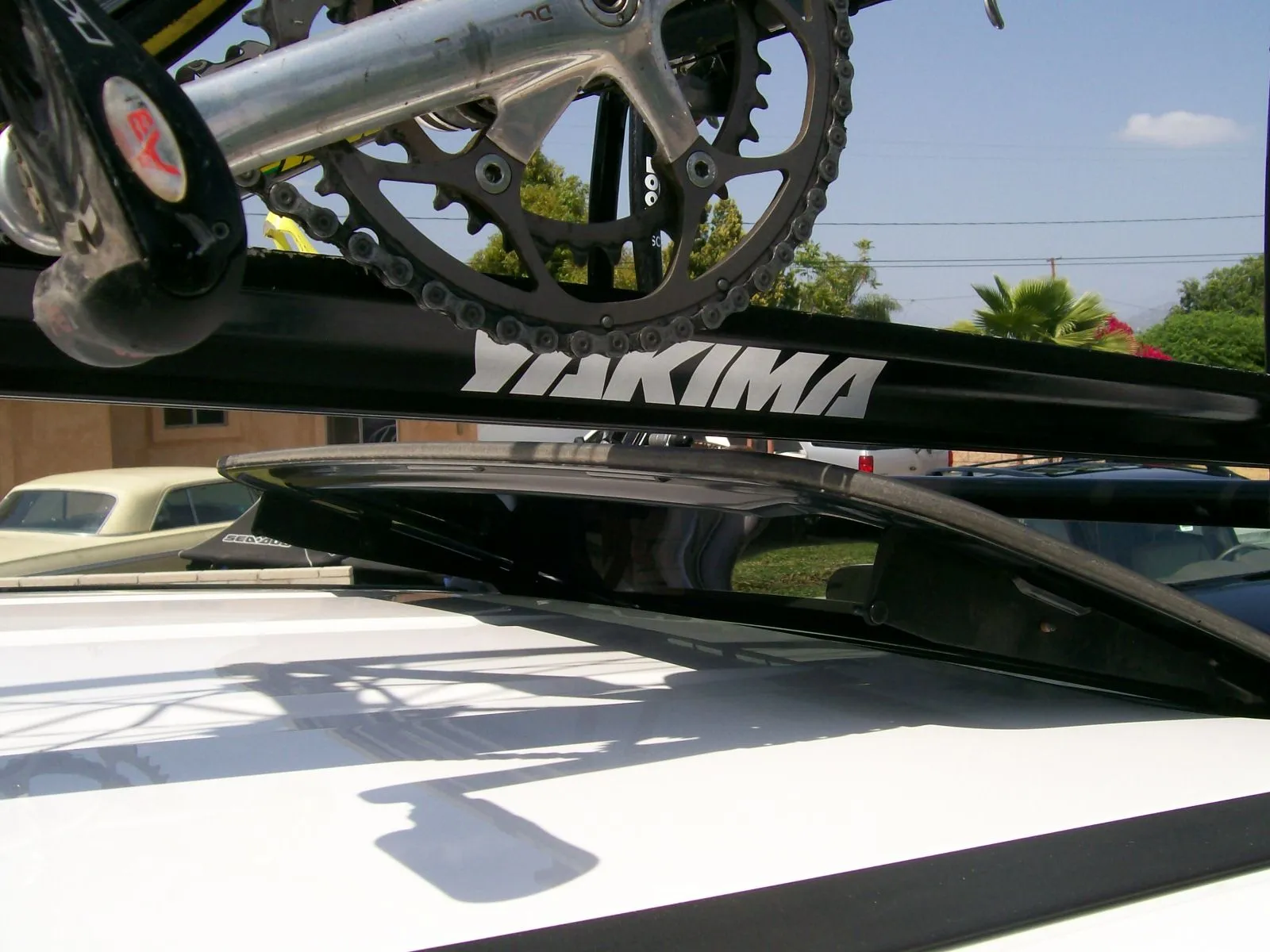

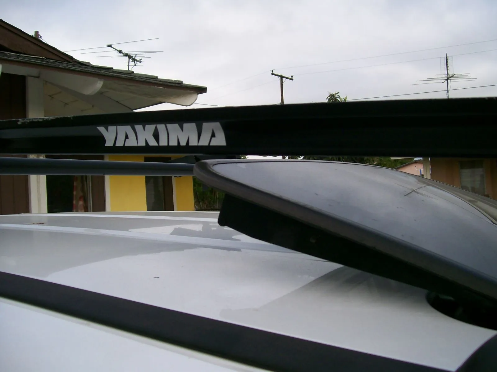

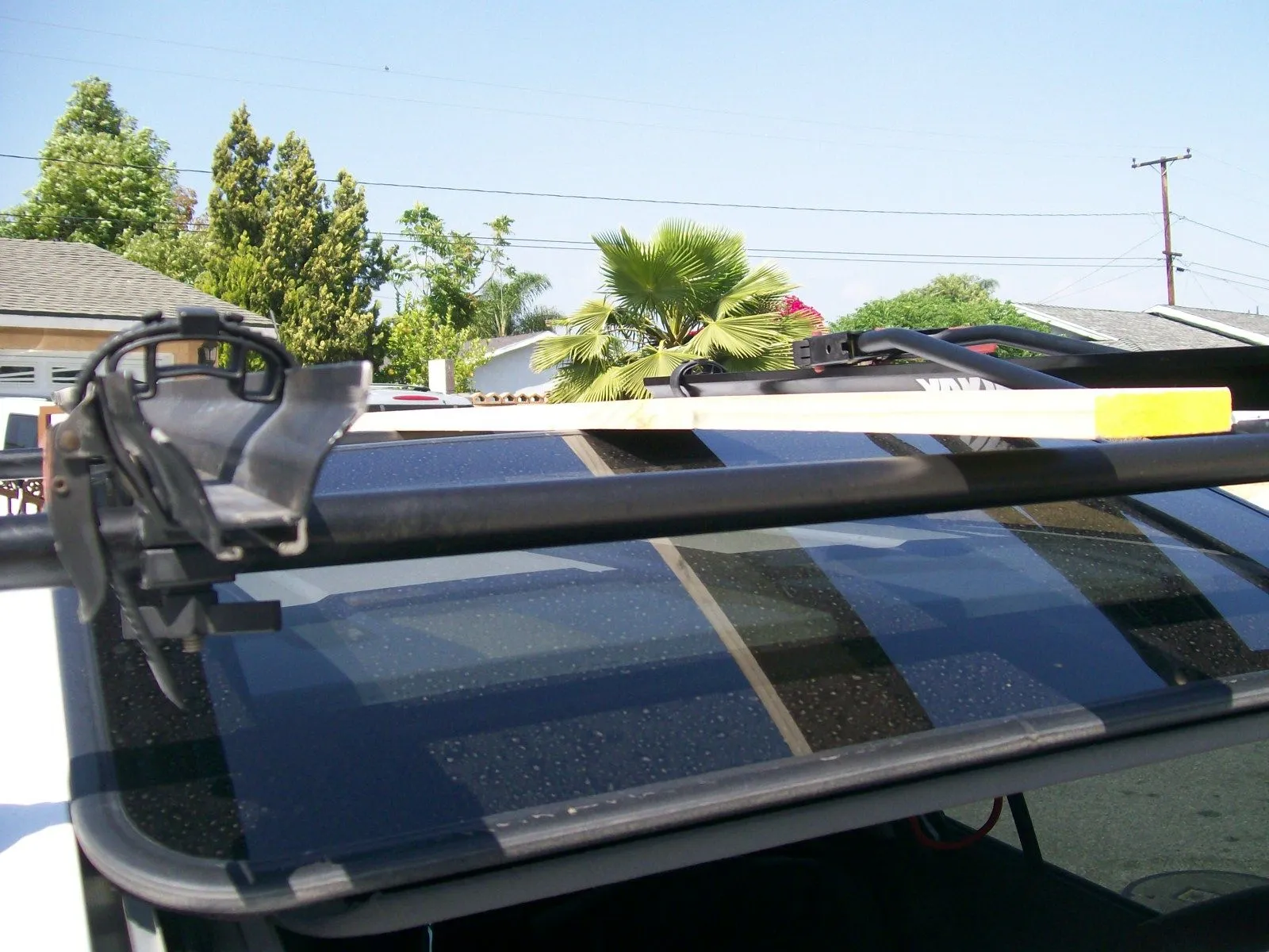

Now your 1st question, it's tough to measure but the clearance seems to be just under about 3/8" (see first pic). Also consider that I use an older style Steelhead, the type with an open ended tray on both sides. Because of this, the tray sits above/higher than the fork mount (see second pic). I believe the newer Yakima fork mount trays are integrated and are therefore "lower profile" and *could* hit the sunroof. Lastly, I laid a 1" x 4" piece of wood down the center of the rack and opened the sunroof and it definitely hits (see third pic) and lifts the front of the wood about 1/2".
Having said all of this, since you only have 2 trays, you can always attach them on either side of the open sunroof (inside of the towers). If you want to attach 3 or 4 bikes, you'll likely have to utilize more of the center portion directly above the sunroof (or even the space outside of the towers). If it were me, I'd opt for using the Boa attachments over the center (no tray necessary). We're literally talking about millimeters of clearance here and if you find that you need more height, you can also add spacers.
Now for an aside, I opted not to use a fairing because it'll rest on the sunroof but I think I may have figured out a way to use it and I don't think it'll look that bad. Essentially, I'll be adding a third crossbar without clips or towers and the third bar will be positioned about 6" in front of the front crossbar. I'll attempt this setup within the next week...
