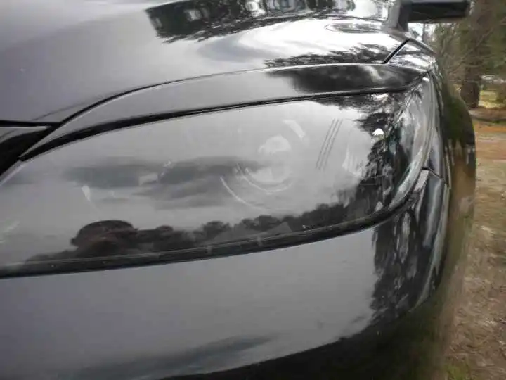

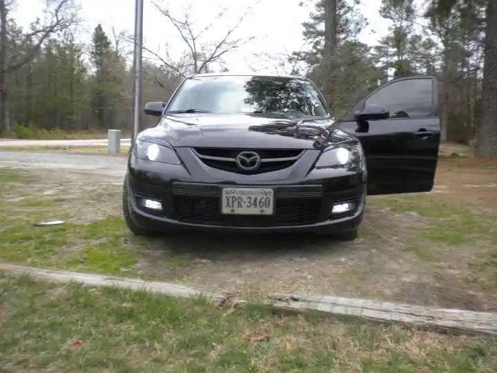

Blacked out chrome rings, removed amber lense, and installed trs clear lenses
blacked out all chrome and reflector

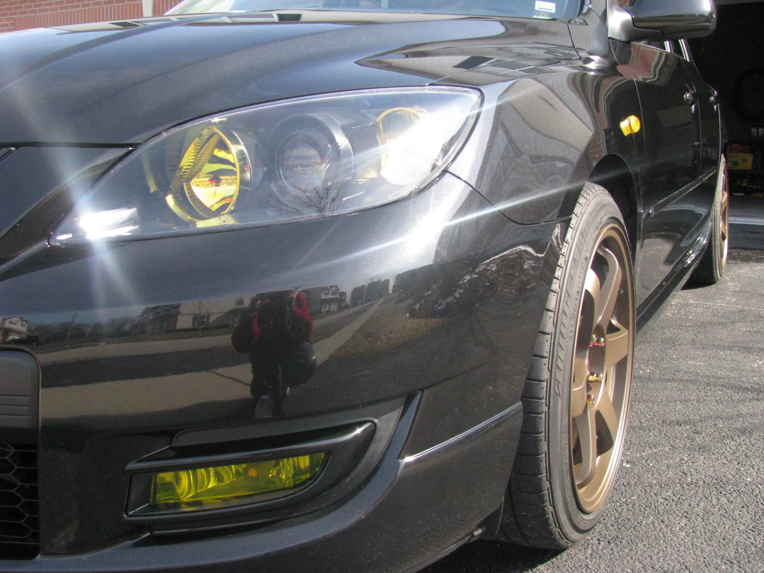

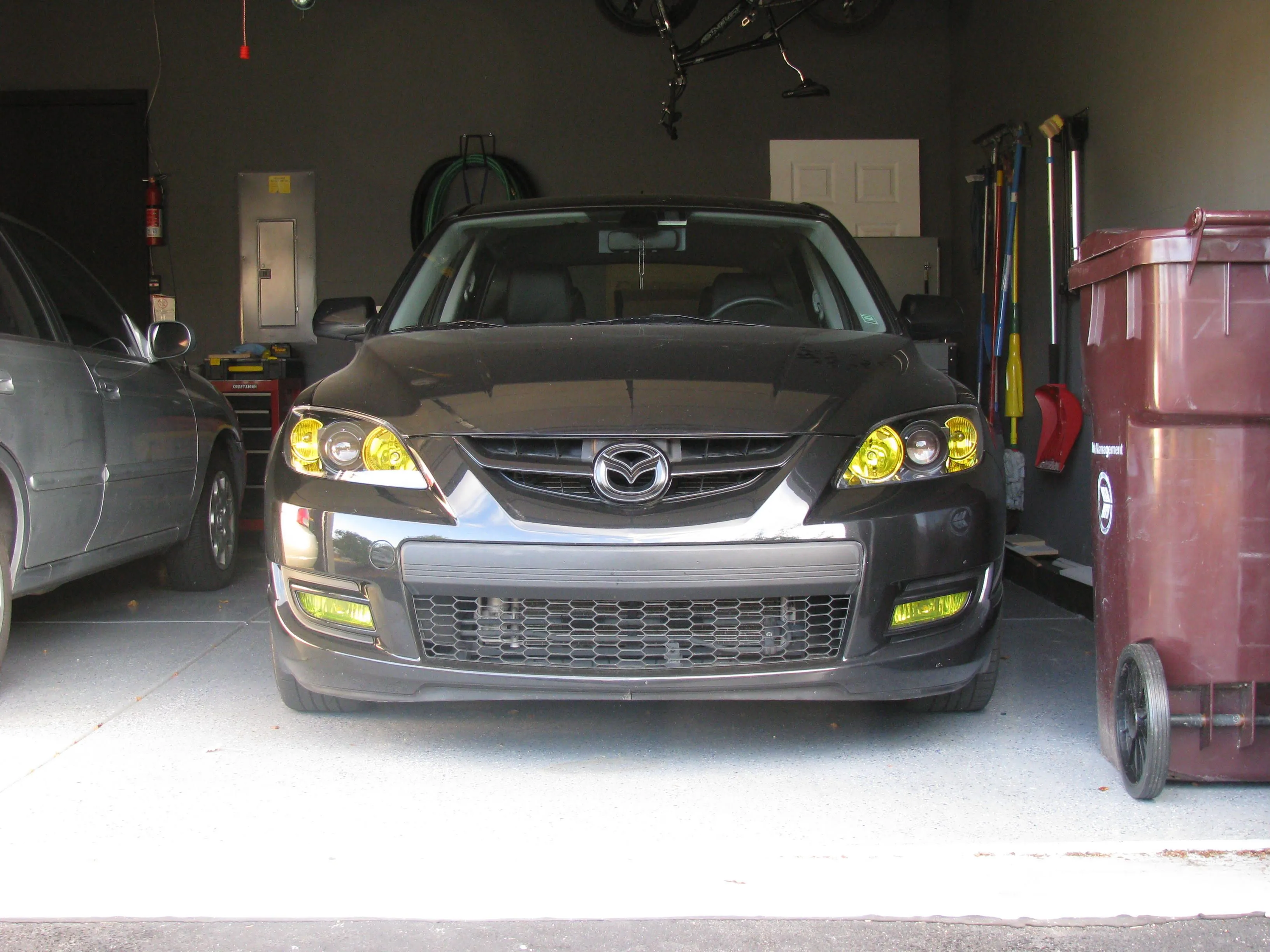

its really easy i used a hair dryer and butter nife it took like 20 min to do both them. the front bumper removal and head light removal about 30 min. trs lenses are easy to put in once open two screws and they are swaped.

nope just baked and rattle-can the chrome and reflectors black.
OK, stupid question from a noob... but exactly what does this mean?
Baked means put the headlights in the oven or you can you heat gun/hairdryer to remove the outer lense which loosens the factory adheasive. Rattle can means spray paint. All those chrome rings and the amber lense come apart from the housing when you take out a couple screws and pry out. If anyone wants me to do these shoot me a pm. and there is already a guy on here that offers this service and has proper av status. Matt V I think is his name but to be honest its really easy to do your self. Buy the TRS lenses and do the swap if your goin to bake them since they are already open. I was gona put led strips in mine but Im pretty sure the leds burn out often and I wanted this to be a one shot deal. So far no fog in mine been through the rain and pressure washer just use a proper sealant.

If you use a hairdryer or heat gun you save alot of the BS like removing the HID bulbs and have more control over the heat. A extra set of hands can be helpful when prying the lense off and putting the heat where you need it. Take your time and you cant go wrong!(first)
TRS Clear Lens Swap w/ Color Modding
Chrome Bezels --> Graphite
LED Strip (Inside the Clear Lens)
Chrome Dipped Turn Signals
Yellow Nokya Bulbs
