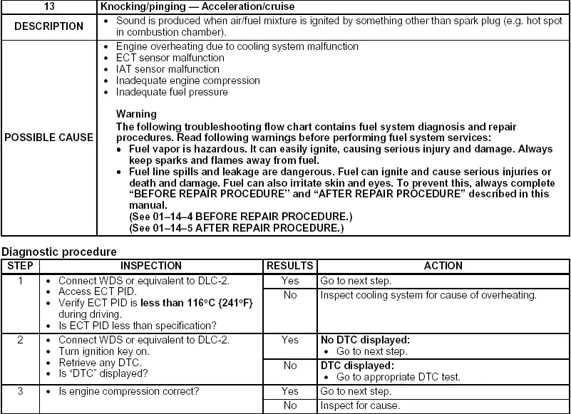

I forgot to post, I dynoed the car with this setup and only made 199whp and 201wtq. I lost alot from last time because I think I have way too much timing out. I never changed the timing map when I went to this setup. Nick say's that the injector control setup advances the timing a little when you clamp the sensors, so I have the timing map for the other way with this wiring. I am going to hook up my J&S and tune the timing better and re-dyno. I don't know how much better I can do because they only have crappy 91 octane out here. Hopefully I can get it up a bit more so you can see the differences between the O2 tuning method and the injector control method.
That is very true about the timing based on IAT and ECT temperatures... Im now running MAP instead of MAF (MAF is out of the car) so I been reading a lot about the ecu and troubleshooting, voltages, etc. And it mentions that ECT temperatures affect ignition timing. And thats why when it clamps you feel a surge in power, fuel and timing added @ the same time.
