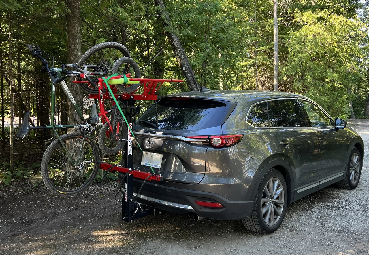

Good bike racks are super expensive, but I'd recommend this one.
Had to MacGyver the pool noodle on the tire basket so I could fit my son's 14" bike (with ratchet straps/bungee).
Held super steady at highways speeds for 4 hours to camping (didn't even notice it back there).

Sorry for the late response;
Lugged it around to a few places camping last year and it's been pretty solid so far.
I've got a Curt Class 3 hitch with a tongue weight max of 400 lbs. You're correct the 412 Max recommends a 500 lbs tongue weight receiver.
I'm not too concerned about this for a few reasons:
1. We do not have e-bikes and will never get one.
2. The 412 Max has an empty weight of 80 lbs with a total bike weight of 300 lbs. Unless I'm mistaken, this means the max weight of bikes + bike rack = 380 lbs; this is under my 400 lbs tongue weight max on my receiver.
3. I have a family of 3 with 2 adult mountain bikes (no fat tires, etc, etc, ie. not heavy bikes) and a small bike for a 6 year old (at the moment). I'd be damn surprised if I even hit 200 lbs with everything loaded.
