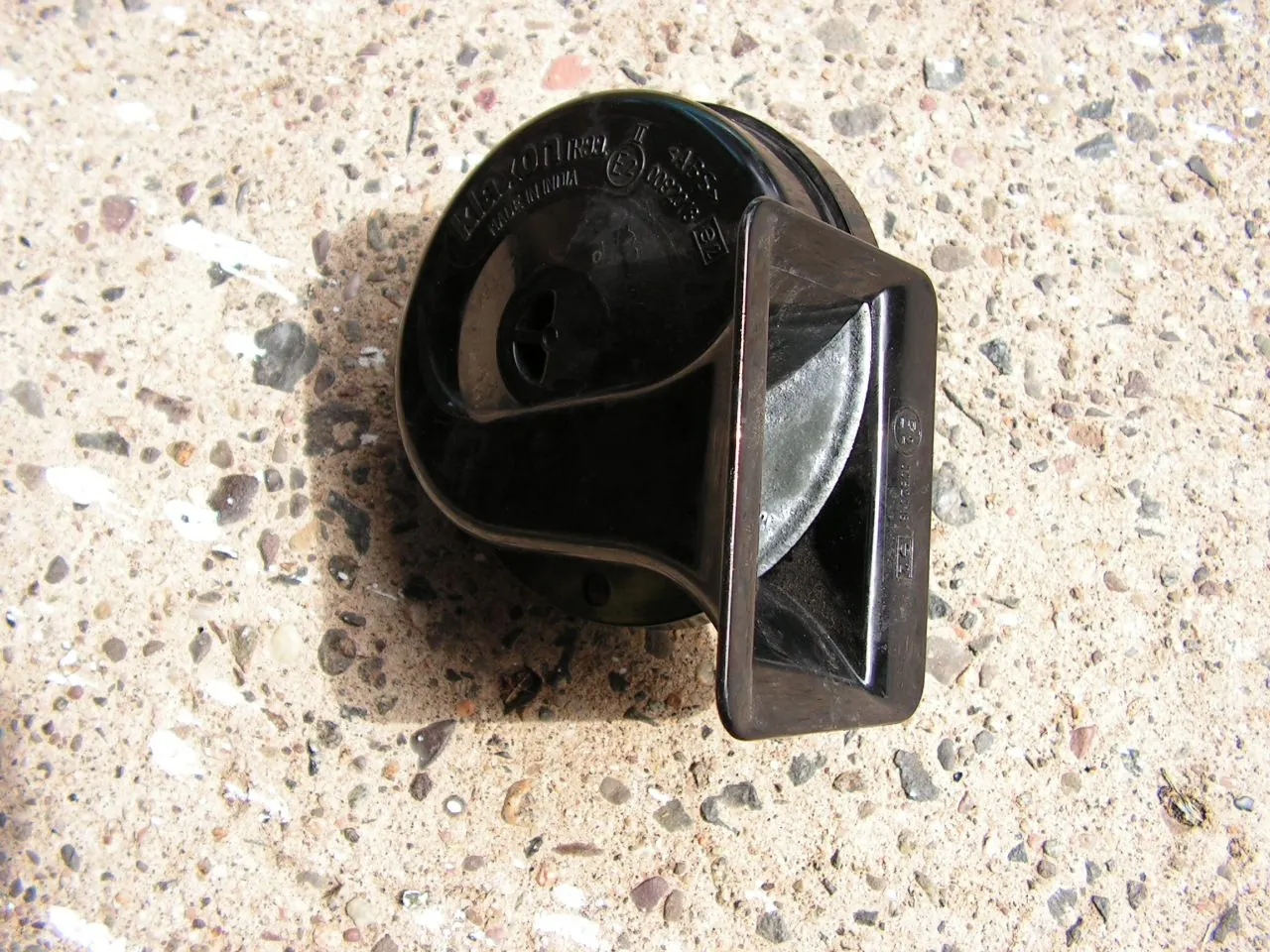

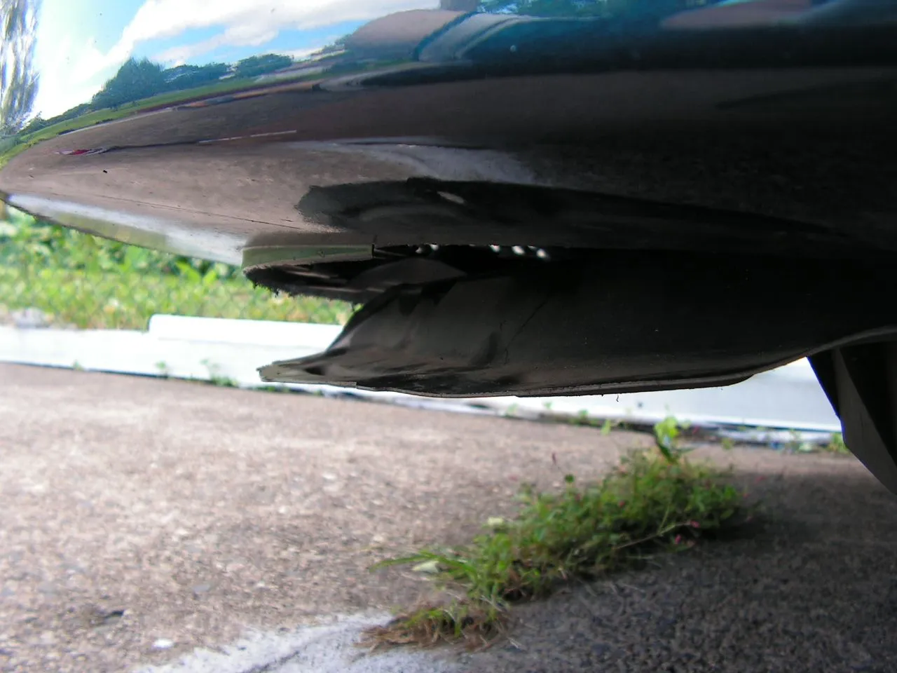

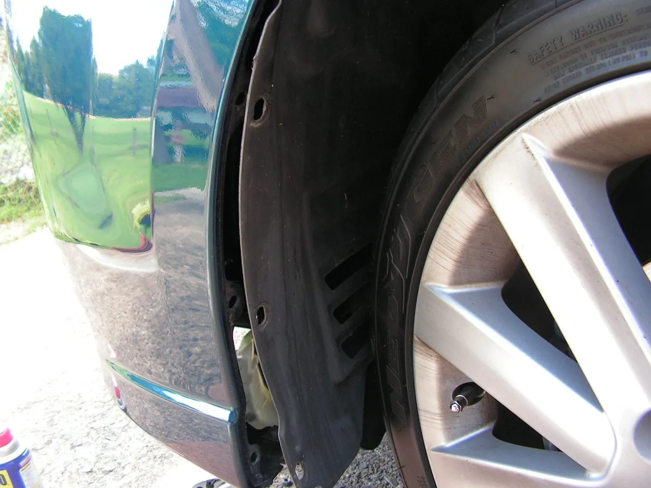

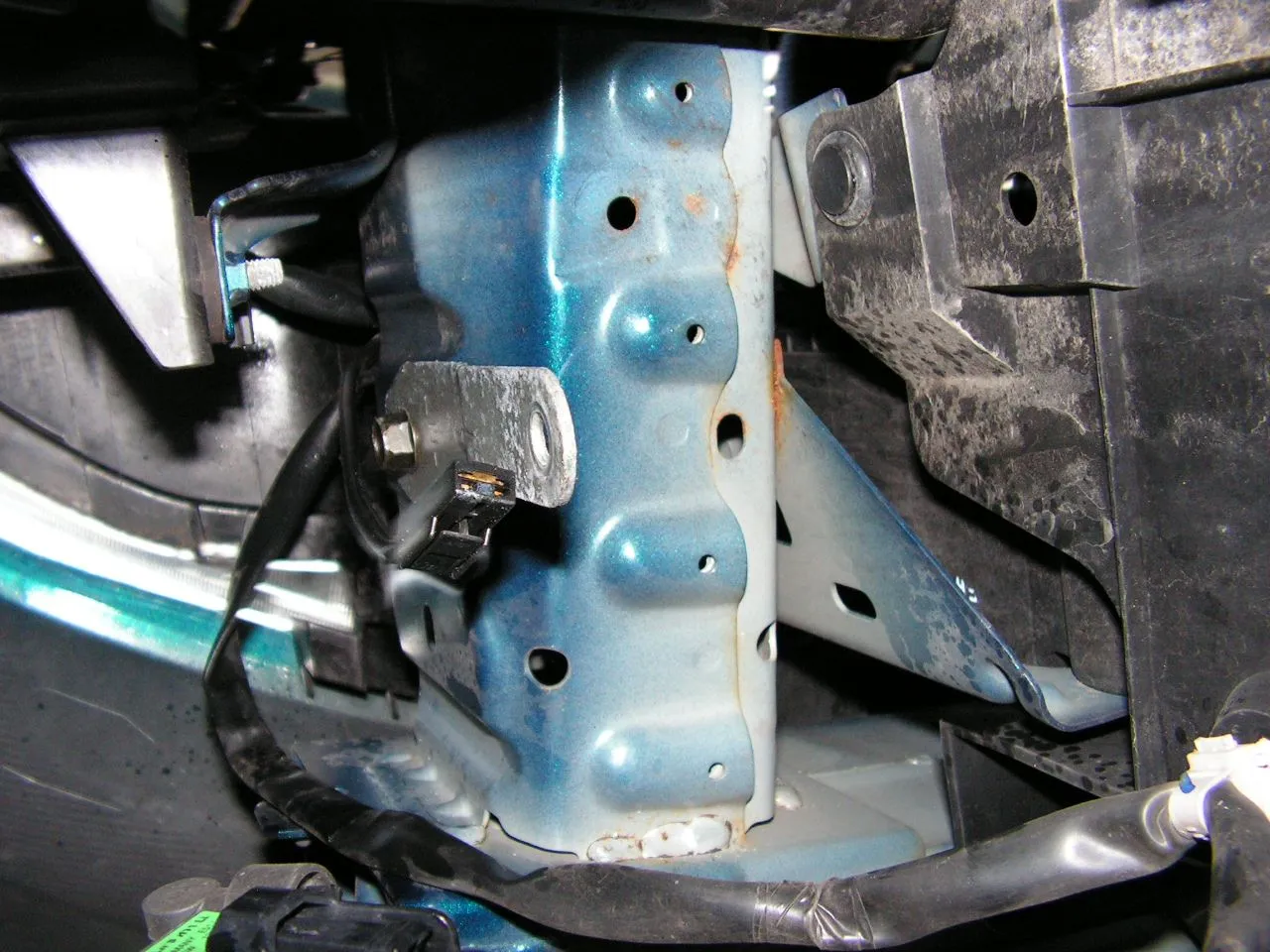

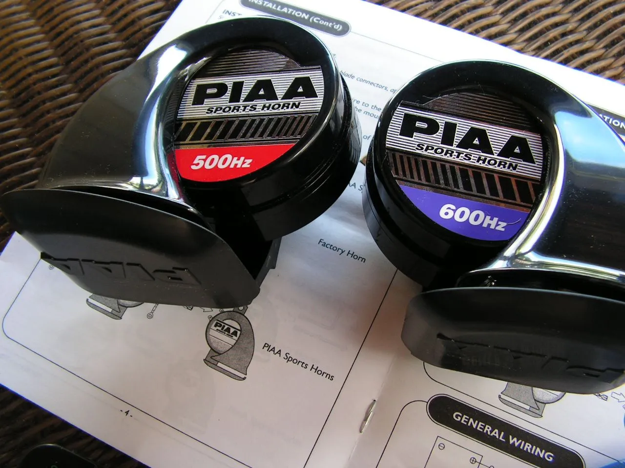

Since i was searching for pics for a while on where the horn was located and didnt find any, ive finally changed mine and took some pics to show others where the horn is. I start by showing the fender inner panel that i removed to access the horn. Then i took a shot from under the car to where the horn is but removed with the black horn wire hanging. Then theres a pic of the old horn, and the new ones. i know this is an old post but it might help someone.

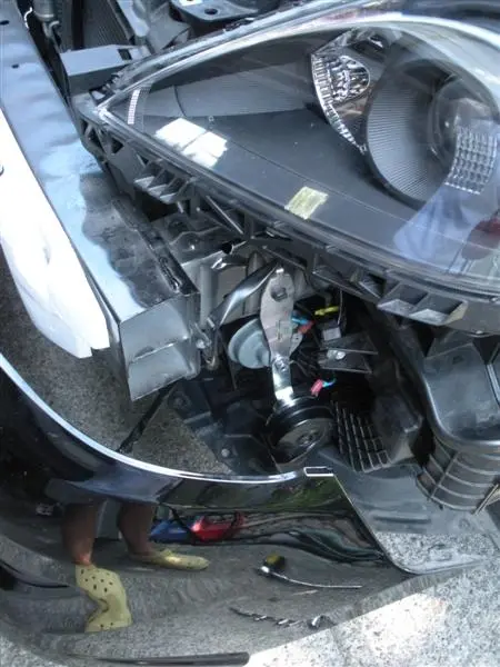

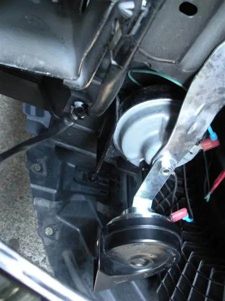

I added a second "low tone" horn a while back and now have some pictures.
I feel removing the bumper is critical so you can see what the heck you are doing. No extra wiring, just added a jumper wire from the existing stock horn to the new low tone horn. Many low tone horn kits are out there for specifically this purpose.
Total cost was about 10 bucks plus my time/labor to remove and install.
michael.
