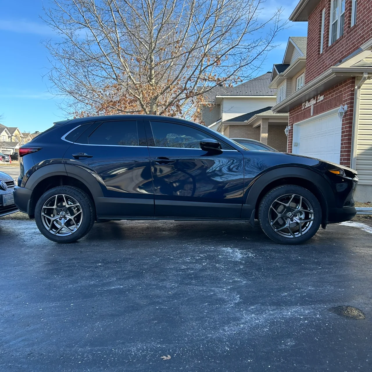

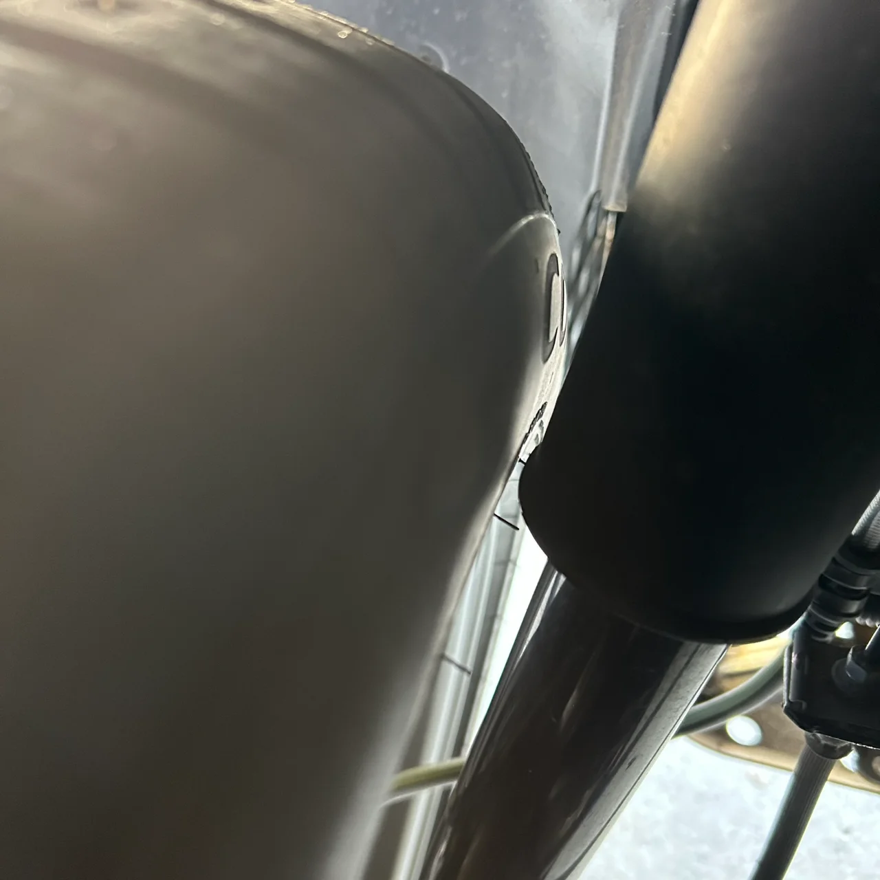

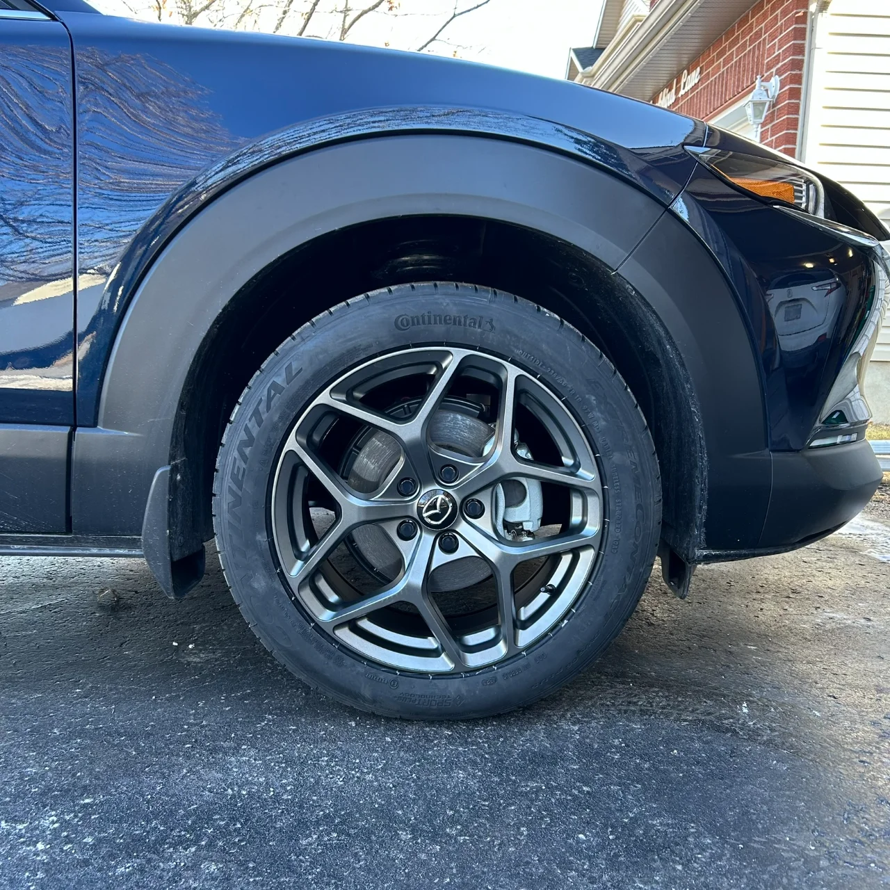

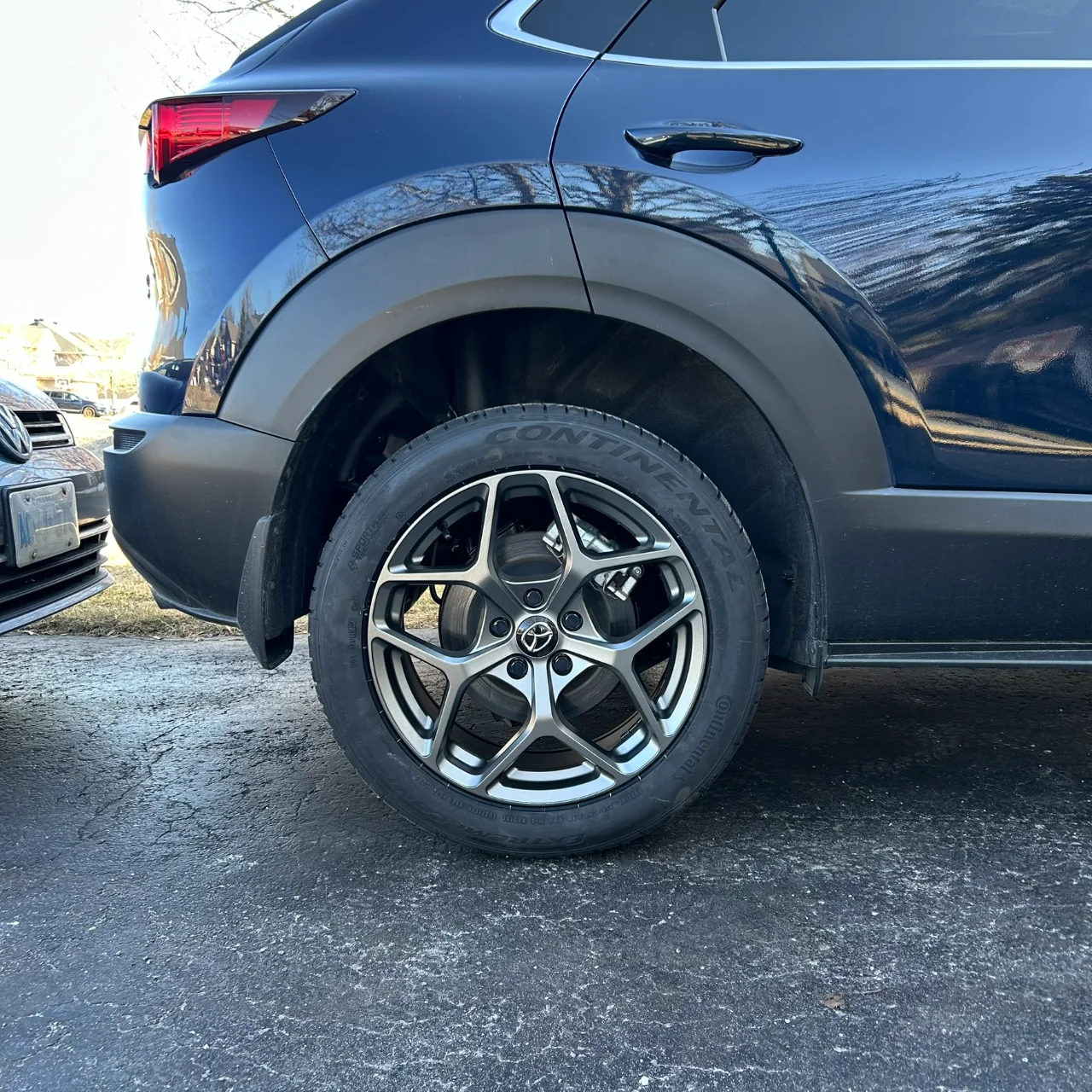

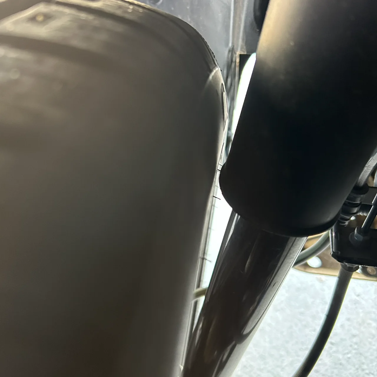

It fits! Confirming that 18x8 ET+45 wheels with 235/50-18 does fit on the CX-30. The tires are close to the struts on the rear, but there is no rubbing.
It looks great I love that style I wheel. It's a abs strut dust cover attached to a mount built into the upper plate. You're main concern will be if you ever have a flat it may or may not scrub that plastic. It won't touch by removing it, but that exposes the bare shaft to dust and debris more than stock. However you may be able to find and aftermarket bag type dust boot if it's that important to you.
Personally I wouldn't be bothered by this at all (grain of salt). Good job on the wheel choice 💪🏽
