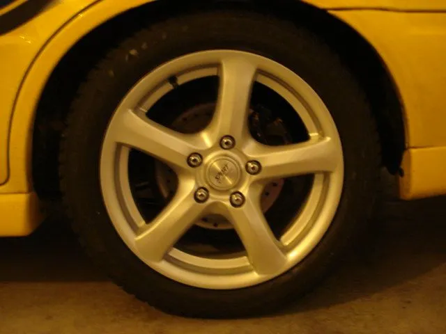

I bought some 16" wheels and installed them today.
