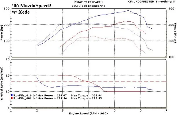

According to BEGi website, they yielded 66.11 HP and 80.39 FT-LBS just from adding the Xede.
So yes, I am expecting similar gains. Am I foolish to expect these gains?
Is there a reason to believe this is a false claim?

I'd go with Nutari's dyno as a better indicator, since I'm pretty sure the BEGI results are with the airbox completely open:
http://www.mazdas247.com/forum/showpost.php?p=2958543&postcount=3
Like I said, CPE is saying 30-35, Nutari's was about 35. Maybe your's will be higher than Nutari's if you're in a less humid place than Hawaii.
You're not really expecting to get a 50-70 whp with just an ECU mod, are you? I'm pretty sure Stephanie said that 288 whp dyno was done with a completely open airbox (not even the filter), whereas the stock dyno had airbox lid closed.
Air filter was installed. I have seen 80+ hp gains with an Xede only on a BMW. It can be done.
Stephanie
