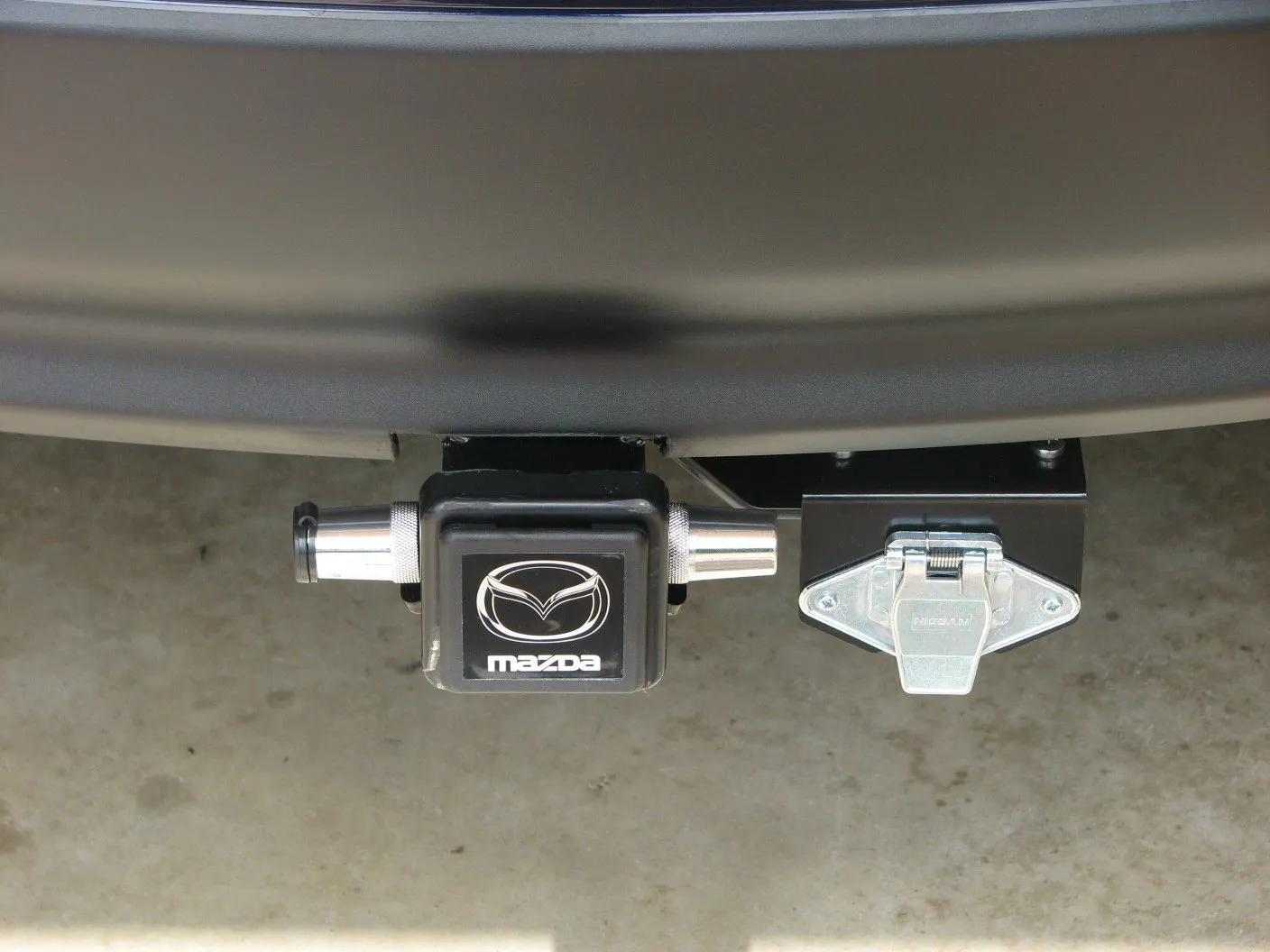

You would have had to cut out the rear apron, but it is marked on the inside for that.

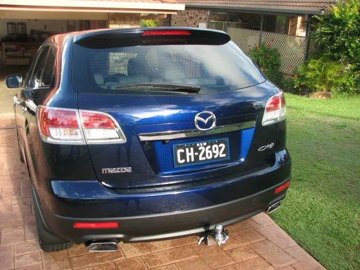

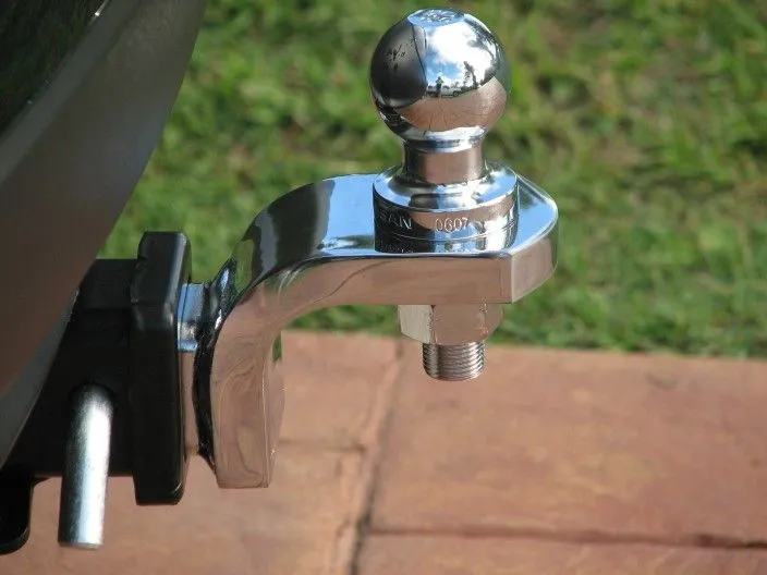

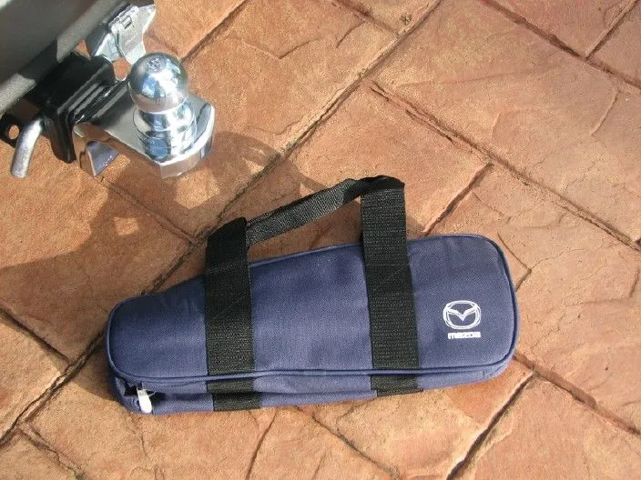

Here in Oz, with our standard Mazda towbar the CX9 is rated to pull 2000kg, which to my memory is 4400lb?(correct me if I'm wrong).
It does have a small cut out in the bumper, but still looks neat IMO.
