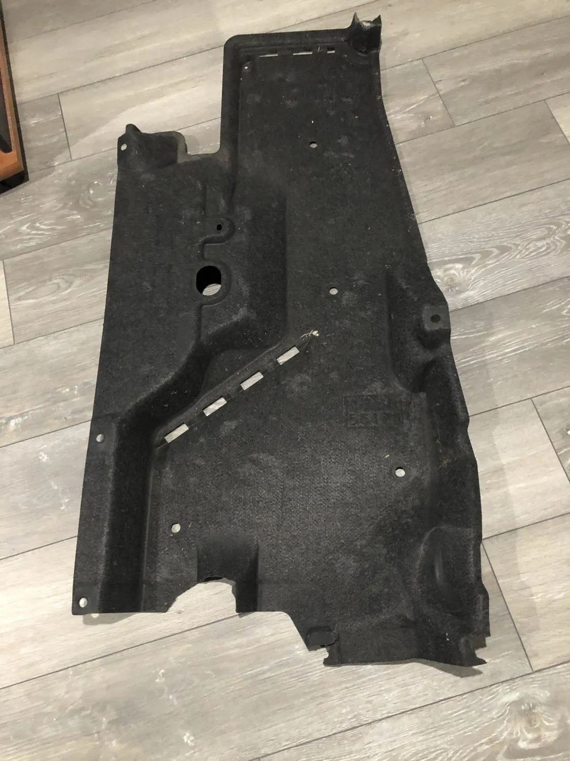

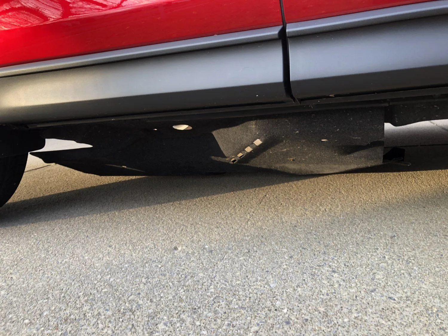

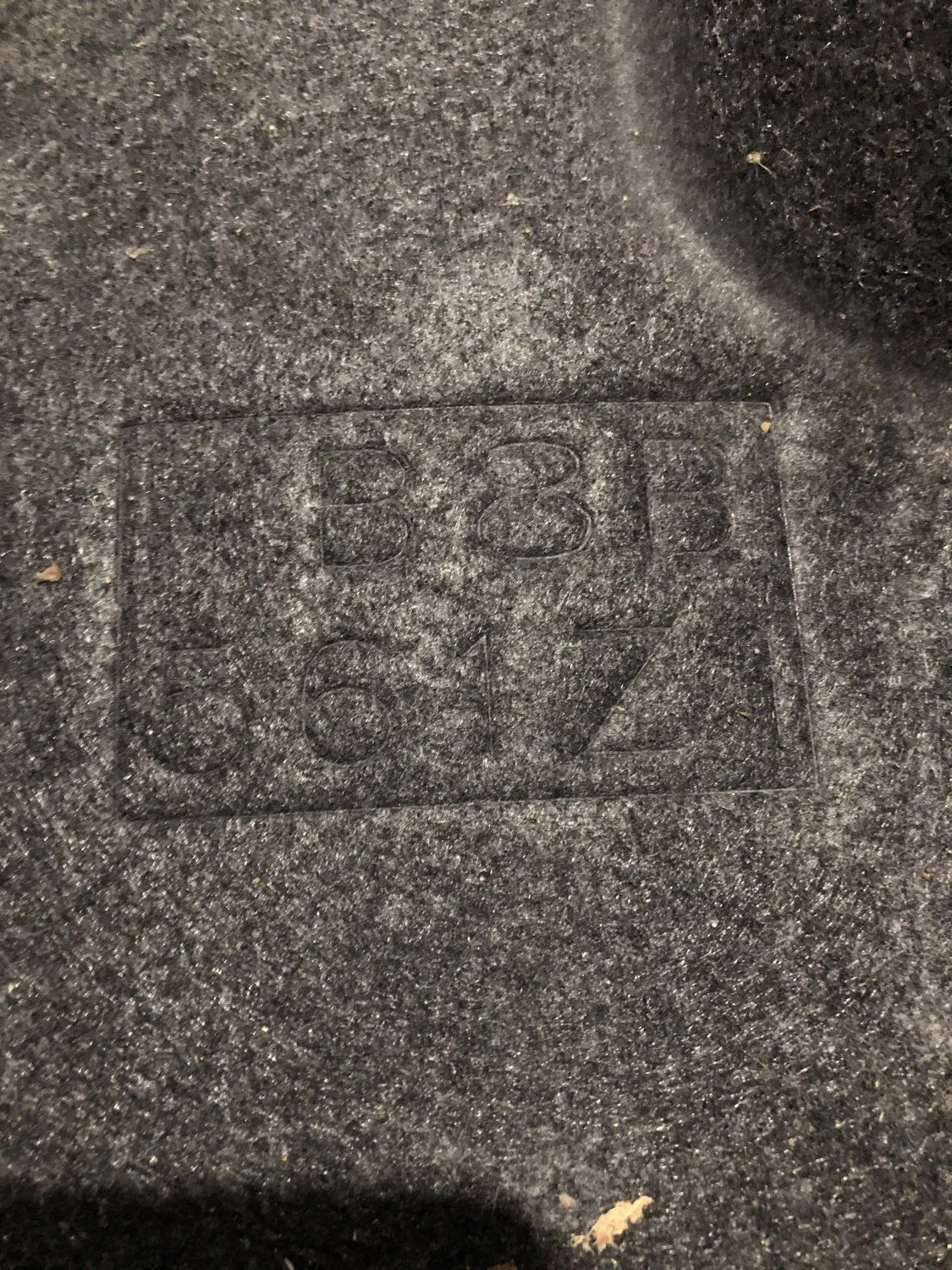

Where can I buy a replacement for this piece. It’s the bottom piece under the rear passenger door area. It ripped off going through a puddle. The part number dosen't come up with anything. It’s a 2020 cx5 gt, thanks.

It’s hard to tell which piece of the cover underneath your chassis from your pictures. Is it made of some sort of soft, cardboard like material used all over the under-body? Can you tell if any part of your piece is torn? Or is it just a whole piece fallen? I’d go to a Mazda dealer and ask for help from the parts guy to identify the part number, and they can order one for you if you really need a new piece.

Looking at the picture, you can probably fix the ends were the push pins hold it. I would try making washers out of aluminum flashing, make a bunch of little holes in the metal for glue to grab and use shoe goo to glue them on the bottom, where the flat of the push pins hold them. The one big tear would need some excess metal and bending it up to match. But I take no responsibility for it getting messed up :)
