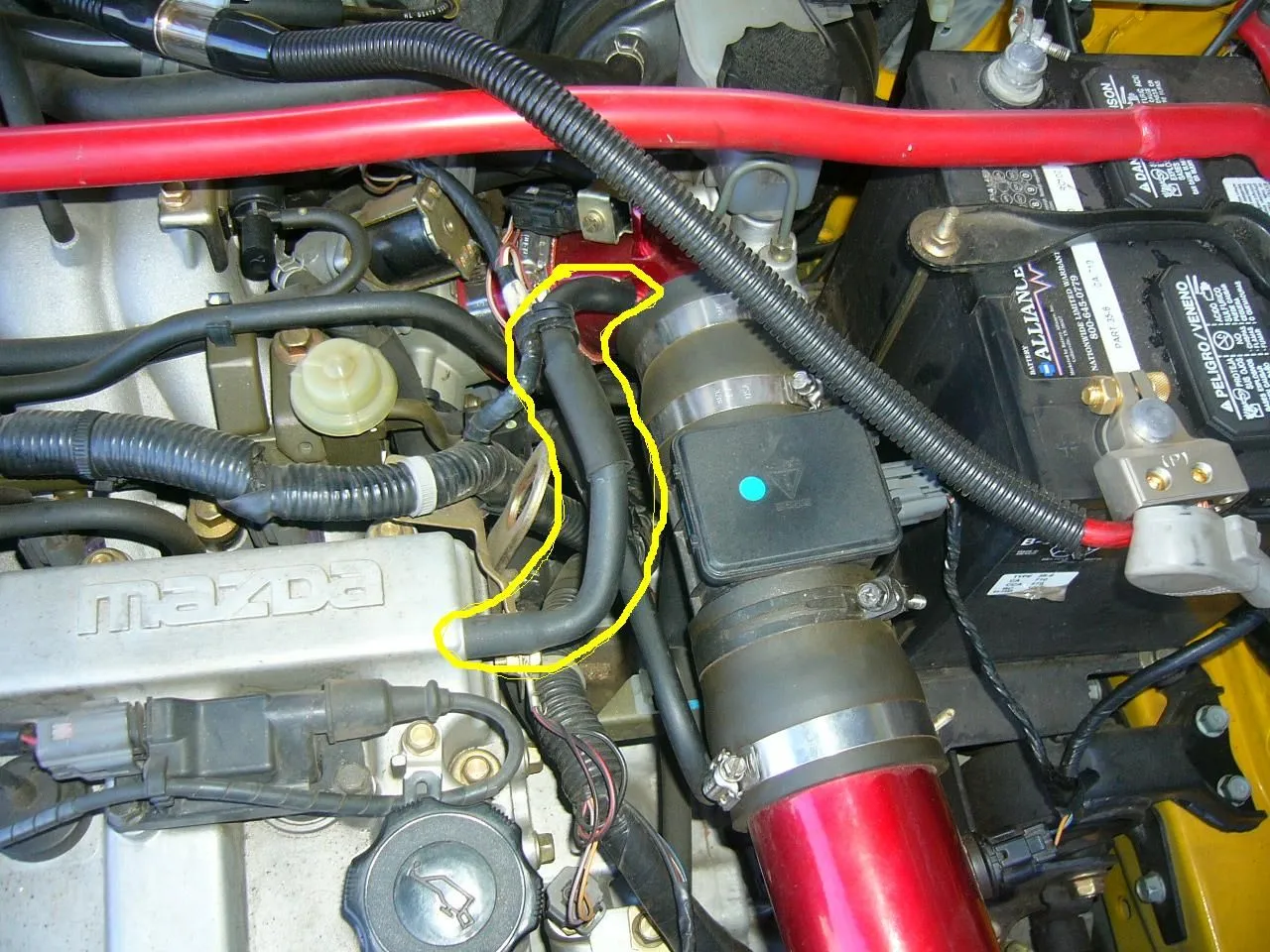

What's the purpose of this vacuum line and does it need to be plugged up the same way when I run my hardpipes when I put my turbo on? Thanks.

It's the positive crankcase ventilation (PCV) system hose.
bumpin_p5 said:
so if I leave that in the intercooler pipe it will be ok.
i wouldn't put it on a pressure pipe, i would run it to the intake pipe.
Doh...you're right. Bonehead thought on my behalf, heh.
